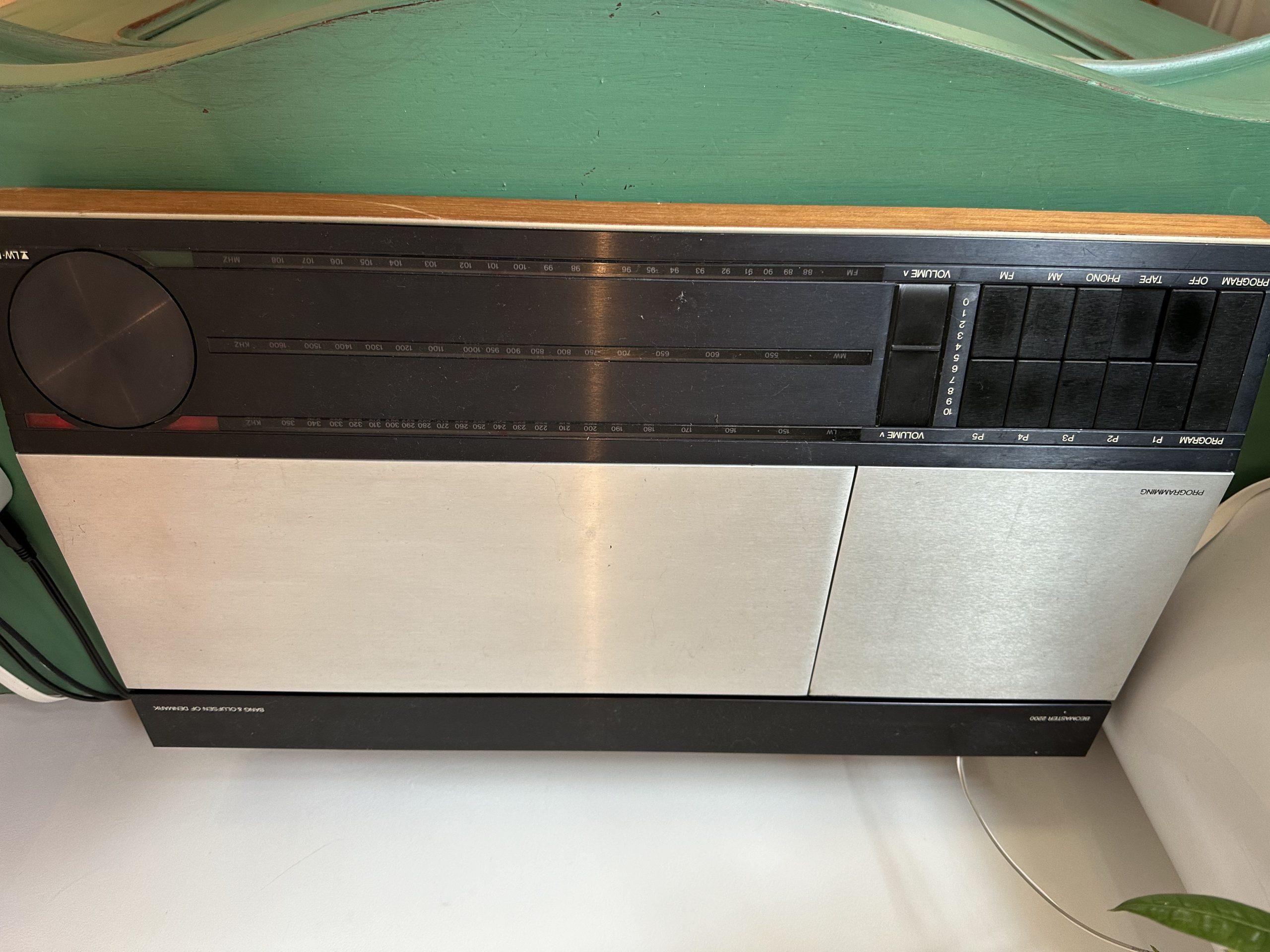

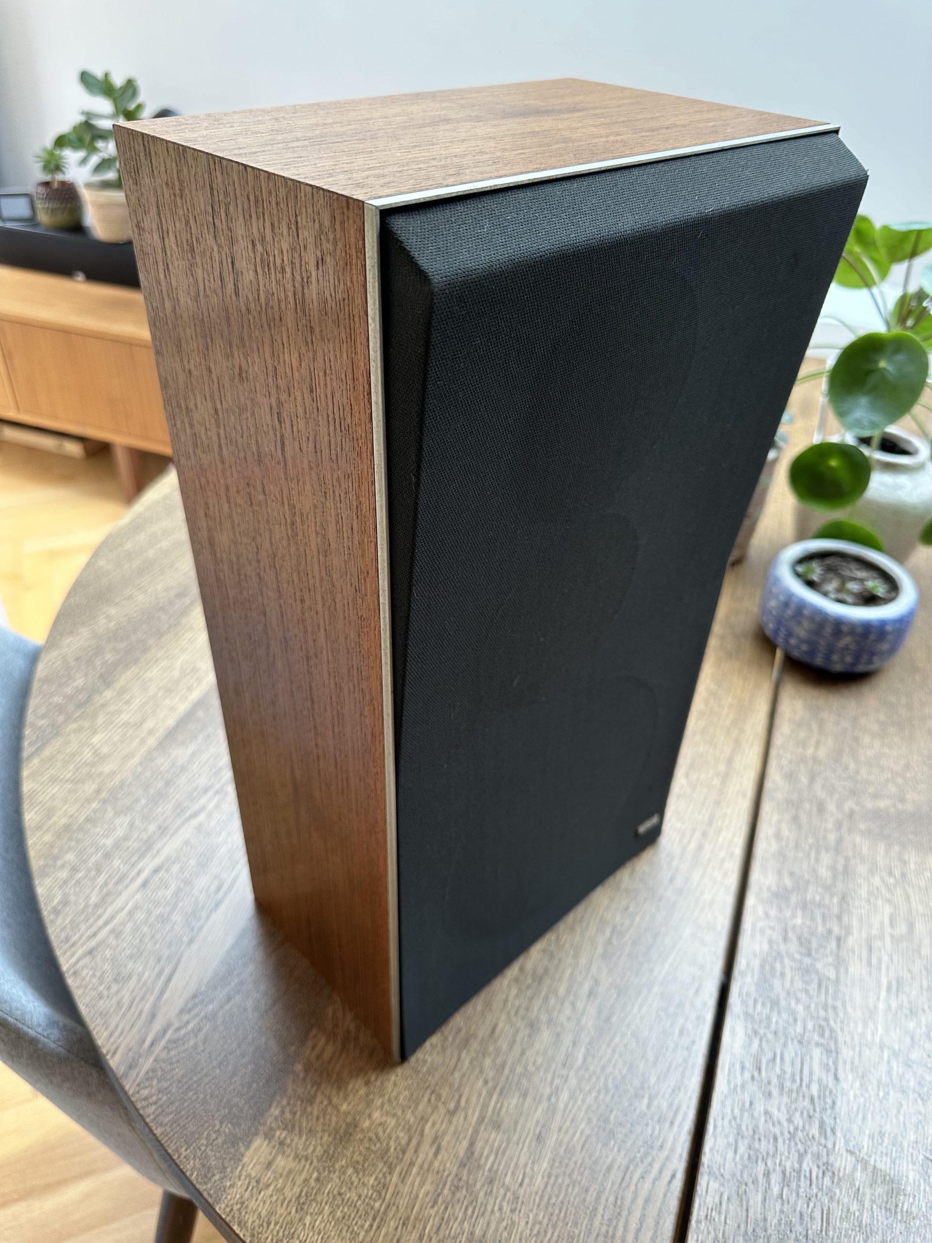

    Thank you, I appreciate the advice!  I would really love to keep it original, especially having got lucky with the Beomaster 2200 – think I’ve caught the B&O bug.
    So I’ve tested continuity and it seems like one is good, one is not! Which probably doesn’t get me far.  I agree it seems unlikely to find many of the drivers on their own – most likely if there’s a non-working S45 out there, this is what might have gone wrong….!  I did find the thread you mean I think, looks like a satisfying process.
    There is part of me thinking ultimately I may have to find a suitable alternative driver, but not given up yet. Is there any way to find out the TS parameters of the original driver itself?
    I’ve put a few photos of the speaker for interest..and one of it’s brother too…IMG_0836-scaled
    IMG_0835-scaled
    IMG_0831-scaled
    IMG_0837-scaled
