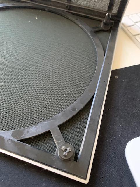

    Hi…..:-) Do you have any advice on how to repair these nobs..
    IMG_0646

    Find a wall plug correct diameter and cut length to size, glue on with good epoxy.             Clean and even base before gluing Untitled 1

    Thanks..But i am looking for a better solution

    Do you have the broken off pieces?

    I made copy pegs in my lathe, leveled the base, the pegs made with bigger “foot” and glued them to the base, will go and look for the speaker in my dungeon, if found I will post a pick

    Rubber or silicone hose might work instead. Using a metal “support” threaded into the frame will improve the odds of a long term fix.
