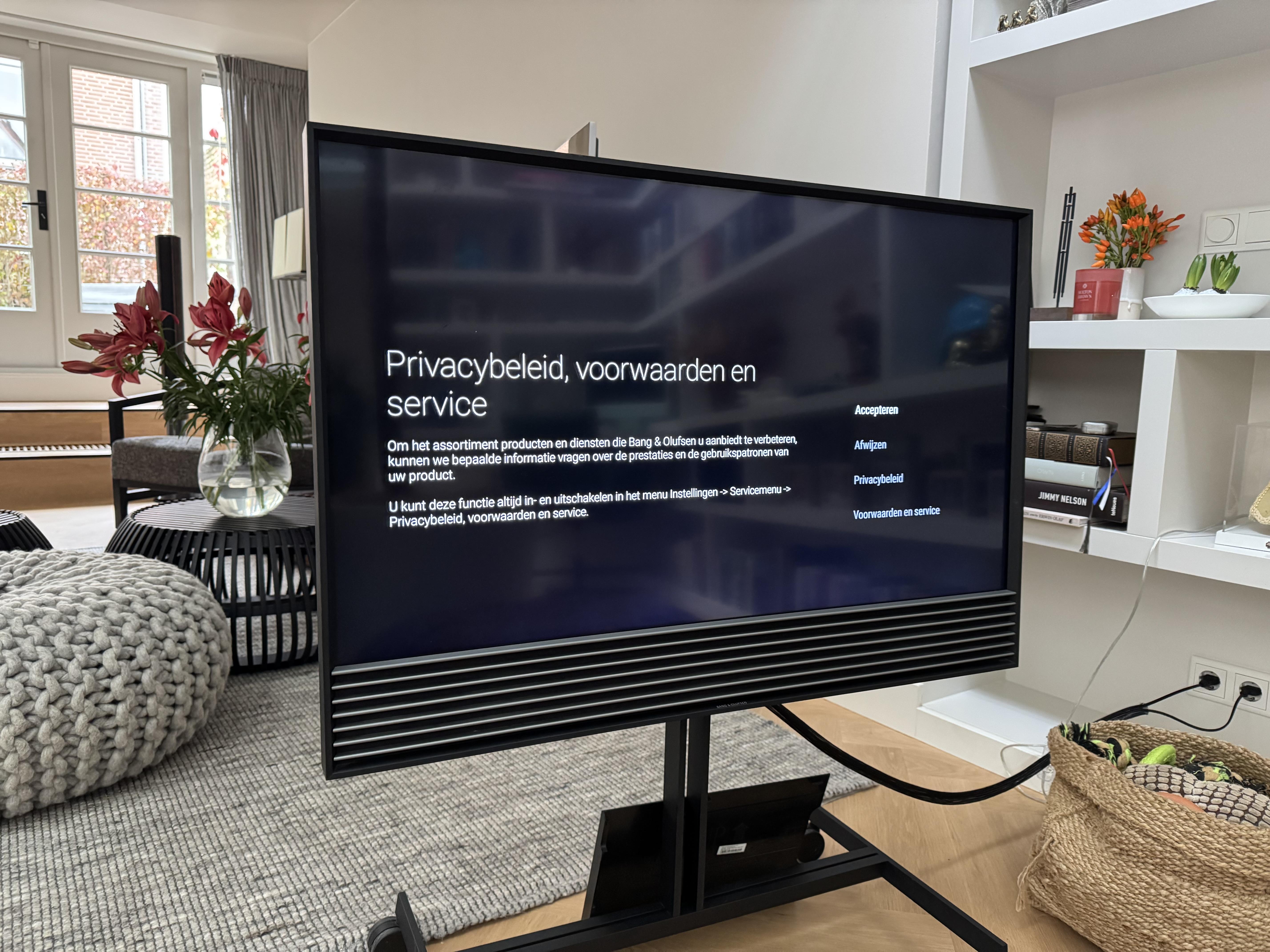

    #61122
    Erwinvdl
    Same problems here with my Beovision Horizon. Hopefully someone has a solution. When starting music with Multiroom it fails because of the notice that keeps coming back
    IMG_6630
    #61137
    vic_20
    I confirm identical behaviour! In an odd way – I feel it is better that it is not just me.
