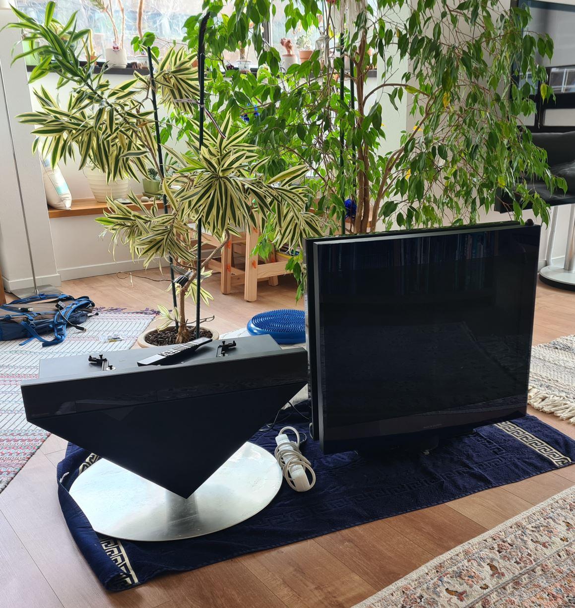

    I bought a Beovision AV9000 that is in excellent condition. The previous seller was a collector and took a lot of care in his units. The TV was professionally dismantle from the VCR/sound part, very well packed and stocked.
    I remove the packaging to test the unit. I download the installation manual but I wanted some feedback in installing the TV on the sound system. Do I need to just “put” it on top of the sound system and use simultanously the 2 levers as I the reference manual ? Are there any guide to be sure to be corretly aligned ?

    I was able to do it almost alone (the bigbosswifey helps me targeting the holes when I was moving the TV). It was heavy but I did it and it fits perfectly. It was a breeze to secure by pushing the 2 handles simultanously.
    The TV is working, at least in got the picture. I am able to play with the menu. I need to plug a console to test it. I notice a buzzing sound that seems to come out of the back of the TV. It stop when I remove the plug. What could it be ?
