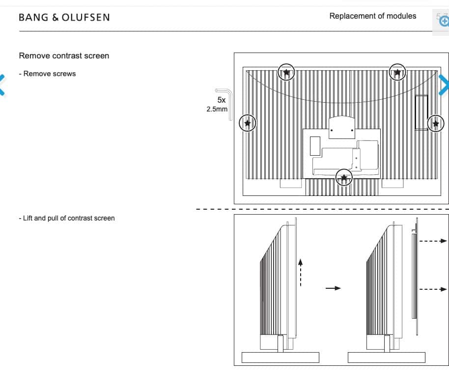

You must be logged in to view attached files.27 July 2026 at 18:33 #124712 TignumGOLD MemberHello Sebastian, that is a bummer!
I found this for the BV 7-40:
Maybe it is the same method as for the 55?To repair you could maybe give it a go with some 2K black epoxy glue, though best is to find a replacement screen.Perhaps you can find a defective 7-55 for little money and repurpose the screen.Regards,JohanLocation: Netherlands

I also hope the 55″ uses the same method.
I’ll have a closer look when I get a chance. For now, I think my best option is probably to find a damaged or faulty BeoVision 7-55 and use the front glass from it.
Thanks as well for the epoxy suggestion. I’ll keep that in mind if I can’t find a replacement screen.
