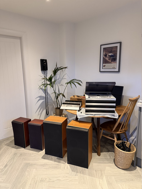

    So, on Saturday I picked up a lovely Beosystem 5000, and the seller also threw in an extra MCP 5000, another Beomaster 5000, a pair of Beovox S75s, and some S45-2 speakers. The whole system is in really nice cosmetic condition and has cleaned up beautifully.
