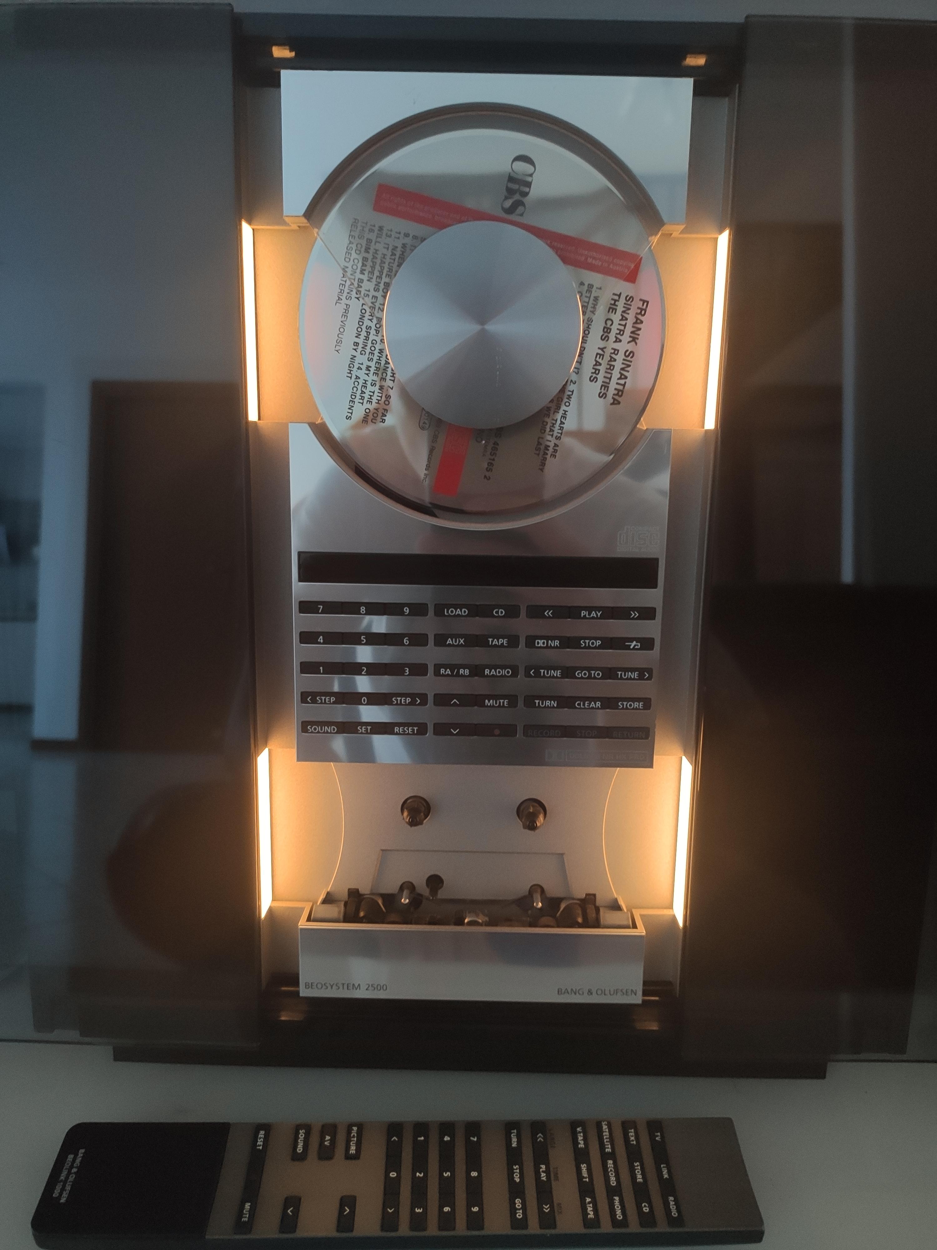

    Hi everyone!
    I have a Beosystem 2500 and as few days ago is not responding anymore to any of the commands. The only way to turn it off is to unplug the power cable.
    When powered-on the lateral lights turn on but the screen remains black, the glass doors are not opening and pressing any of the buttons on the console or on the remote control(beolink 1000) do nothing.
    I disconnected the speakers and unplugged it for a few days, nothing changed.
    Here is a picture (I forced manually the doors to be able to press the buttons):
    beosystem_2500_problem
    Have you ever seen this issue before? Or have any idea what is the cause?
    Thanks!
    #47674
    Die_Bogener
    Yes.
    Dead Lithium cell in the CPU box…
