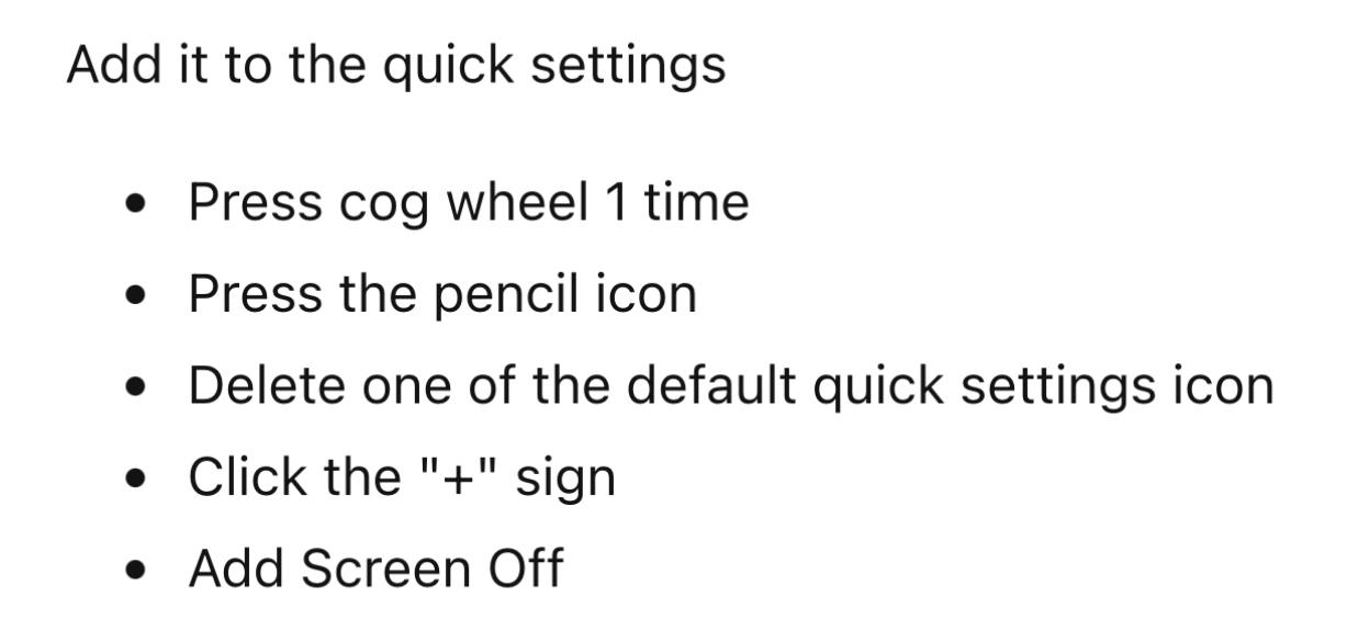

    However one suggestion can be used:
    IMG_0894
    Going into the Settings and doing this should not be a problem with the BROne.

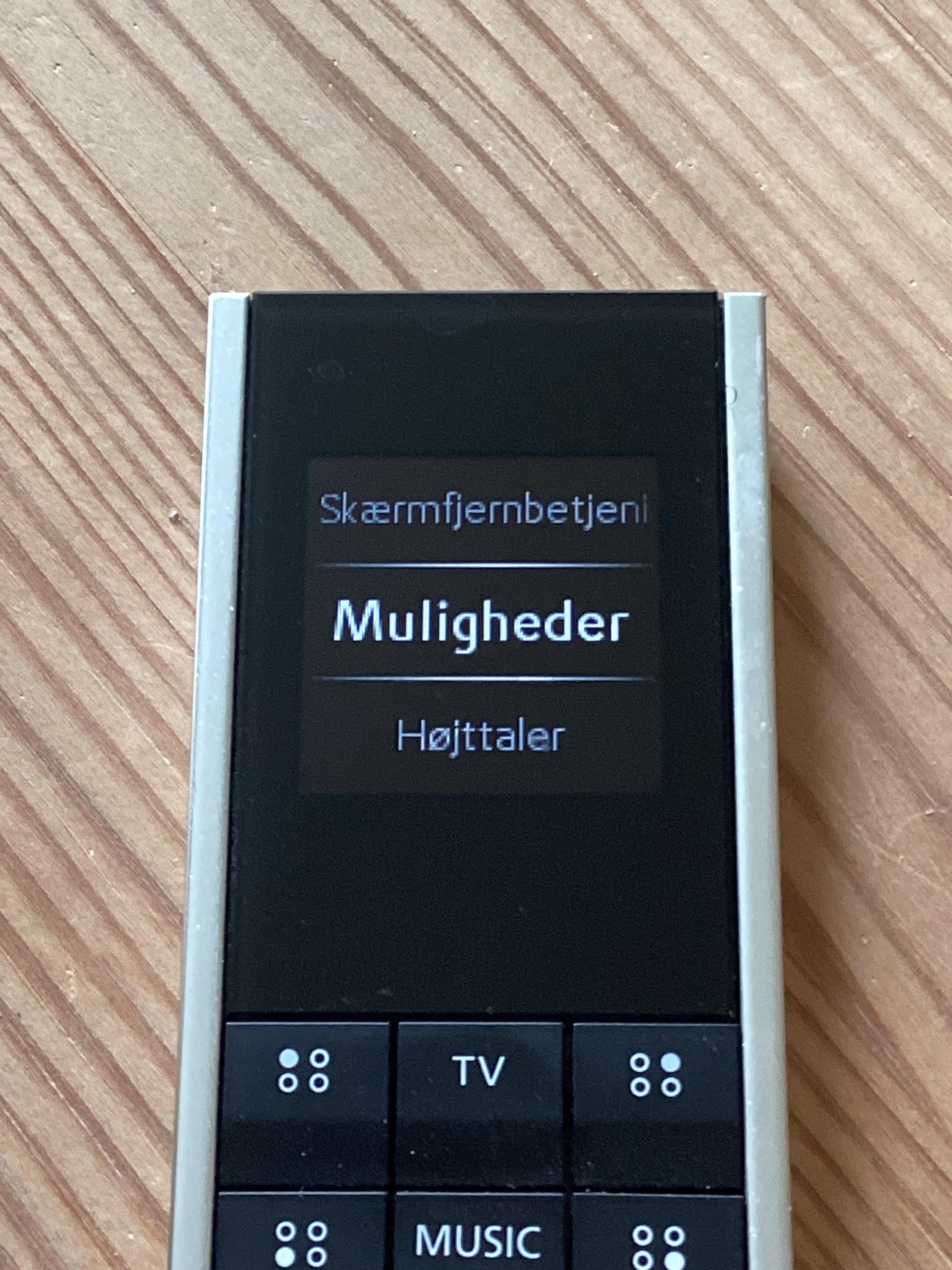

    This means – translated to the BROne – that you must find this entry in the List:
    IMG_0893
    Sorry for the danish language – I am sure you will find it ?

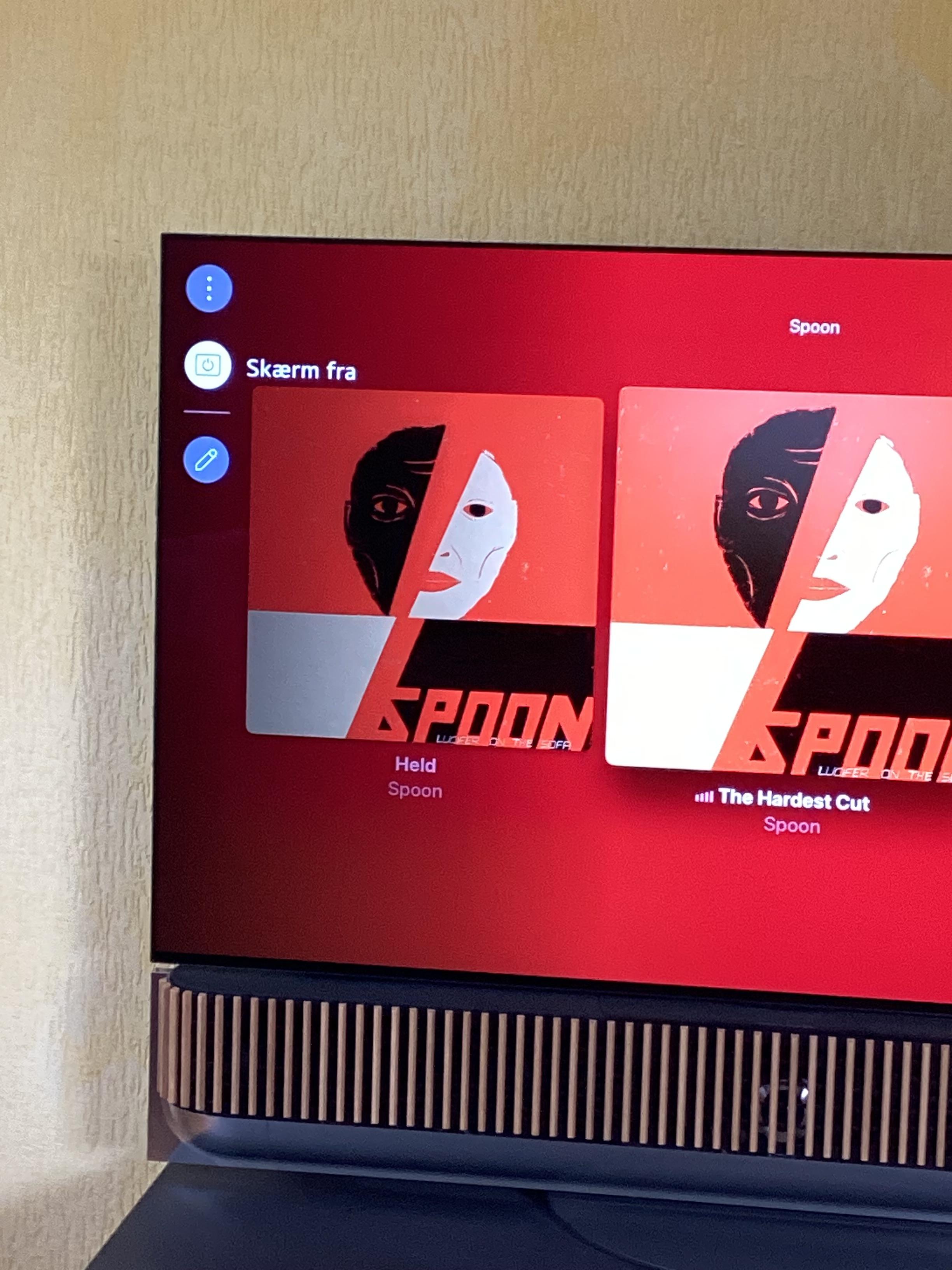

    On the screen it then looks like this (please note, that I have deleted all other  entries there….I do not need those.
    IMG_0891
    Pushing ‘Skærm fra’/Picture off does the job ?
    A couple of actions, yes – but it does the job……untill maybe someday B&O might reintroduce P.Mute again as an entry in the List of the remote.
