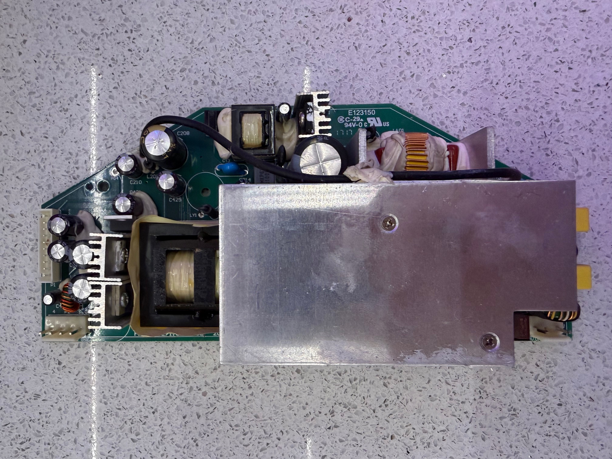

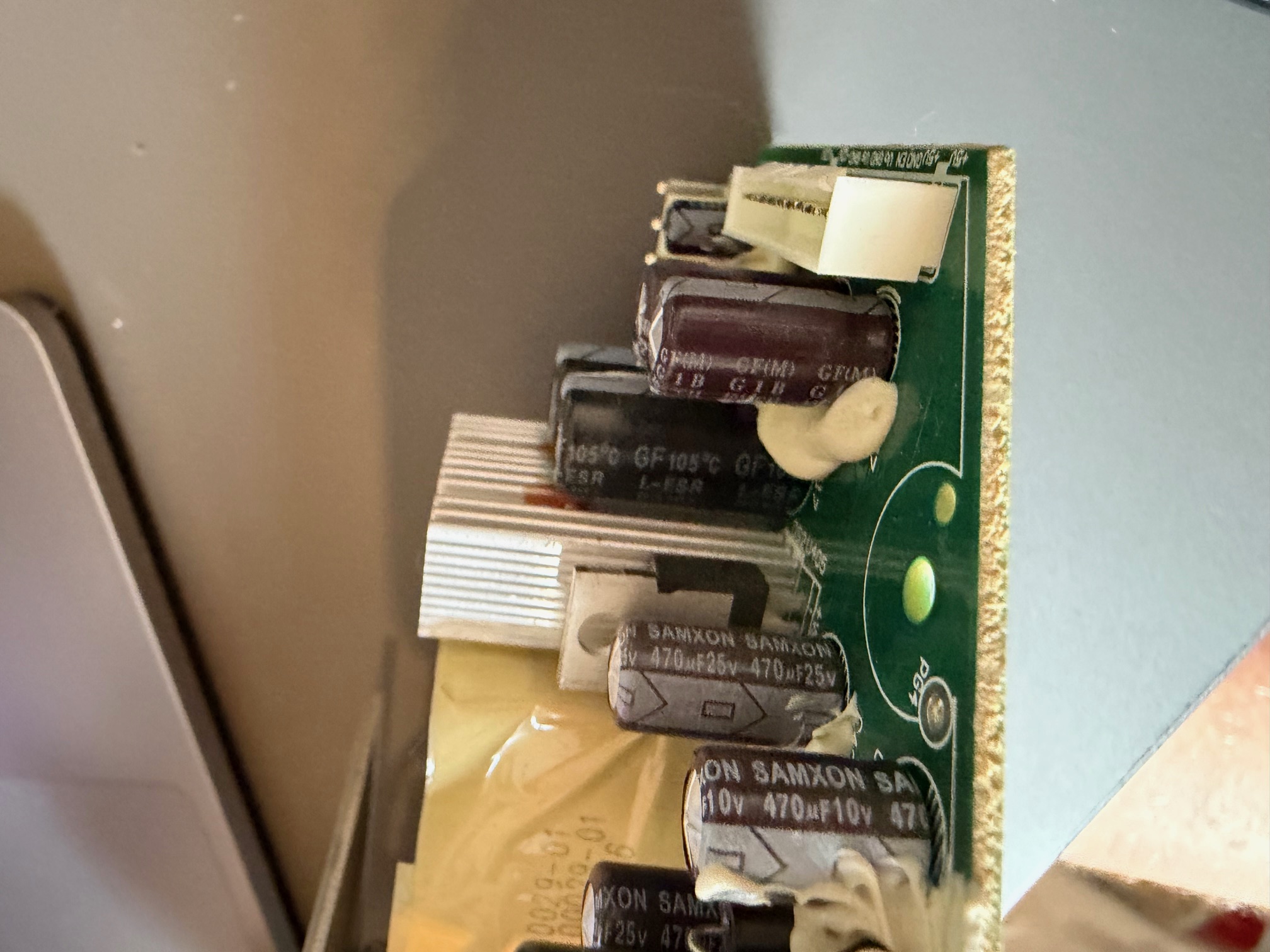

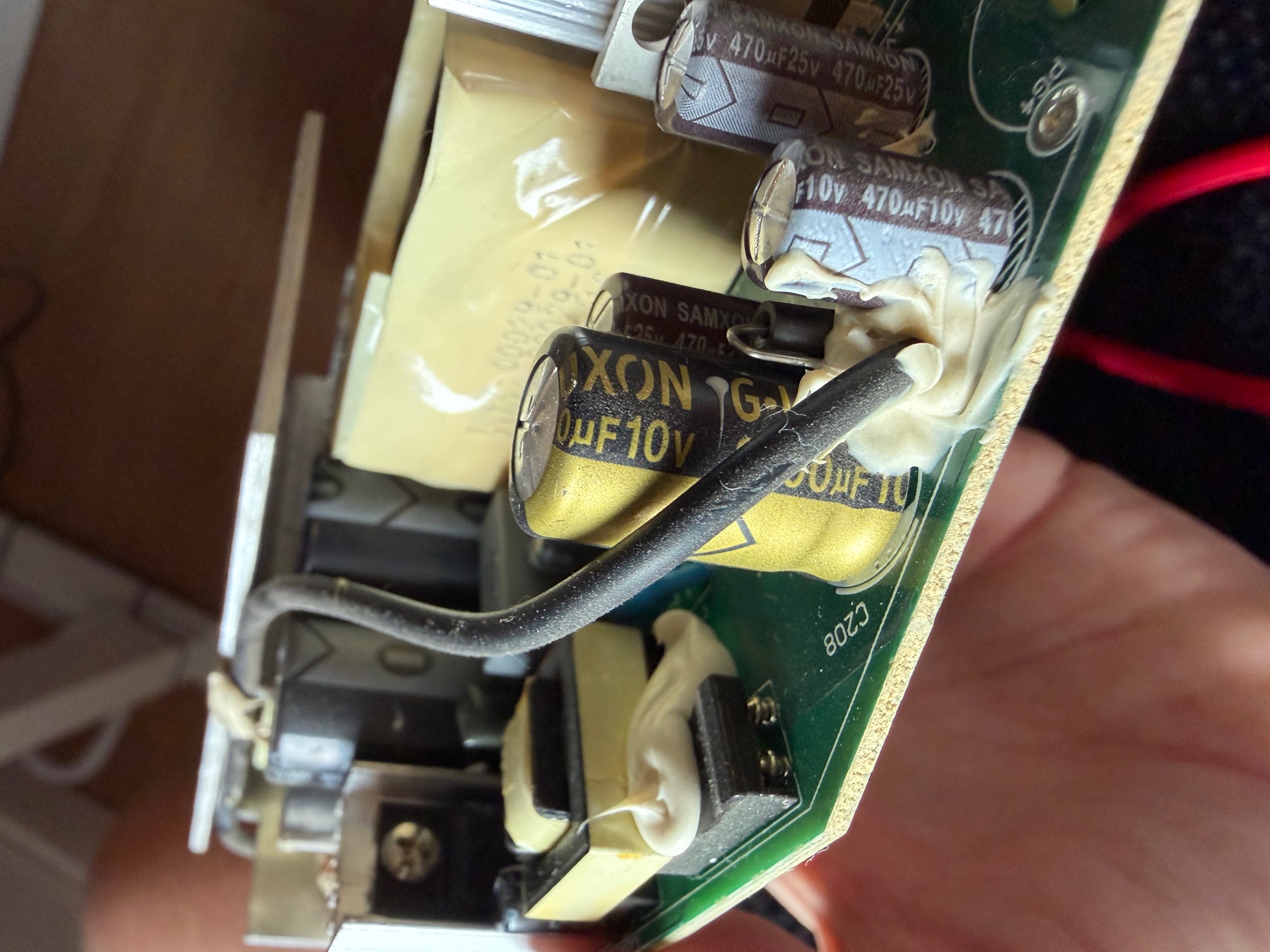

    Several of the capacitors on the internal PSU in the Amplifier Tile were failing, photos attached showing the ‘pregnant’ capacitors.  I friendly local TV/electronics repair guy replaced the capacitors and all is well again!  I guess like most modern electronics, there is a need for stable and clean voltages which the PSU was no longer able to give consistently.

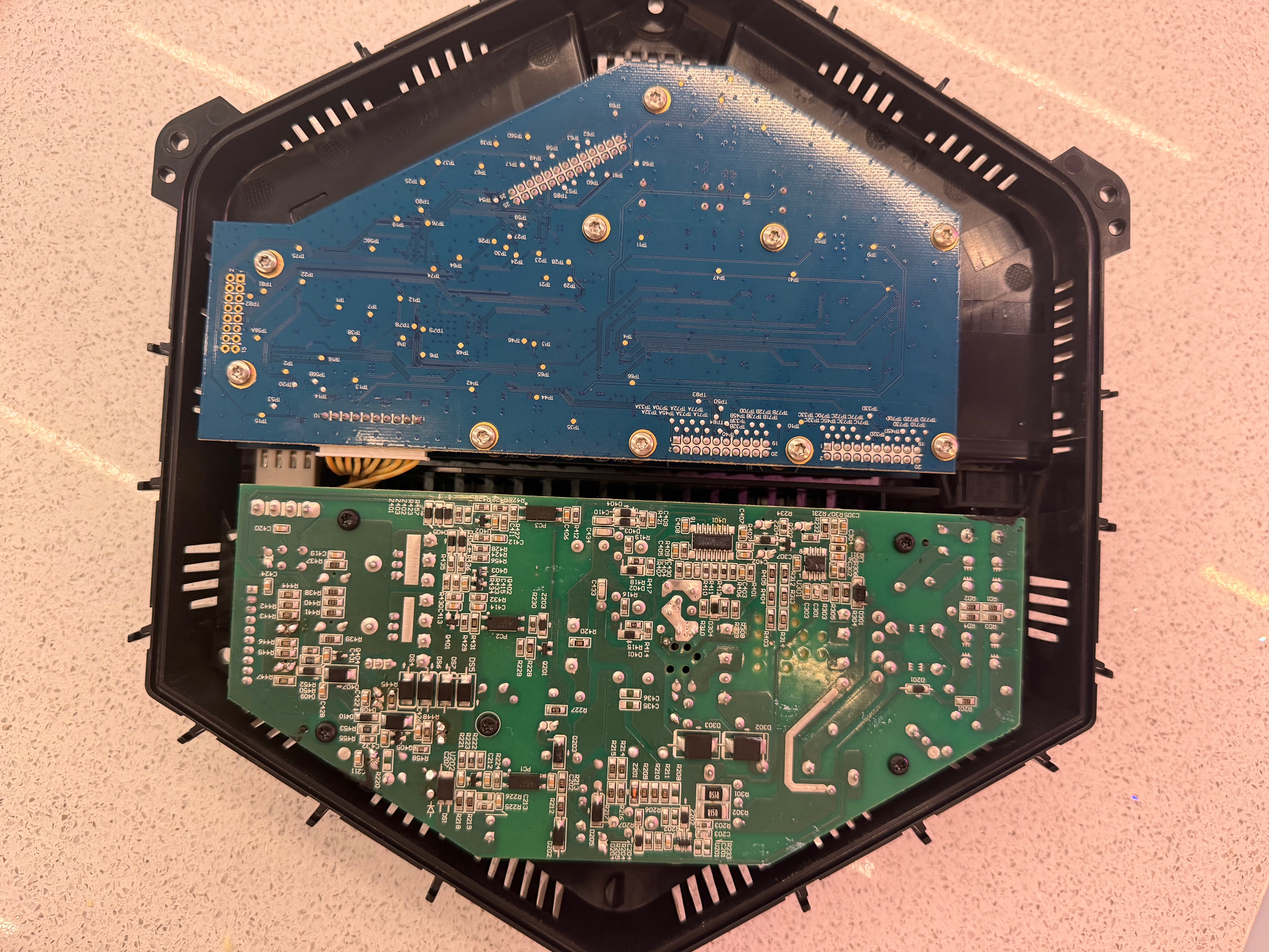

    Internally the PSU (green board) is seperate from the amp/DSP boards (blue boards) so it was easy to take out to send for repair, there are just a few cables to disconnect. Photos attached, again to help anyone else with similar issues.
