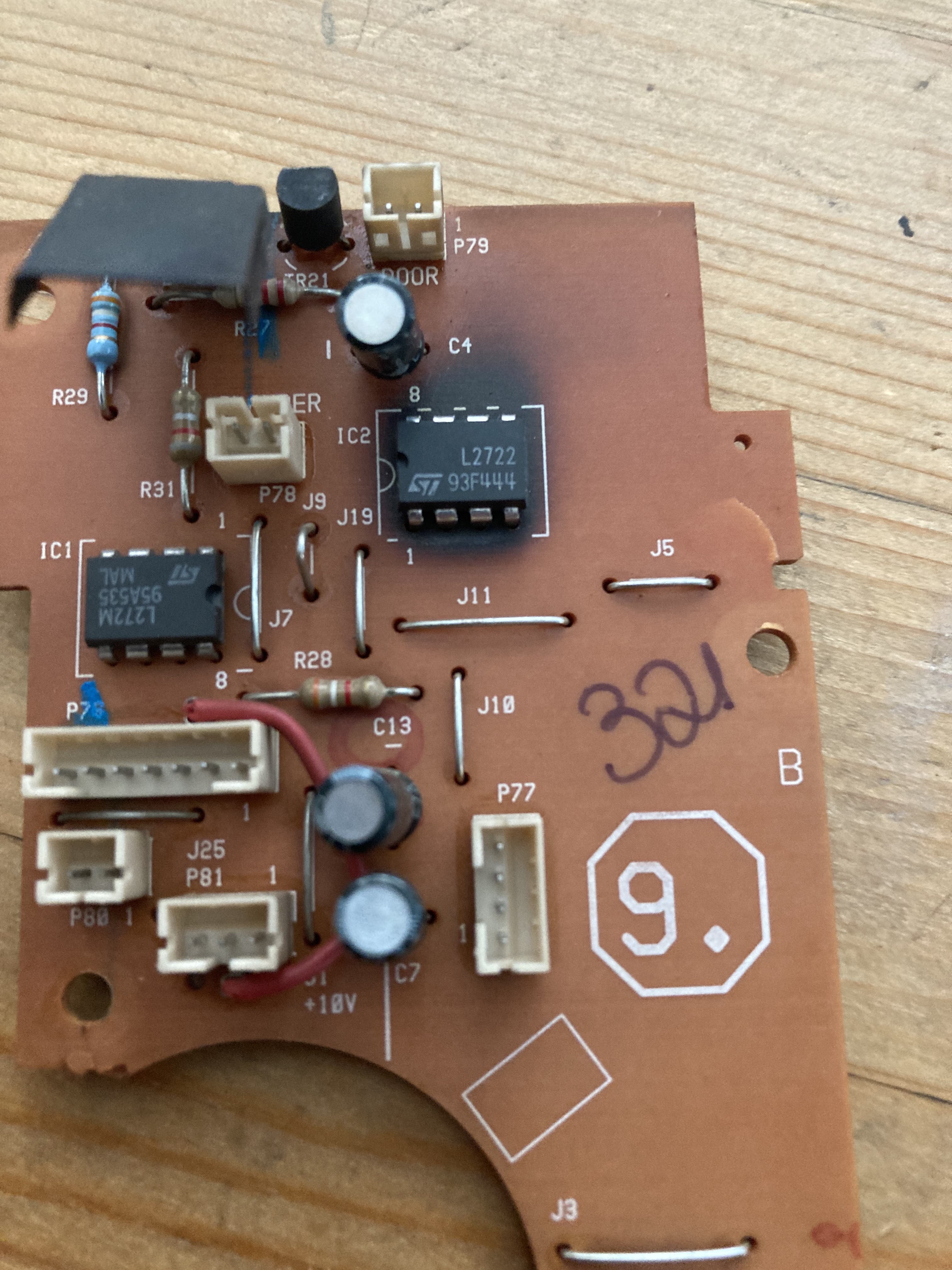

    I’m having a problem with a Beosound Ouverture. I’ve made several of them. This one has a problem: the doors open immediately, but won’t close at all. I’ve removed the glass doors and the side panels. I’ve replaced the door strap with a proper one from Danish sound parts
    They keep sticking open. After 15 seconds, they go into standby mode, but the doors stay open. By turning the weel at the back I can close it until the switch is closed. Moving my hand in front doors open direct and smootly.
    Does anyone have any suggestions for solving this problem? I have searched this forum and the older ones and I can’t find the solution how to fix this.
    Groet, Jan.

    While posting the problem. I suddenly realized after looking at the service manual that PCB9 controls the motor and the doors.
    I replaced PCB9 with one from another Beosound Ouverture (which I still have for parts), and now the doors open and close properly again. L2722 on the old PCB9 was somewhat black and probably burned out.
