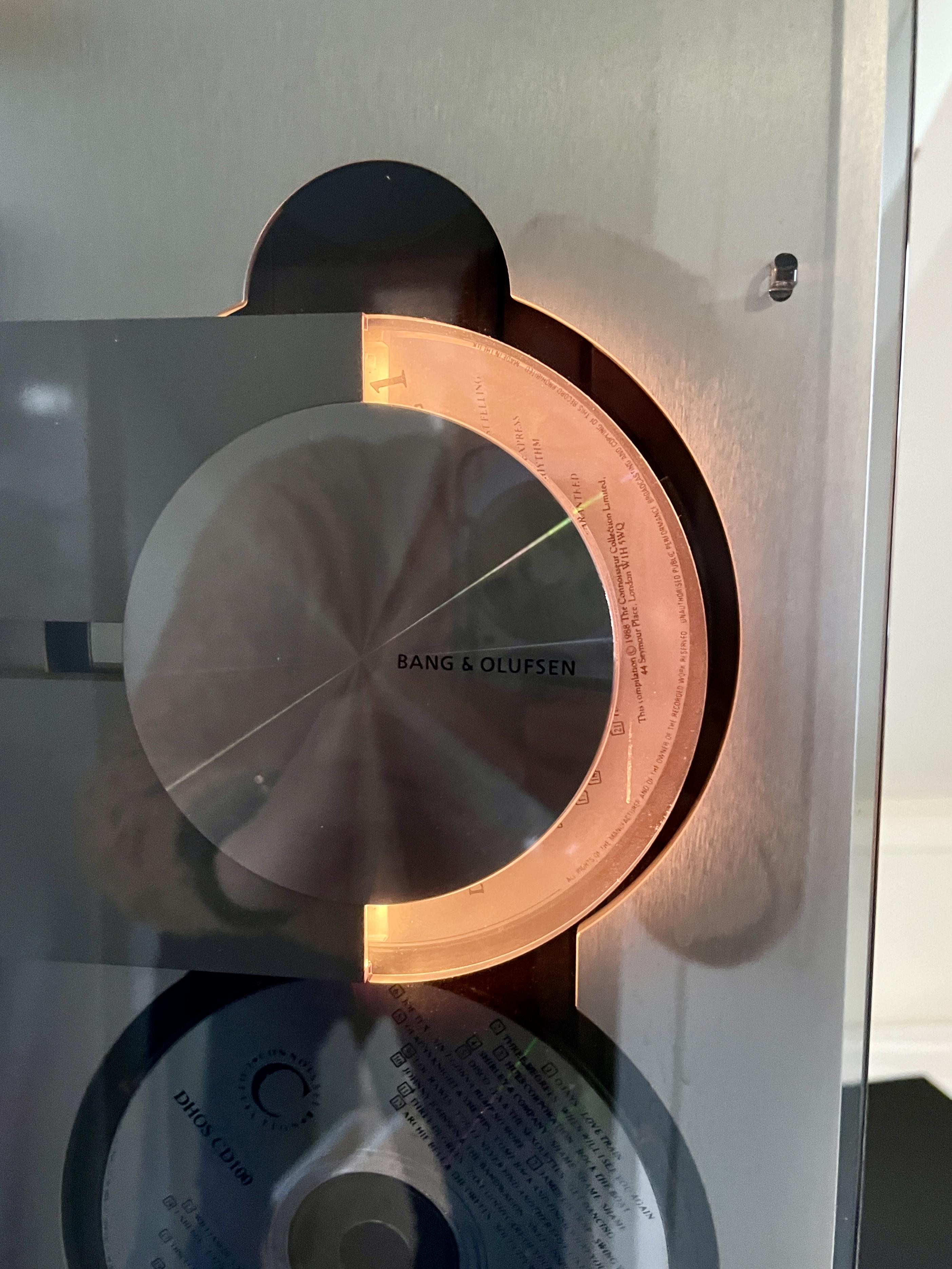

    I have a BeoSound 9000, type 2571/MK III, serial 17xx xxxx.
    The unit is vertically positioned on a floor stand.
    This BS9000 shows some strange behavior, here’s an overview.
    Issues
    1. The CD-sledge moves very slow between CD positions. I think the speed is about the same as when the door is opened (the protection mode to prevent ‘fingers in guillotine’).
    2. When commanded to move from CD1 to any other CD position, the CD-sledge first drops about 3 mm down (see picture below), then waits about 22 sec. before it moves to the selected CD. (It does correctly go to that CD, and starts playing it)
    3. All movements between CD2, 3, 4, 5 and 6 are executed after waiting 10 seconds. In these cases, there is no initial drop movement of a few mm (as from CD1 position).
    4. When moving from one CD-position to another, the display shows the notification ‘Cleaning required’.
