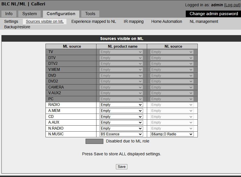

    I have recently added a Beolink Converter NL/ML to control the BS Essence from the Master Link side,
    in particular for skipping step 2 with Webradios, and it works perfectly:
    when I press A.TAPE 2 (see the step 1 above) the Beosound Essence switches on and Webradio (B&O Radio) starts playing and I can switch all the preset channels with B&O remotes arrows up/down.

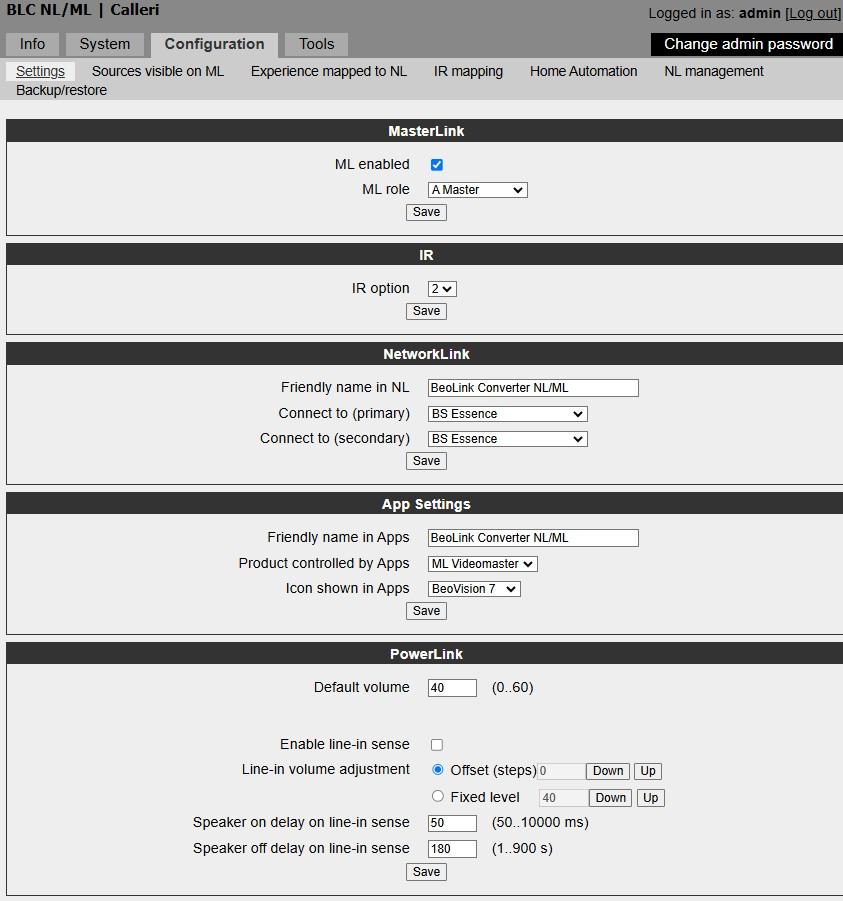

    In this new configuration, the problem starts when I try to play Spotify from my smartphones .
    When BS Essence is playing from Webradio, I can connect Spotify to BS Essence (from any device), the BS Essence starts playing Spotify but after some seconds the entire MasterLink system (NOT the BS Essence … ) switches off  .
    Is there any setting in the configuration of BLC (or in BS Essence) in order to avoid the switching off…??
    At the moment the BLC is set as follows:
    With the system behaving like that, at the moment it’s become impossible to play Spotify.

    there is something very odd in your both pictures of the settings of the BLC (Beolink NL/ML converter).
    1. the first picture says the BLC is set as AMaster
    2. but if it is set as AMaster, you can not get the second picture. These setting option is only available when the BLC is set as VMaster.
    On the ML side there only can be one A.Master and one V.Master. So the BLC can’t be either!
    On the ML side: there can only be one global source (a source of a AMaster or VMaster). So only one N.Music (=A.Tape2), one PHONO (=N.Radio), one CD, etc. so there could be a limitation.
