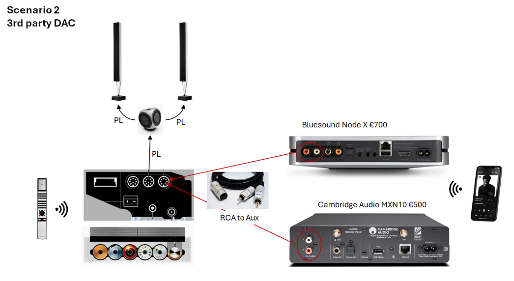

    Scenario 1: DAC to Aux input of Beosound 9000
    Which DAC
    According to various sources the simplest way to connect a streamer to the Beosound 9000 is via the Aux input. That is way I have searched comparison of the analog output of the Beosound Core and Beoconnect Core vs. 3rd party streamers, without any luck.

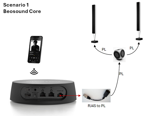

    Scenario 2: DAC between Beosound 9000 and speakers
    Beosound Core or Beoconnect Core - Scenario 2
    Some seem to have put the Beosound / Beoconnect Core between the Beosound 9000 and the speakers. I would find it interesting to know why you would connect them like that. It seems much more complicated and you would have to turn up the volume on the Beosound 9000 each time you turn it on when listening to a network stream. In turn I assume you would not want to set the volume to high by default, because then you would have to turn it down each time you listen to CDs. Any thoughts on this would be appreciated.

    If I did not need multiroom features at all, I would do this:
    1. Wiim Ultra (available now in US, UK, and possibly in Europe), because of its screen
    2. RCA to AUX-IN on the BS9000
    3. PL to BL2
    Then all you need is to disable Bluetooth in the Wiim, and you are all set.  I would not mess with sending digital out from the BS9000 to the Wiim, and then trying to use RCA from the Wiim subwoofer output to the BL2 and RCA to the BL8000s.  I have never ever achieved good results trying to use RCA with B&O powered speakers: I got buzz, I got speakers which took 1/2 hr to turn off after no sound was present, it was all unpleasant.
    Important: why on earth do you have a «?» mark on your BS Core schematic?  Click below.
    https://forum.beoworld.org/wp-content/uploads/sites/3/beoworld_images/58114/uf8fu962ckt3i0v068zuq06zyuc09ghq.png
    #58123
    Erik
    Thank you very much @xavieritzmann for the response.
    Because I haven’t found instructions on how to connect three speakers to the BS Core. Is it the same; PL to BL2 and from there to the BL8000?
    #58150
    XavierItzmann
    e.a. Powerlink (PL) cable contains stereo sound, no matter the physical interface (round DIN or RJ-45 “ethernet”)
    It results therefore that sound coming from one PL outlet on Essence/Core/Converter contains all you need.  If you, like me, need a pigtail to convert from RJ-45 to DIN, it does not matter if the pigtail is one-to-one, or if it bifurcates one-to-two.  If you happen to acquire a bifurcating pigtail use one only, and connect to BL2.
    My ML/NL Converter and Essence both have two PL outs.  I use only one.
