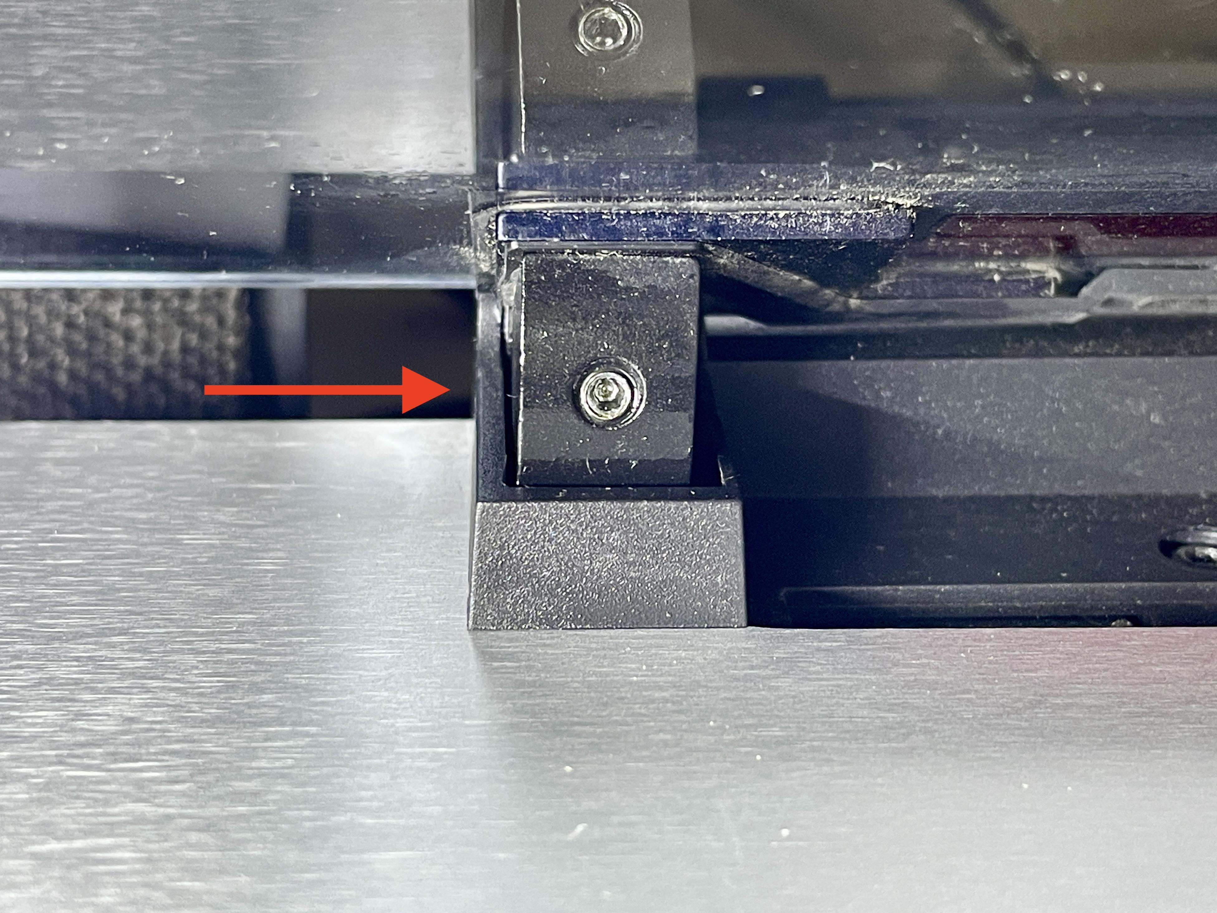

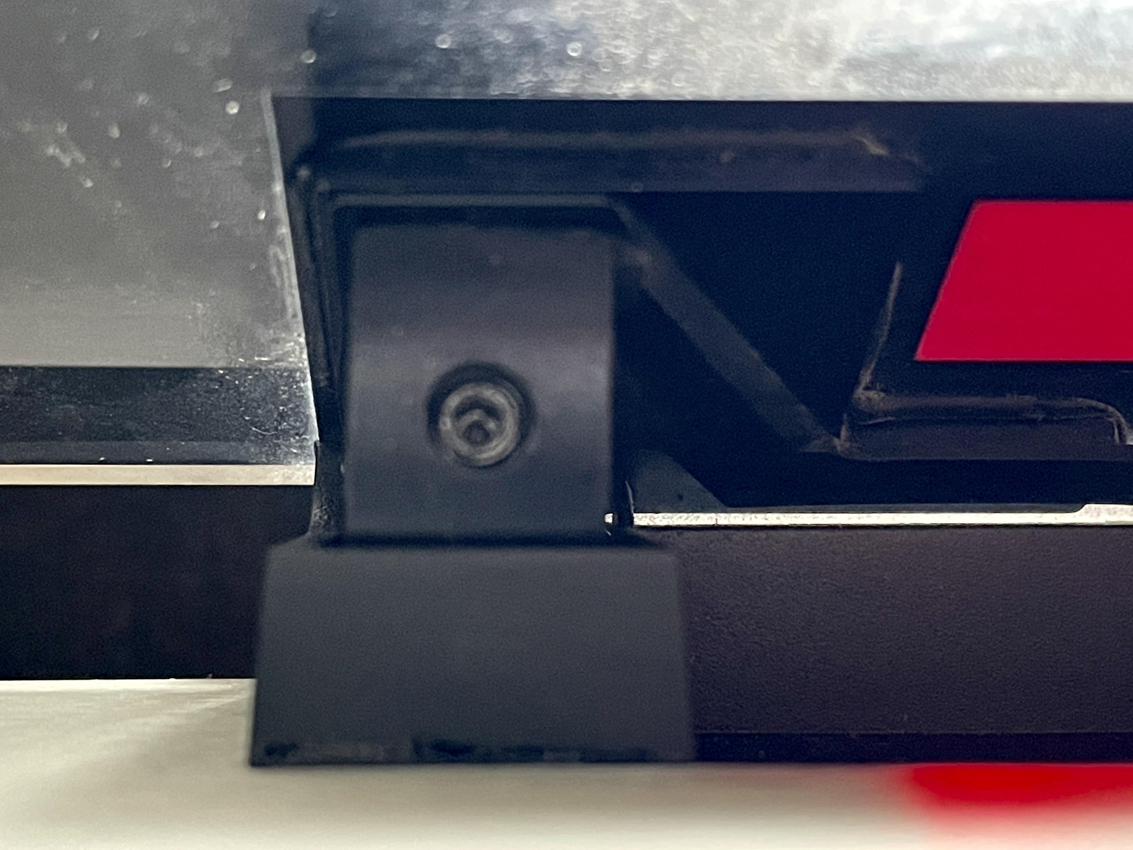

    KolfMAKER
    Thanks @B&O Orlando
    I think you are right about the color. I took another look and compared the Torx screws from both hinges. The right/upper one (the losse one) is certainly black, and the left/lower one looks grey. So like you said, probably not original.
    BeoSound 9000 - Torx Right (black & loose)     BeoSound 9000 - Torx Left (grey & stuck)
    I have let the ‘WD-40 anti corrosion lock lubricant’ do its work overnight, but unfortunately still no movement.
    Hopefully I can get a Torx-8 screw driver with a T-handgrip, to get a bit more force. But like you said, it is tricky.

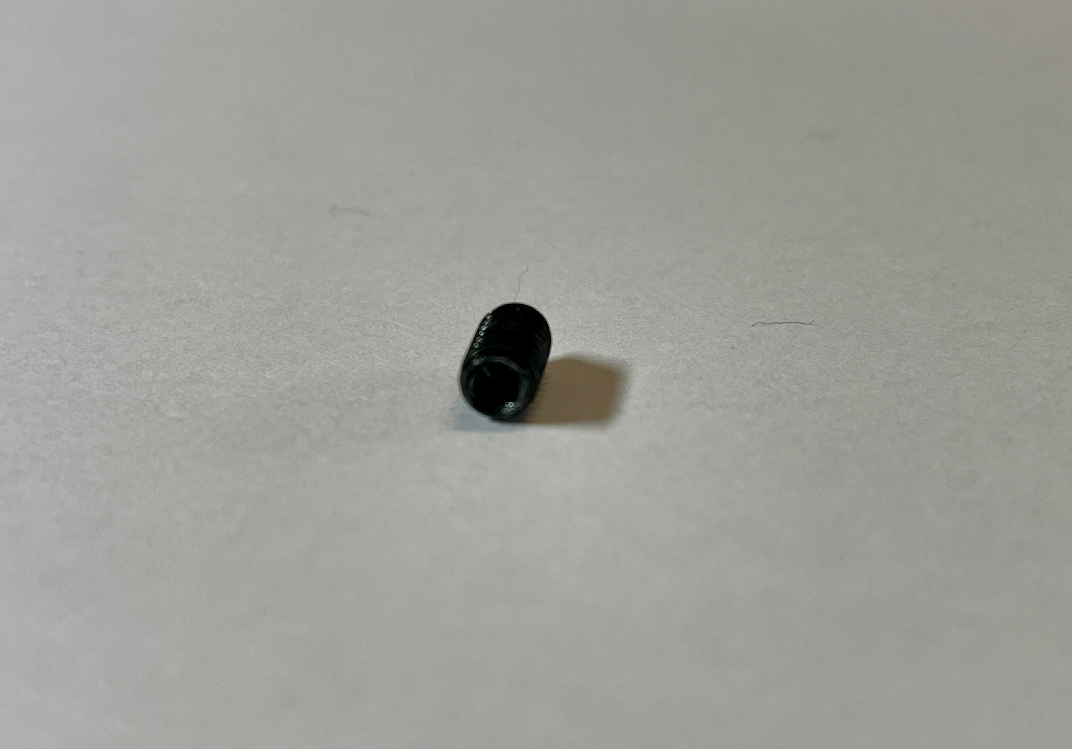

    KolfMAKER
    Dear M.
    Thanks so much for your extensive reply; very helpful suggestions!
    The good news is that I solved getting the hinge screw loosened!
    When taking another and closer look with a magnifier, I got the impression that it wasn’t a Torx screw. So, I just tried an allen key wrench on it, and immediately felt it made a perfect fit with good grip. So, I concluded it wasn’t a Torx screw but an allen key screw.
    It was still very much stuck, but I was able to loosen it that much to get the glass panel out!
    So this part is solved, thanks for all the help and suggestions: @Matador & @B&O Orlando
    By the way, I checked with the owner. He bought the BS9000 brand new, and gad no service or repair on it. So it remains a mystery to have two different screws in the hinges.

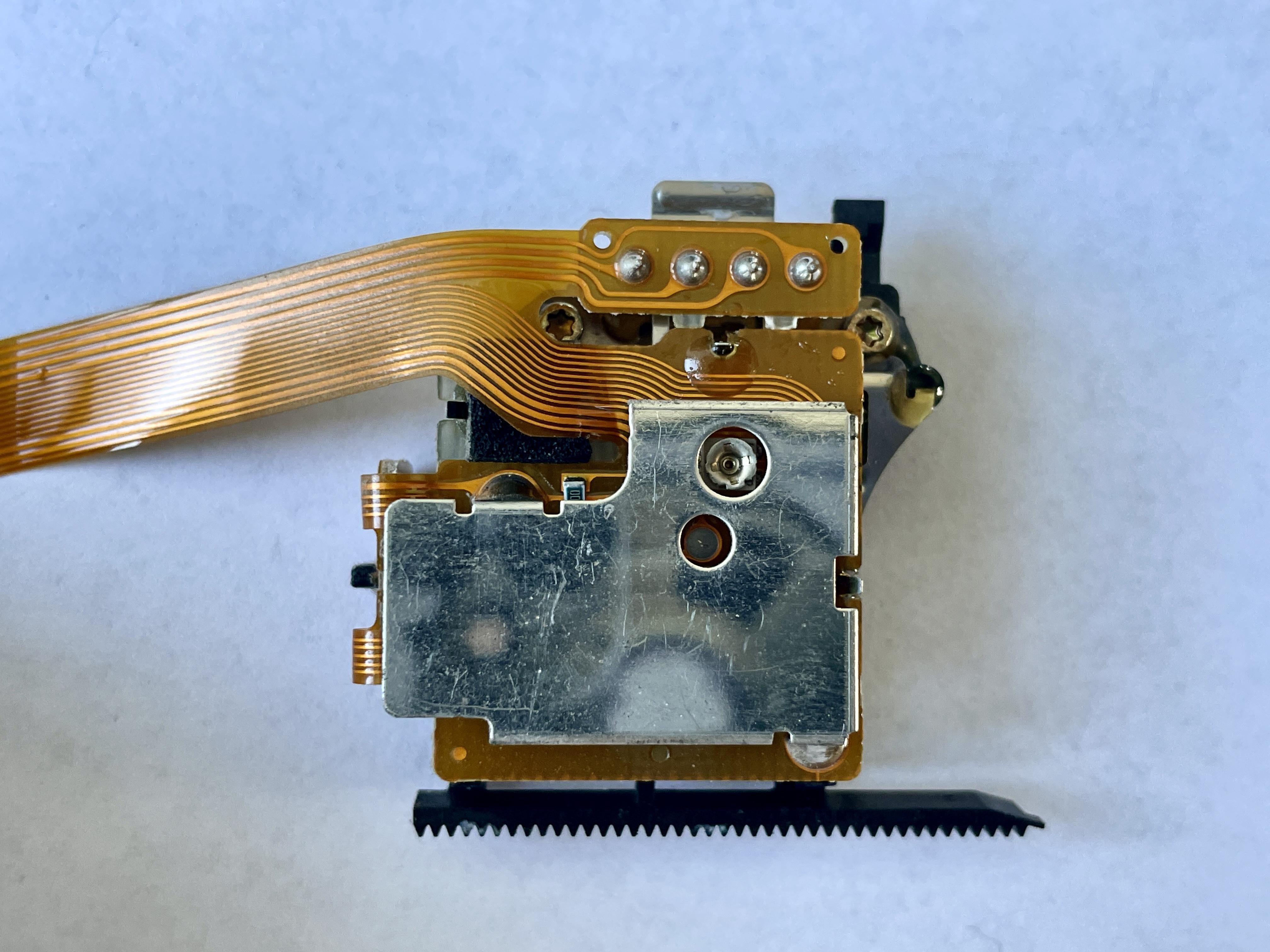

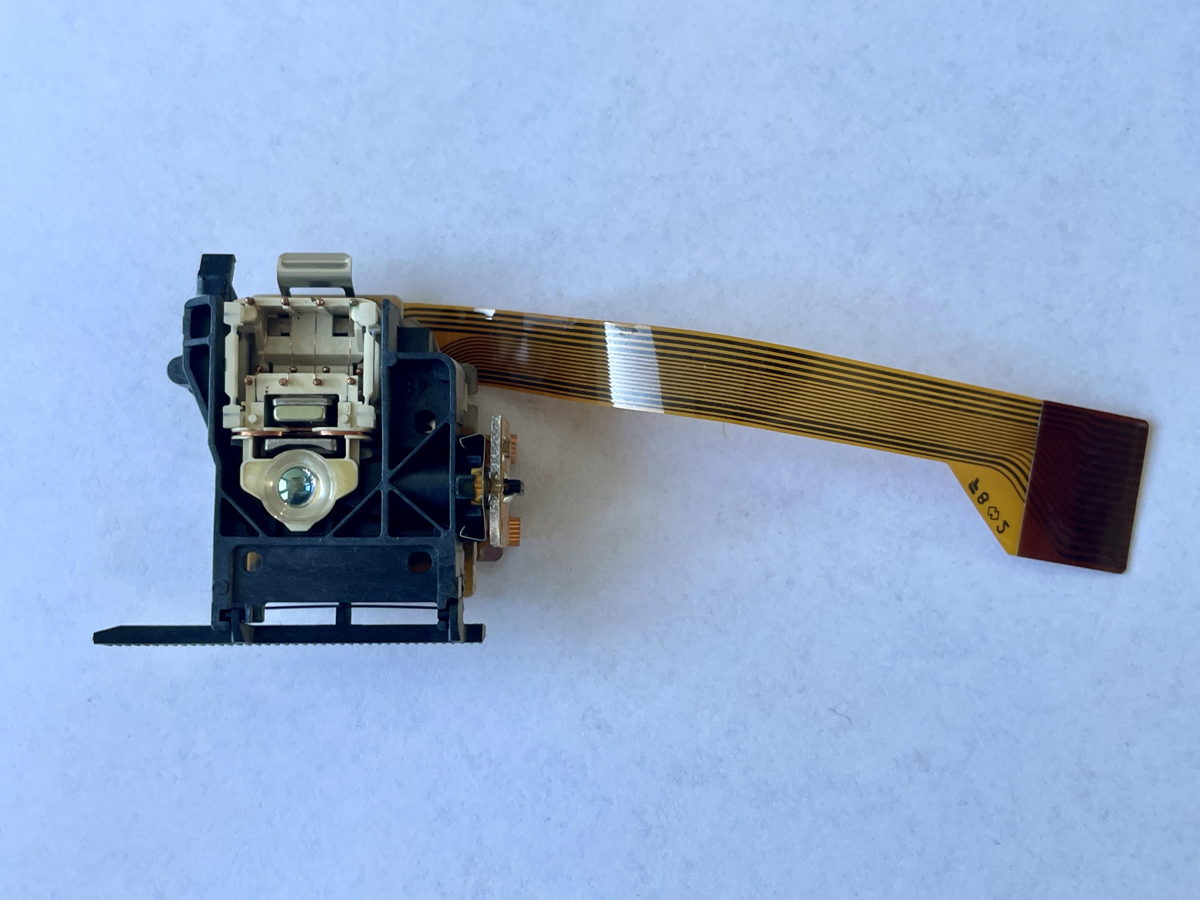

    I did find out in the meantime that the replacement for the BS9000 MKIII, is a VAM1255.
    But also I found out that there are not that many available. Some form the US (too far/long shipping time cost) and some in Europe. In the end I ordered at http://www.DKSoundParts.com. They had the right one and reasonable pricing and shipping cost.
    Curiosity / question
    For getting to the sticker on the CD module. Can you give me some direction what should be disassembled?
    Can you point put with these pictures?
    IMG_6894
    IMG_6895
    Location: The Netherlands
