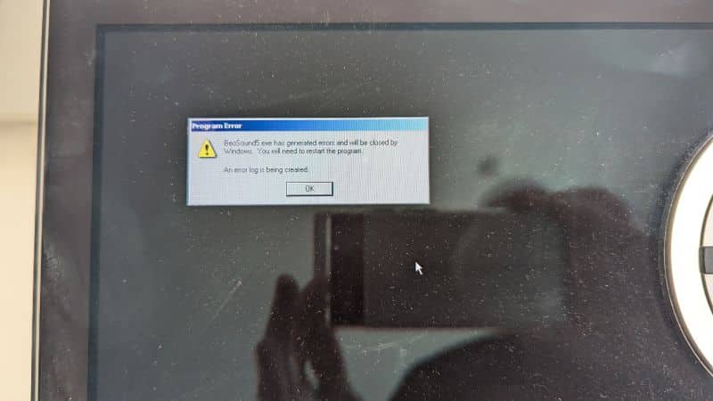

14 July 2025 at 19:50 #67056 CharlieWednesdayGOLD Member15 July 2025 at 02:36 #67109 Severed_hand_of_skywalkerBRONZE MemberThis version of windows is not safe to have on the internet. It will compromise your whole network.
Location: Toronto, Canada
