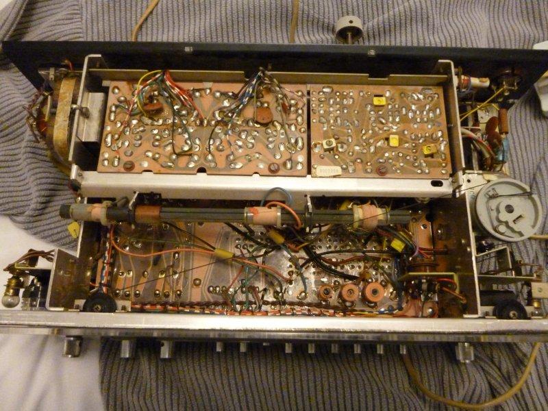

BRONZE MemberWould you show me photo with stereo decoder to check this thing on my beomaster.
Maybe I don’t have this item on radio but why stereo light flashing when I turn on cassette mode? is it normal.
3 November 2023 at 07:31 #50068Dillen
ModeratorThe decoder is the module to the right of the amplifier module in this photo.
It has no visible leads out side this.When Tape or Phono is selected as source, the stereo light should be lit.
If it flashes, it could be because of a bad switch contact or the lamp is not securely fixed in
its socket. Or the lamp itself is on its way out.Martin
