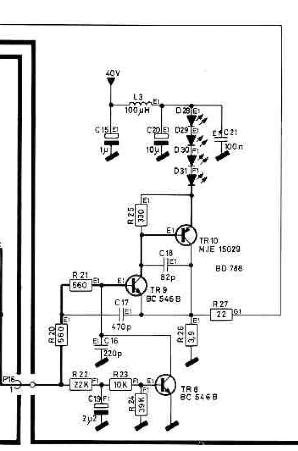

2 October 2025 at 14:32 #70059jacope
GOLD MemberI solved this issue a while back on a Beomaster 4500. Very different setup but the issue was the same: any button press with remote comes out as a buzz through speakers. In my case it was actually the IR transmitter secction causing the buzzing – confirmed by switching to a one-way remote. Perhaps the BM7000 always transmits, even when using a one-way remote. Regardless, I swapped a capacitor in the transmit circuit for a much larger one, and it quieted down the buzz. Perhaps it could be something similar but somewhere in the datalink circuit.
https://forum.beoworld.org/forums/topic/beomaster-4500-ir-noise-buzzing/
2 October 2025 at 15:16 #70061Marto
BRONZE MemberThanks for guidance to this diodes. On Beomaster 7000 it’s 9C20 – 10uf capacitor on the same position like your 5C110. In service manual for 7000 this capacitor is grounded to “signal ground” and maybe this is the case here. I think maybe first to try just to disconnect the minus leed of the capacitor and will try to grounded on the other ground piont with a short wire to see what will be the result. What do you think?
2 October 2025 at 16:50 #70062jacope
GOLD MemberCould be worth a shot, I dont have any feedback as to whether that will work or not. There was an immediate change with replacing the capacitor, and a larger cap produced a more quiet buzz. In my case 470uf took out 90% of the buzz. Your case may be different since its a different model, so you’ll have to tinker with the idea
