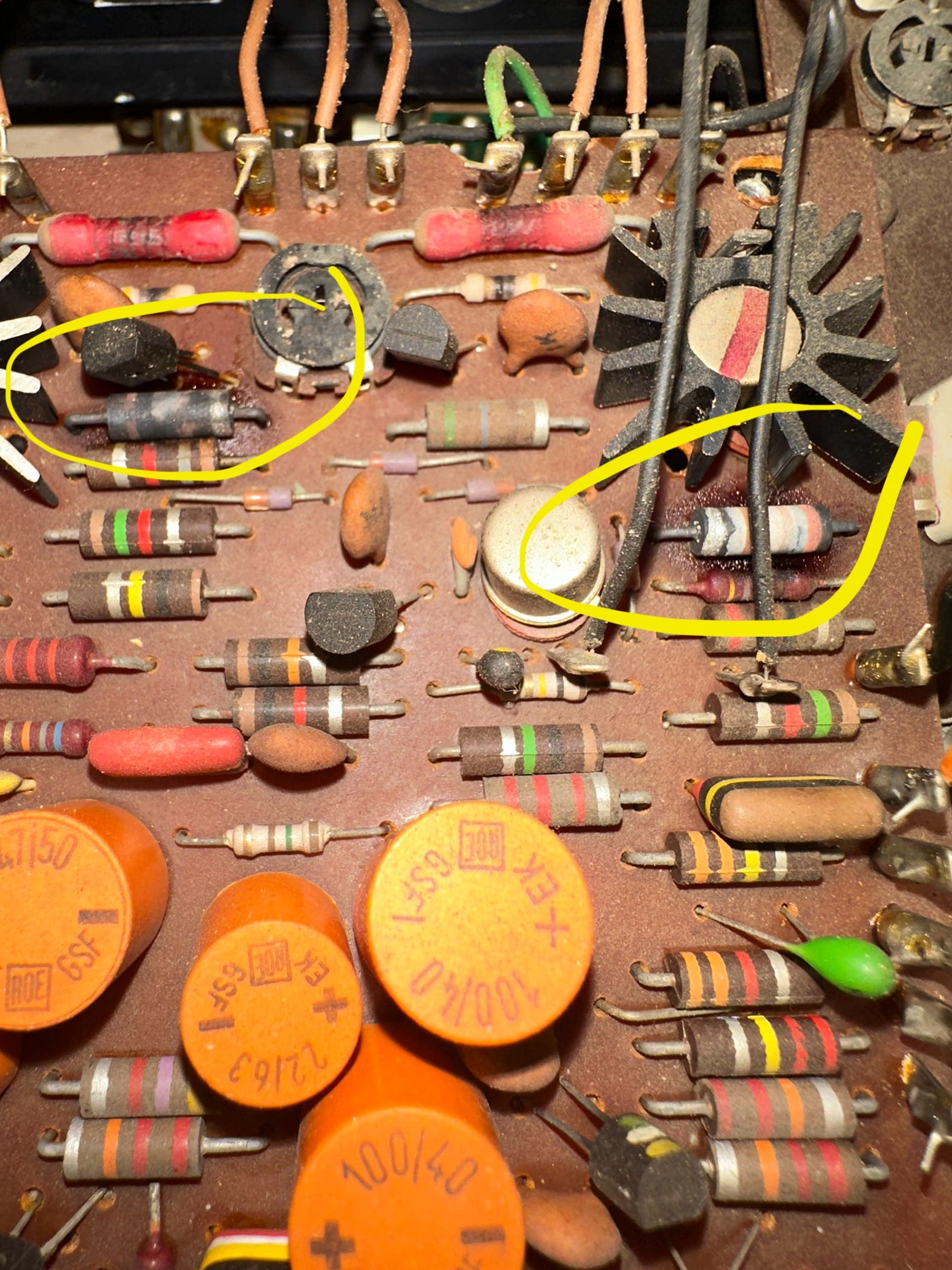

    Hi – I had a Beomaster 3000-2 that worked for several years. Then one day PCB started smoking and it clapped out. A few years ago I looked on the old version of this forum and got advice to replace the main 3 big caps and (I think) the rectifier that’s by the transformer. I think I got it working again for a while and then it smoked out again. I shelved it at that stage. Fast forward to now and I fancied another go at it. I replaced the T1AL fuses and fired it up and got power but then the dreaded smoke and some very hot/burny resistors on the 8002059 board. Looking for any advice on where to get started if I was the finally fix this thing. The toasted resistors are circled below – presumably these will need replaced?
    Replaced parts (previously):
    6800 uf , 100v Cap
    two 4700uf, 63v caps
    One VISHAY GENERAL SEMICONDUCTOR, GSIB2520-E3/45, BRIDGE RECTIFIER, 25A, 200V

    Is this a Beomaster 3000…..if so at first glance it looks like a possible power transistor short could be responsible

    Hi it’s a 3000-2 (with radio tuner) sorry, I’ve updated the title now. Thanks for that. How repairable would transistor be do you think?

    Would i be right to say that this is only one channel that is smoked and the other is still OK, I’m suspecting the output transistor has failed. Without extensive testing its hard to say for sure….the output transistors are Darlington Pairs and you would need to remove them as a start and test them…if blown they will need replacing along with the burned resistors you can see…also the power transistors normally fail due to something else failing first, that thing will need finding.
    Looking at your post you dont have much experience on this sort of thing, as a silver member you can access the manuals in here to help you get an idea of whats ahead of you….

    My advice, if your serious about this is join as a silver member and get access to the workshop manuals and circuit diagrams, identify the failed components and start to post pictures and measurements in here and people will start to input advice and guidance, they wont be able to resist…… be prepared for some initial disappointments and frustrations, you will need some test equipment and basic soldering skills…….but I feel given your desire to emulate your late grandfather you may enjoy, dont buy any components from ebay without first seeking advice in here……lots of fake transistors out there!

    These amplifiers blow with an “avalanche”, causing several components to burn and/or short.
    It can be very tricky to find all bad components in one go – and if you miss one, it will start all over.
    Seeing your board, I suggest you ask around for a complete amp module instead.
    Perhaps not as challenging, but easily both faster and cheaper.
