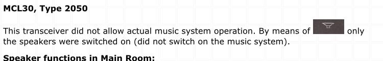

    According to the Beotech page linked to earlier in this thread the MCL30 is simply and on/off button ( or mute if you will) for the speakers connected to it
    IMG_9707
    So the operation of volume and channel switching etc. Will have to be done on the BM3000.

    I found the diagram for the BM3000 and I can see that the speaker connectors (both speaker 1 and 2) are three pin connector where the third pin for the right speaker carries 5V power and the third pin for the left speaker carries a data signal.
    So probably the remote control can operate the BM3000 via the tranceivers IR eye.
    The other text I linked to before might just describe the function of the button on the transceiver which the does have a very limited functionality, especially if the BM3000 is not on.
