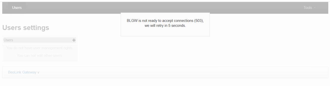

My BLGW writes: BLGW is not ready to accept connections (503), we will retry in 5 seconds.
I have spoken to B&O support, they think there may be a port in my router that needs to be opened but I can’t really figure out which one.Attachments:

BRONZE MemberI had this problem a couple of years ago, too. Taking off power for hours (or days) helped. I sent it to the dealer but when they plugged it in, it worked fine again. They sent it back and it worked also in my setup. Later it happened again, but after some time without power, it worked again… maybe a reset will help, too.
Finally I replaced it with a beoliving intelligence, which is way faster and reliable.
Kind regards, Rémy
3 January 2026 at 01:36 #72304djerik
BRONZE MemberI experienced that my BLGW would fail to start, and took it apart. Inside I found a micro sd card that was failing, and replaced it. This fixed my problem.
