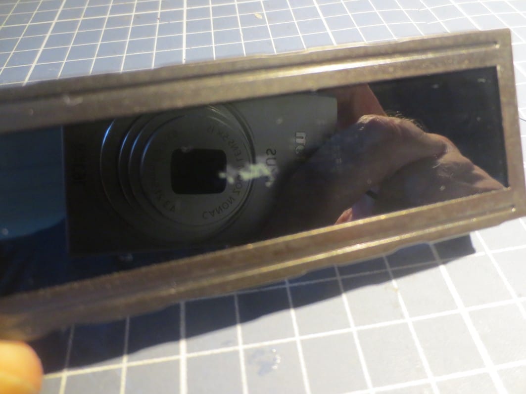

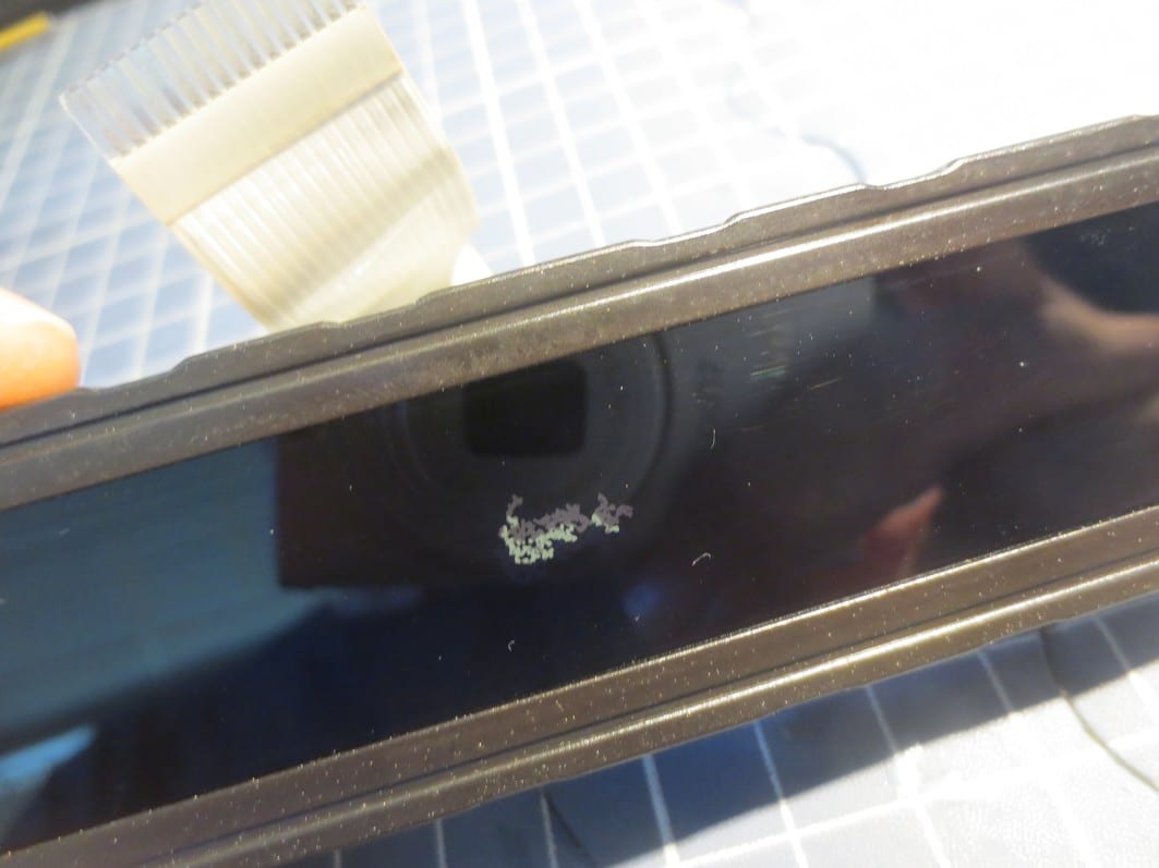

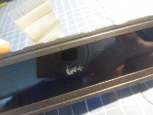

    Hi forum ,
    Can someone shine a light on these 2 questions;
    1 = how to revive the backlight on these mk2 units , the are very dim ,
    i was looking for an ldr in the schematic but apparently went blind ( aka could not find it )
    2  = does someone have a orange lcd ??  mine  has a lcd-gap ( lcd matrix damaged ).

    #67962
    nitro2
    question 2 has been resolved , found someone who could supply me with a new lcd.
