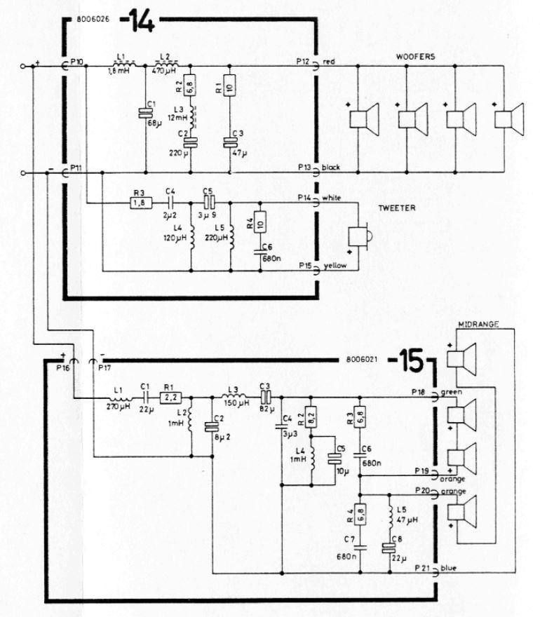

    If you have no sound from the mids that means your mids has been wired the wrong way. Sometimes only 1 driver produces sound.
    There are 2 sets consisting of 2 drivers. Each set are in series. The first set are the outer ones. These 2 are in series. 1 orange wire goes from the (+) to the (-) on the other side.
    Then the 2 middle drivers are in series. Again one (+) connected with the other one (-) with a orange lead. The blue and orange leads are connected correctly. The orange wires which goes down the tower can be interchanged without problems. These 2 end both at the same junction at the board. If wiring is correctly done but you still have hardly any sound from them (outer 2 drivers deliver less sound than the 2 middle ones due to the filtering on the board), then check L3 on PCB 15. It happens that these are burned.

    As I look more closely, your wiring is wrong.

    It looks like your the polarity of the drivers are marked with the “+” stickers. Check the wiring against the schematic.

    I searched a drawing of the wiring. It is taken from behind. So looking at the sockets.
    Location: Utrecht
    #47789
    Beobuddy
    I hope this will be enough. I made it ages ago 😉
    Looking towards the drivers when placed, the tweeter sits at the right side.
    I understand it can be sometimes a bit confusing.
    Location: Utrecht
    #47790
    Beobuddy
    If you look at the diagram from PCB 15. The drivers are placed the way they are drawn from top to bottom.
    Location: Utrecht
    #47791
