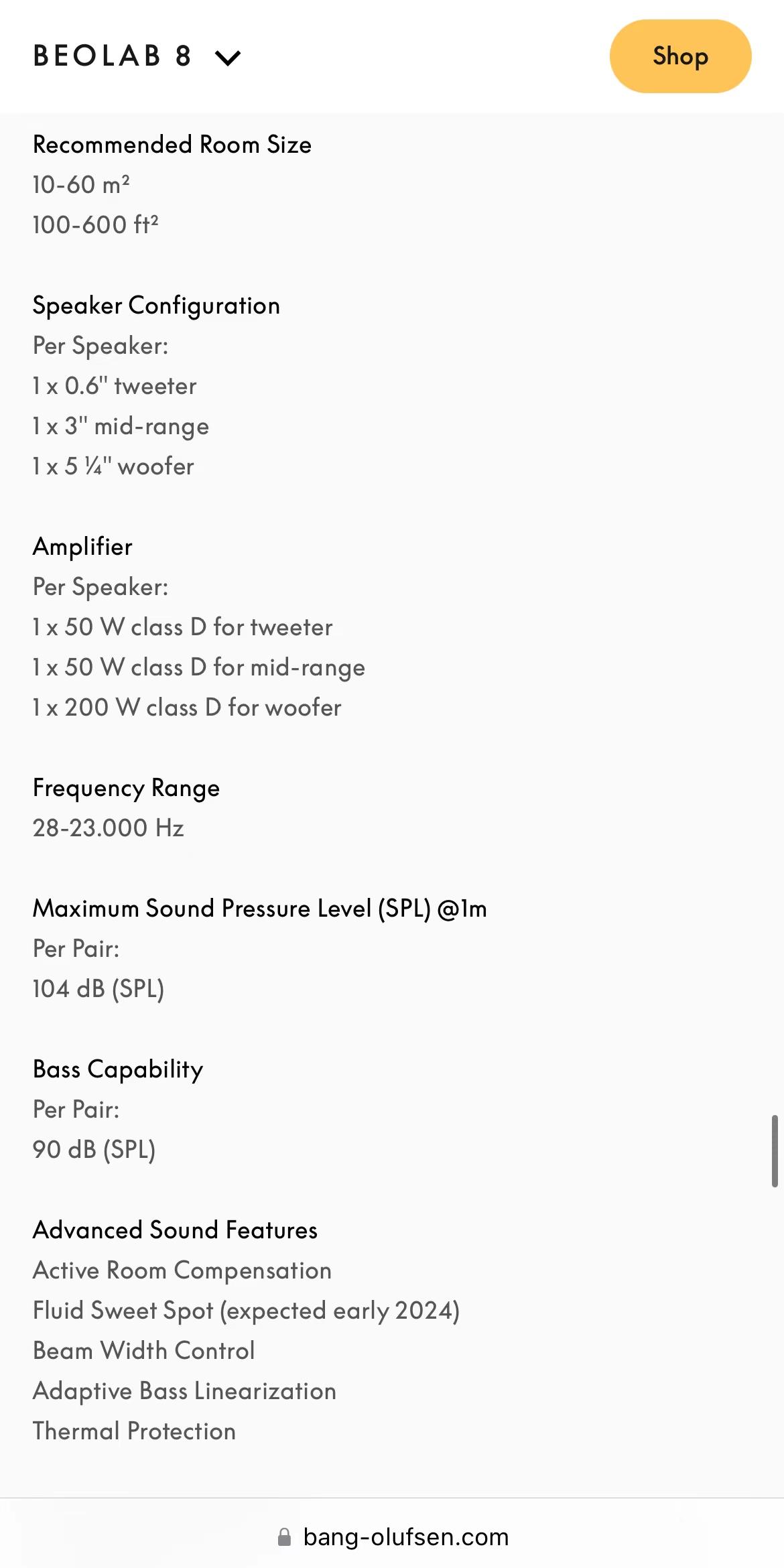

    Bo refresh the lab8’s pages and add the “frequency range”lab8

    SimonWeir
    From my audition in store I am surprised to read the bass number.  Even more so when compared to BeoLab 17 figures…
    Frequency Range
    31 – 24,000 Hz
    Maximum Loudness @1m (SPL)
    106 dB SPL
    Bass Capability
    90 dB SPL

    There may be some incorrect assumptions about what the terms “Frequency Range” and “Bass Capability” mean.
    I explained “Frequency Range” a long time ago in this blog posting:
    https://www.tonmeister.ca/wordpress/2014/10/15/bo-tech-reading-specifications-part-1/
    Note that a graph in a magazine is probably / usually created by doing one measurement in one location in front of the loudspeaker. This is equivalent to evaluating a television by measuring a single pixel – in other words, it can be worse than useless (we often say that, when it comes to a loudspeaker, one measurement is typically worse than no measurements). If you’re going to find a reasonably good representation of frequency range, you have to take a weighted average of a number of measurements at different angular directions in order to be fair/representative/useful.
    Bass Capability is a measure of the maximum output level for the loudspeaker at a given narrow frequency range for a given amount of time.* This has nothing to do with Frequency Range (in the same way that top speed of a car has nothing to do with its 0 – 100 km/h acceleration time). I touched on this (at least intuitively) in this blog posting:
    https://www.tonmeister.ca/wordpress/2013/12/13/bo-tech-what-are-subwoofers-really-for/
    Hope that helps clear up any confusion.
    Cheers
    -geoff
    * It’s important to remember that ABL protects the loudspeaker from clipping caused by over-excursion of the loudspeaker driver, or attempting to exceed the limits of the amplifier voltage / current or the power supply current. However, there is also thermal protection that pulls back the output of a loudspeaker driver to prevent it from melting the voice coil. If you play at maximum level for a period of time, the thermal protection starts working and the level will go down. So, the Bass Capability is the output level before that starts happening. If you’re playing a sine wave, you can hear this behaviour as a simple ramping-down. However, since music & movie sound is much more dynamic, the behaviour is much more complex.
