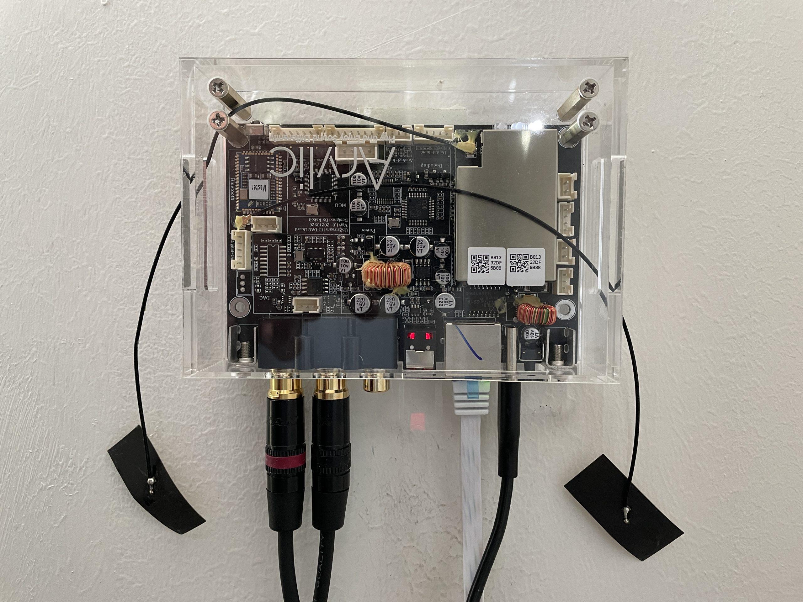

BRONZE MemberI have the Beolab 6002 and switched from the Playmaker to the Arylic Upstream HD DAC to get Airplay 2. Sounds perfect! Connected it directly with DIN – RCA cables and switched the Beolabs to Line mode.
My only issue is that the volume is very loud. When I’m streaming music in the Apple Music app, when volume is at 10% it’s already very loud.
I adjusted the EQ on the Arylic to -12db, but is there another way to adjust the volume more gradually using my setup?
