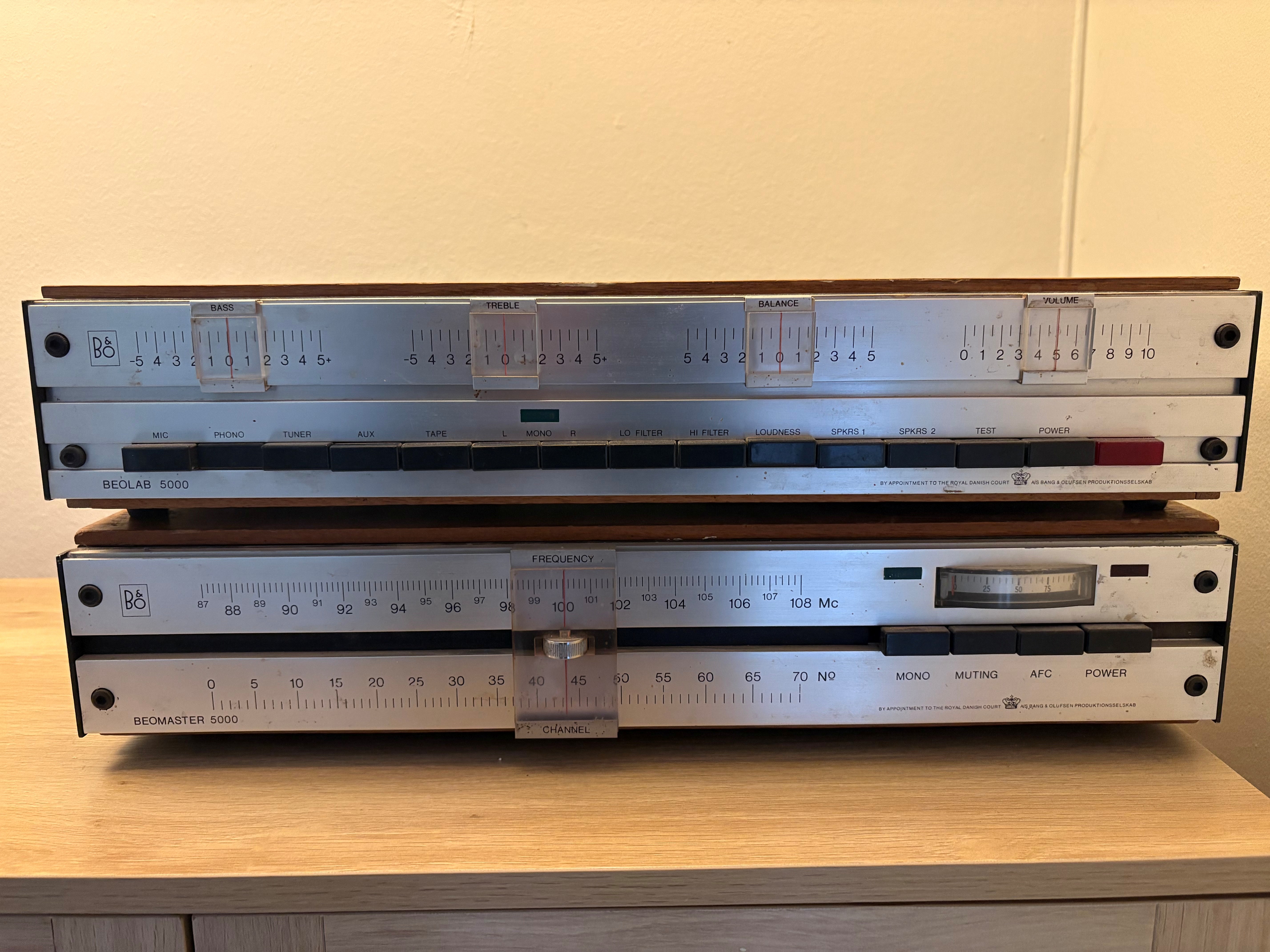

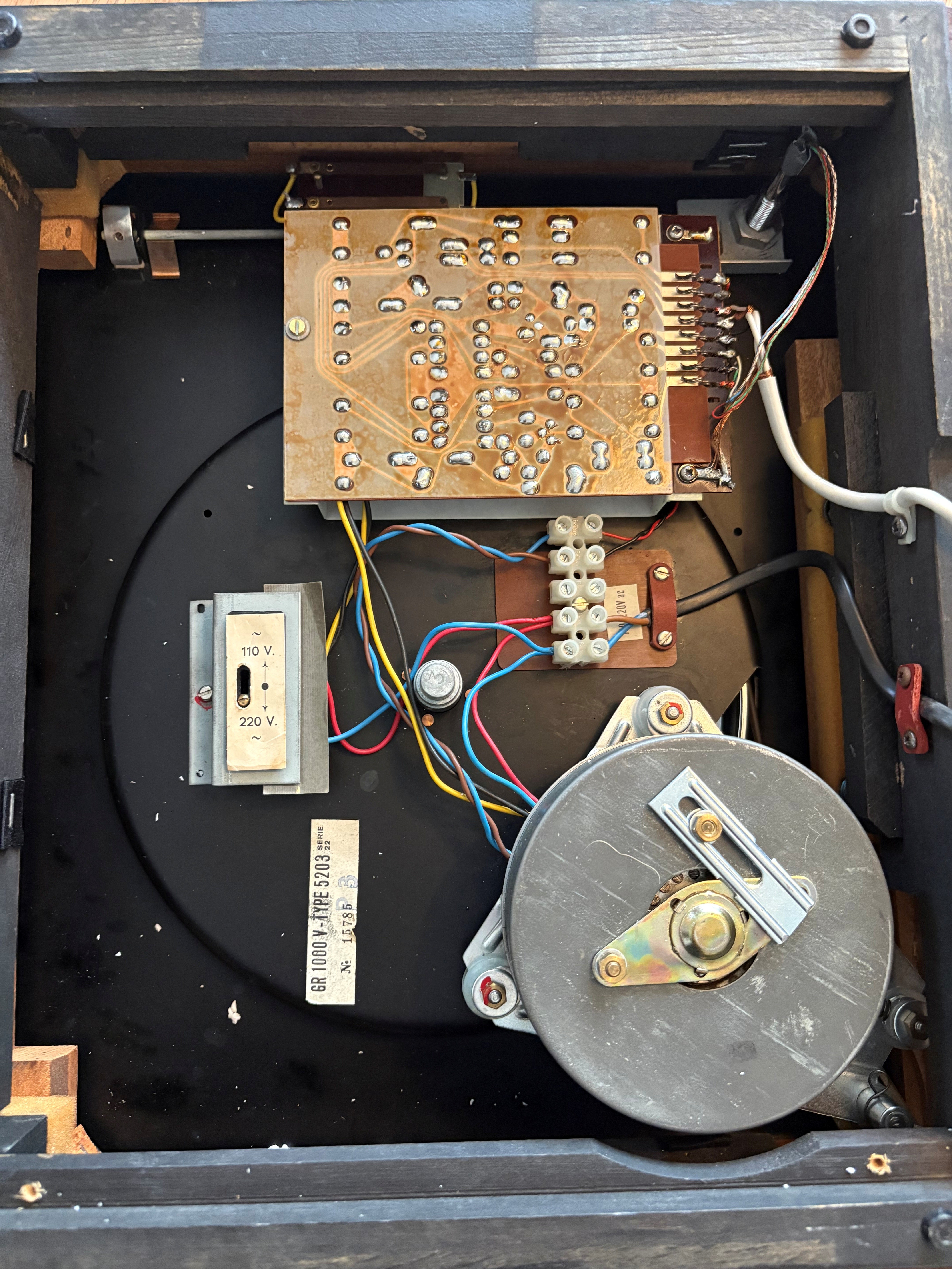

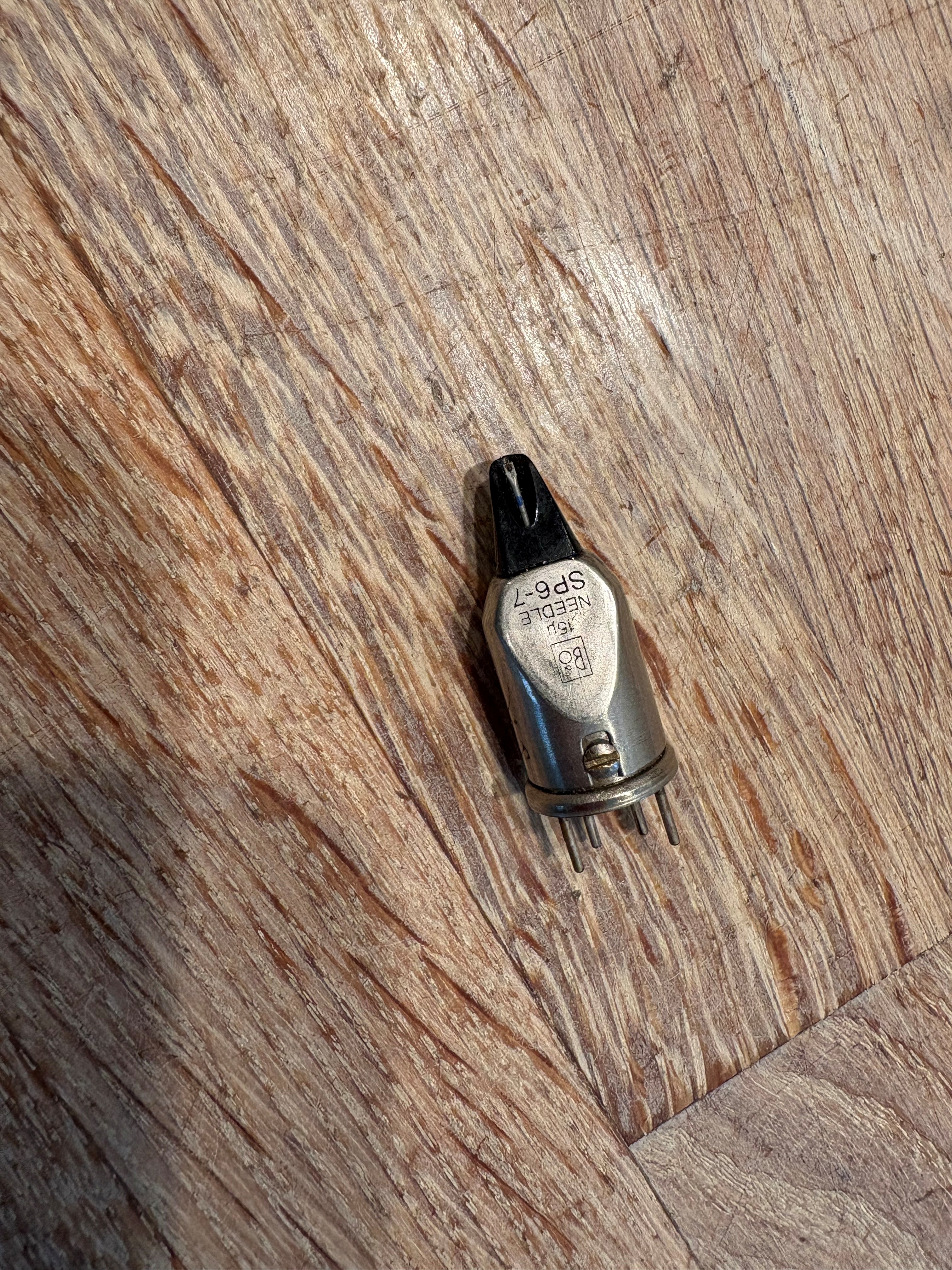

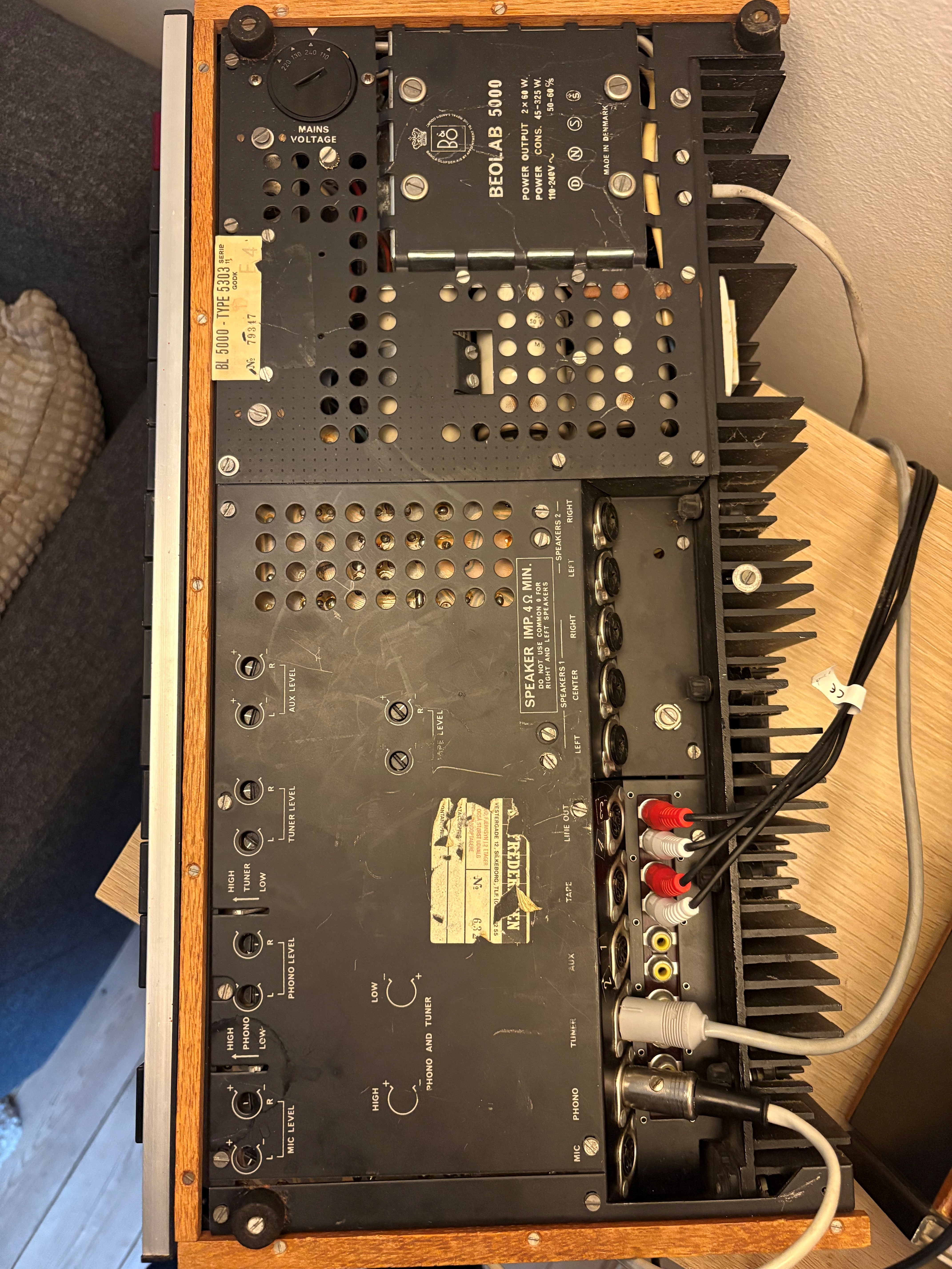

Beolab 5000 – buttom view:Beolab 5000 (and Beomaster 5000) – front view:Beogram 1000 – inside view:Pickup Cartridge:12 October 2026 at 10:53 #125859hcraig244
SILVER MemberA good idea would be to prove which of the two units is causing the problem, i’m assuming you dont have access to a different amplifier? during my dealings with the Beolab 5000 ( I have restored 3 or 4 over the years) I discovered that the AUX connector is wired slightly different to the other DIN inputs…strange I know, If you would like to know more I will dig out the circuit diagrams and post them here.
