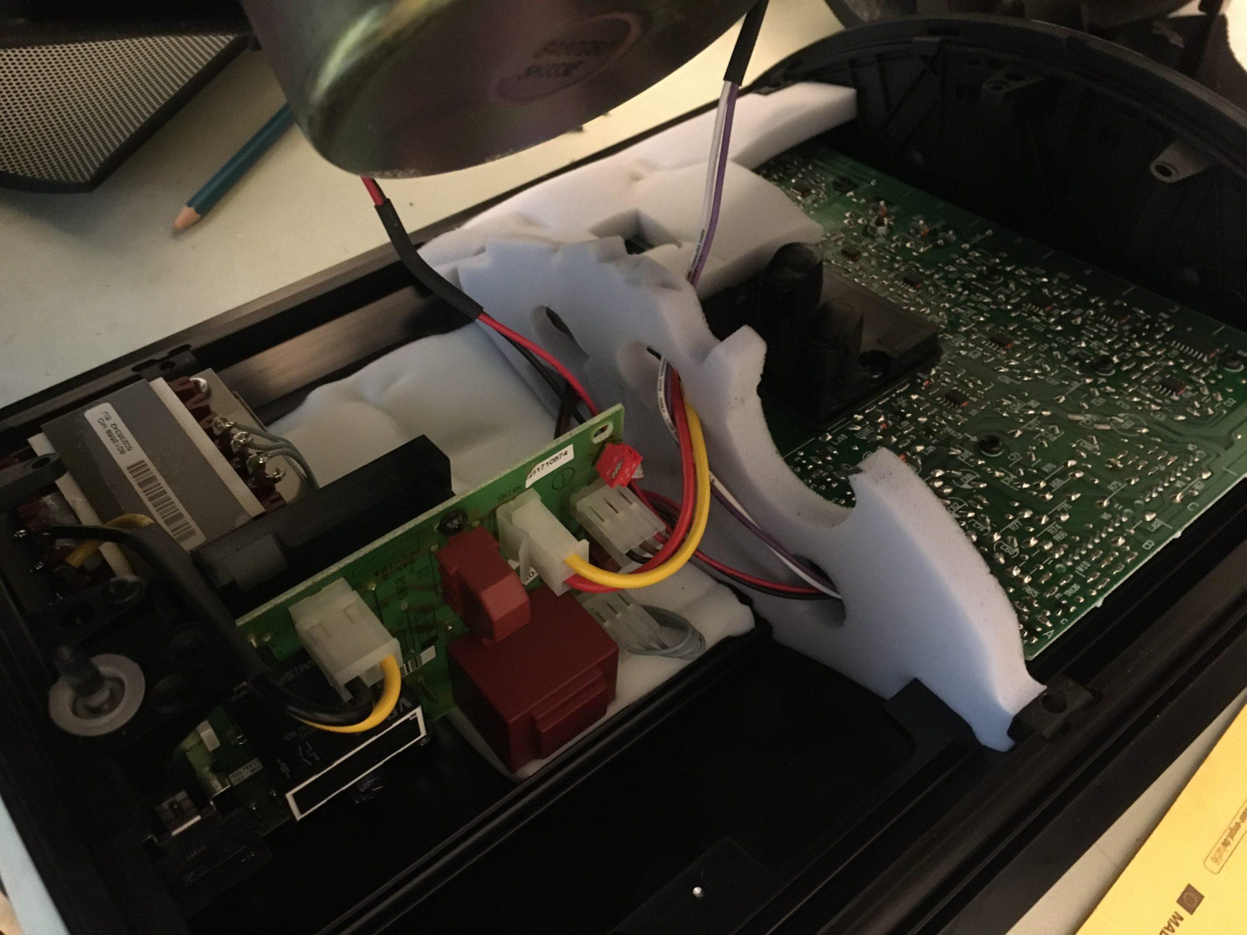

3 April 2023 at 13:46 #45358EliasK
BRONZE MemberYes, here’s a photo, Is just opened them again.
3 April 2023 at 14:27 #45359 Keith SaundersBRONZE MemberWell, that certainly looks very clean, perhaps even new form?

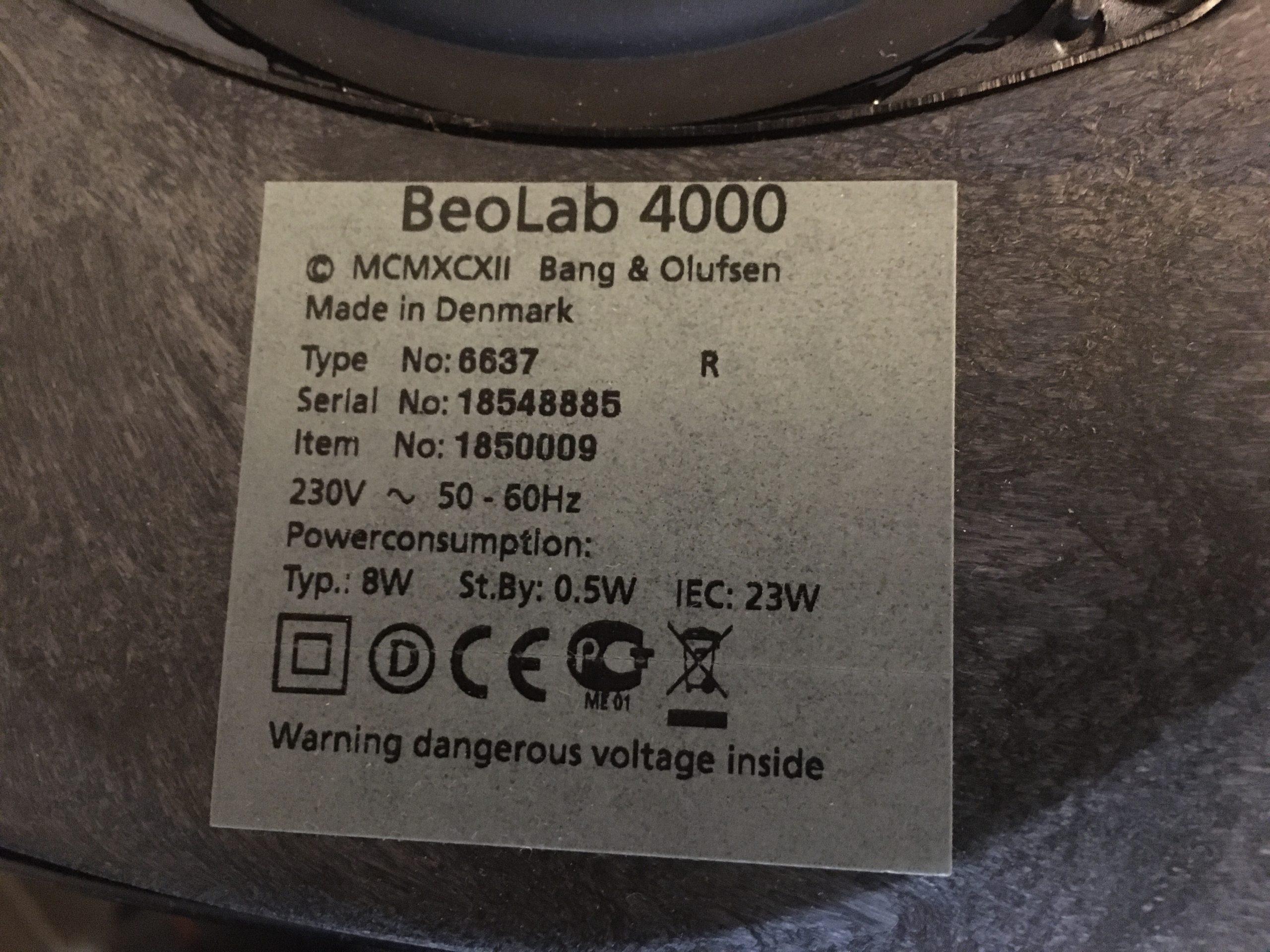

What is the 4 digit type number of your Beolab 4000?

3 April 2023 at 14:45 #45360EliasK
BRONZE MemberNo I don’t think so. I just bought these used from a very friendly guy, he said he had them checked once because he was worried about the foam but was told they’re fine. He said he has never had trouble with them and this problem hadn’t happened. He even inquired at a B&O dealer about the foam when I noticed this and asked him about it, he said the dealer said that the foam problem was resolved in 2005.
It’s a bit strange because the problem doesn’t occur rhythmically or at certain intervals or times. It’ll switch back and forth a few times and then stay in standby for a while again…
