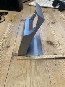

I’d like to model a BL3500 table stand mesh to 3D print it and see if it can hold the weight of the speaker.
I can find roughly its shape from the owner’s guide but like to be as close as possible from the original.
If anyone has the stand and time, could you please size it for me and add some picture (for holes…).
A perfect side shot or better a flatbed scan would be a great help also.Of course the mesh will available in the forum for everybody (if it works!).
Regards.

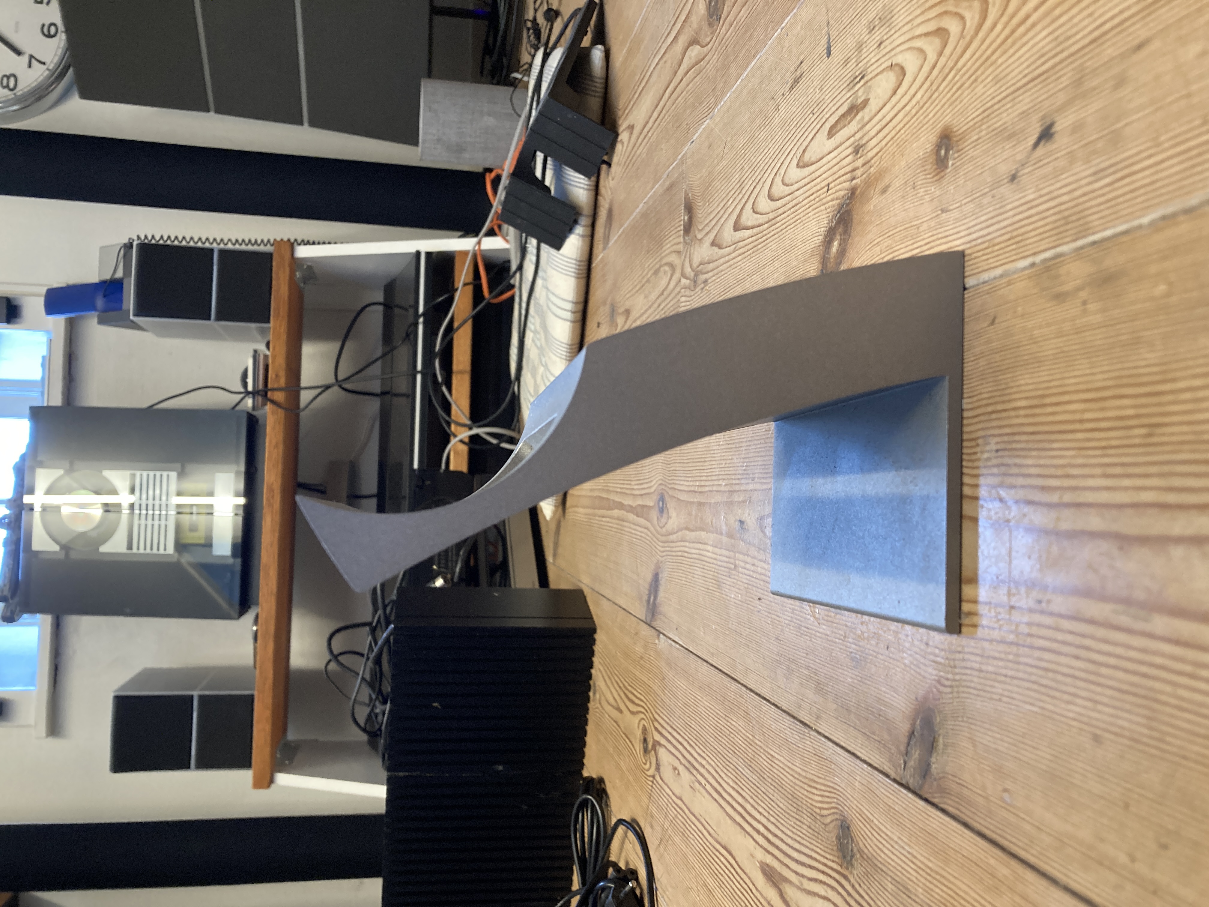

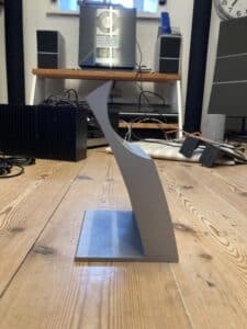

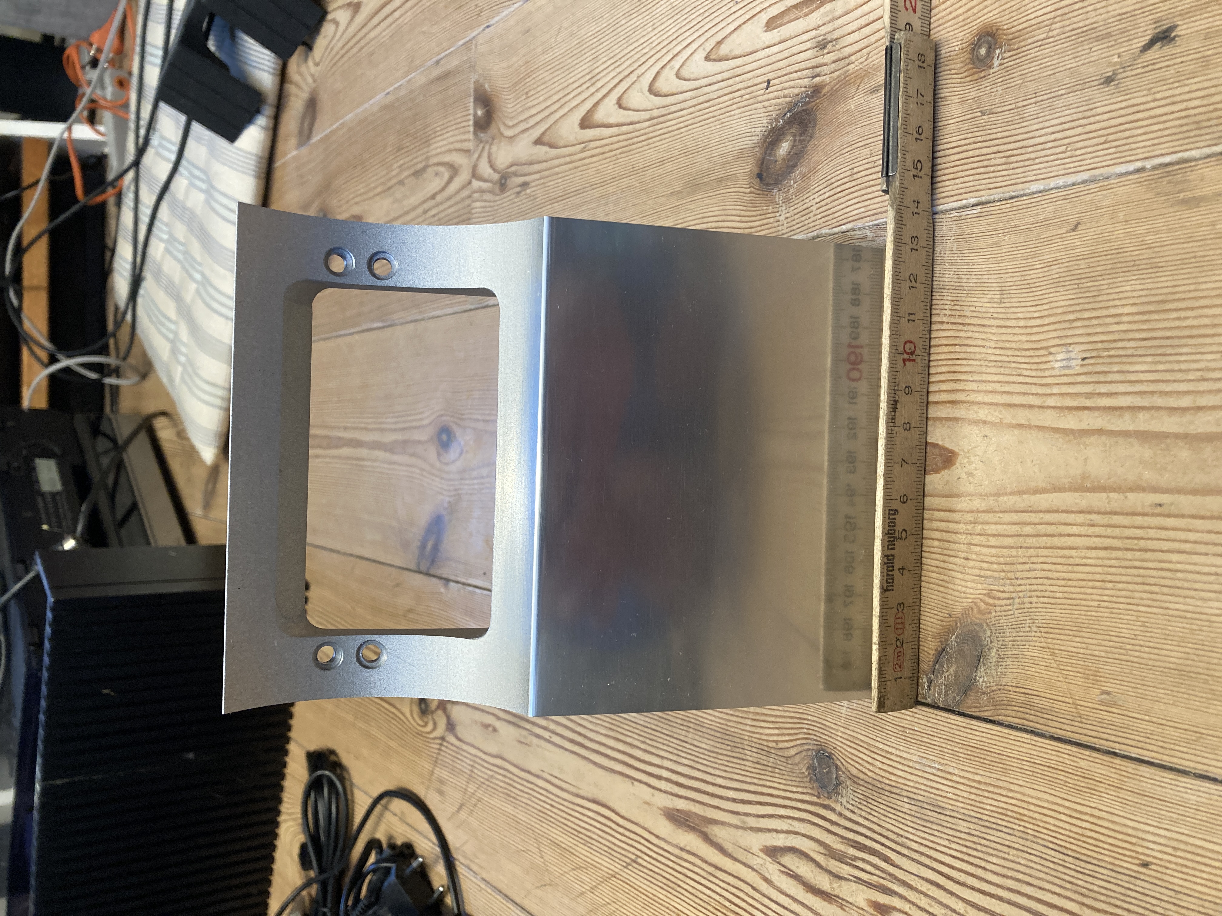

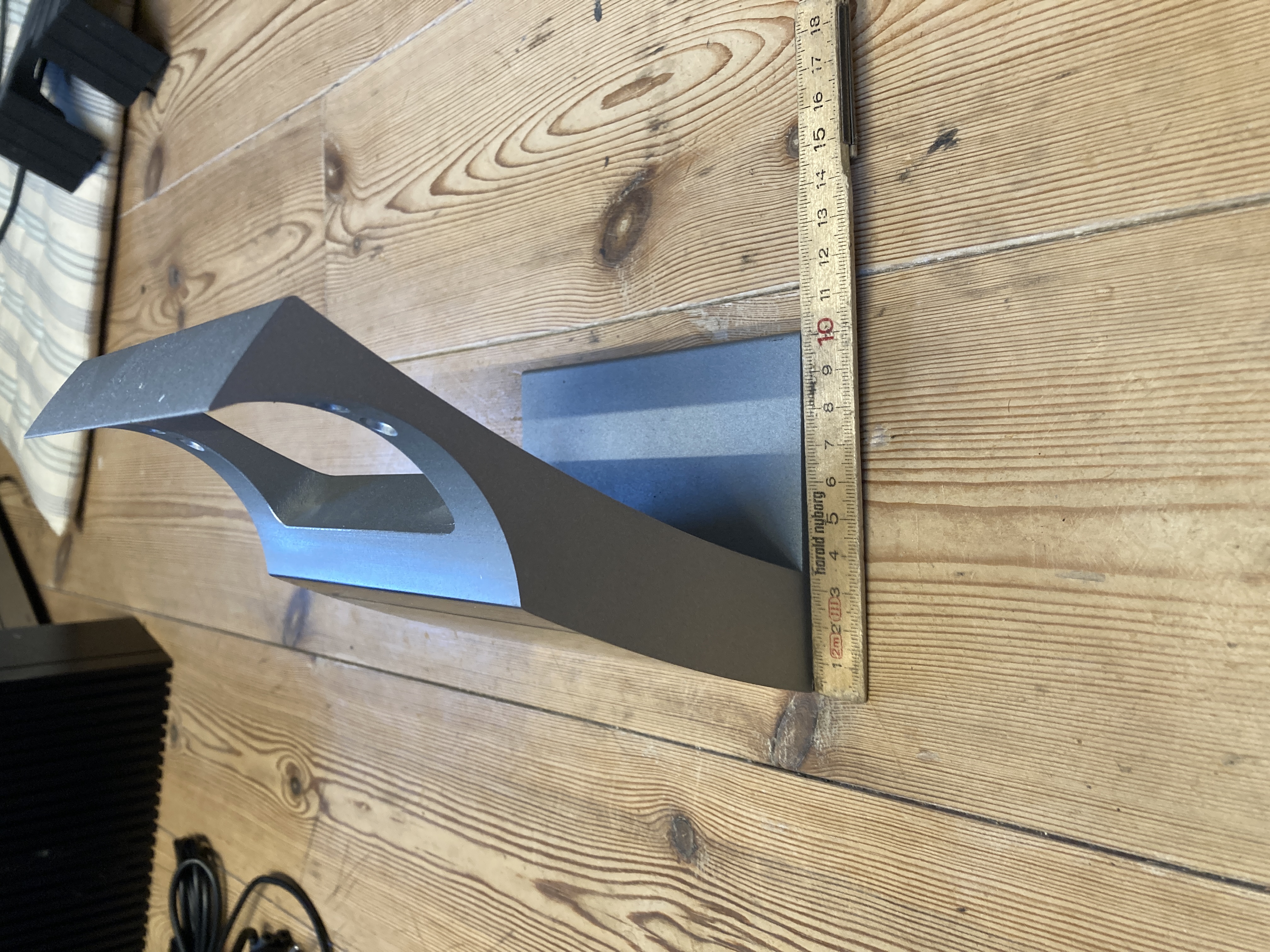

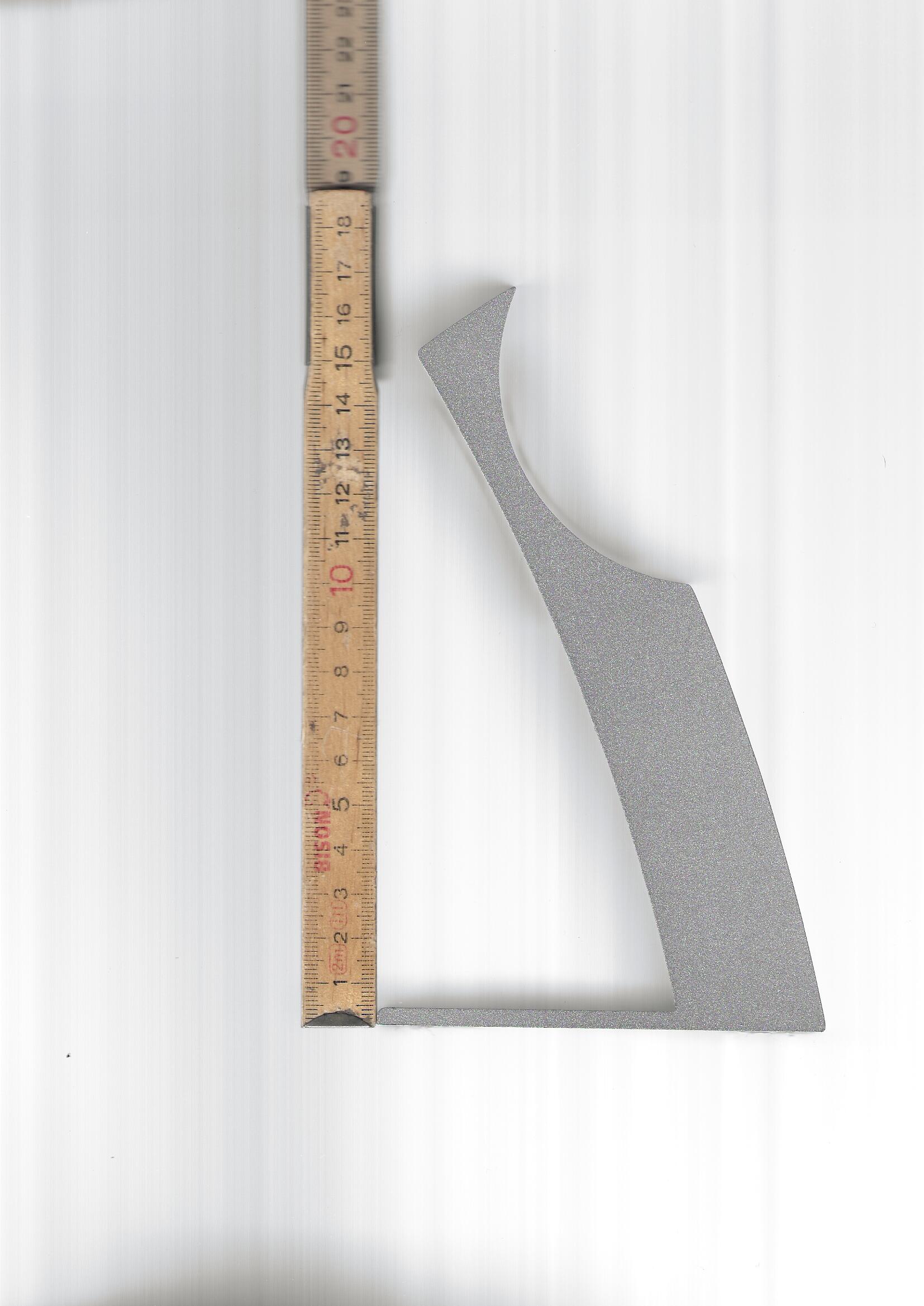

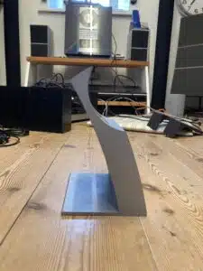

GOLD MemberI have one of these pieces of unobtanium in my collection and I owe you one for the fine drawing you made of the Playmaker stand.
I can not guarantee that I can make something as good, but I can give you measurements, pictures and a scan of the profile of the stand.
Would you prefer the Scan as a PDF or a picture?

26 June 2025 at 18:43 #66685Madskp
GOLD Member27 June 2025 at 06:56 #66691 matador
ModeratorHi Madskp,
a scan of the profile of the stand. Would you prefer the Scan as a PDF or a picture?
A picture would be perfect.

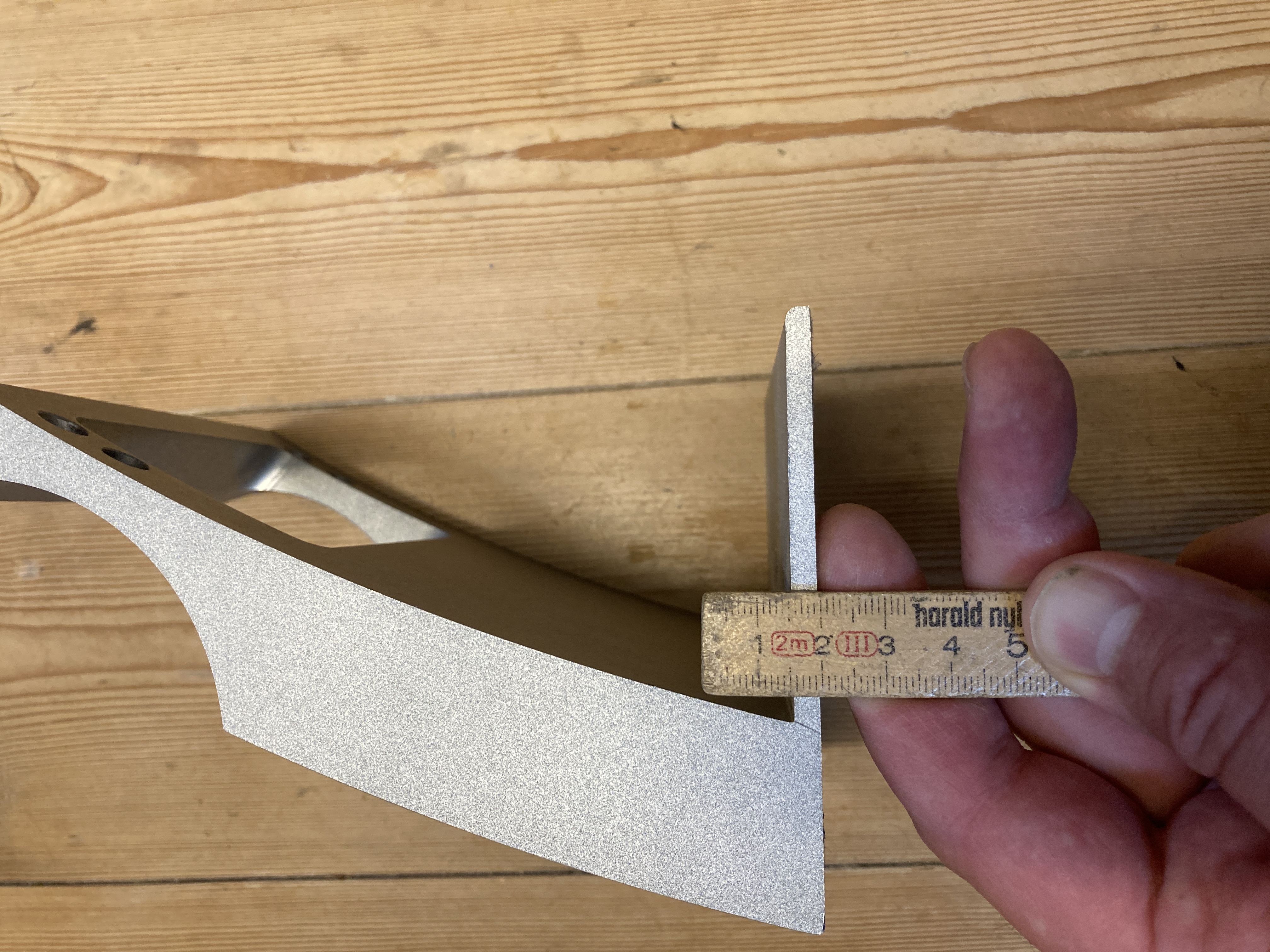

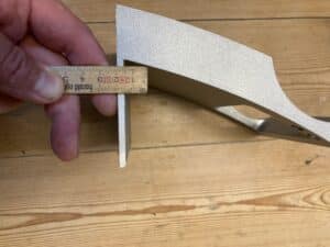

The pictures you posted will be a great help. Could you please measure the whole height of the stand ?
Thank you!
Location: Paris France
28 June 2025 at 08:16 #66703Madskp
GOLD Member28 June 2025 at 13:19 #66707 matador
ModeratorThat’s perfect, all I needed to know for now.

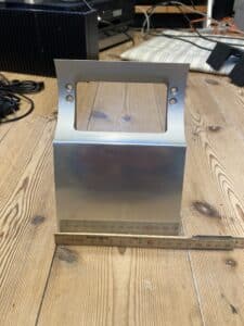

28 June 2025 at 17:37 #66712Madskp
GOLD MemberI may come back to you later in the modeling process to check the holes position (I bet B&O does’nt place them randomly and speaker orientation has it’s reasons).
I sure I can get some measurements for that when you are ready for that. The upper pair of holes place the BL3500 display in a 90 degree position, where the lower set of holes gives it a little angle pointing the display more upwards.
