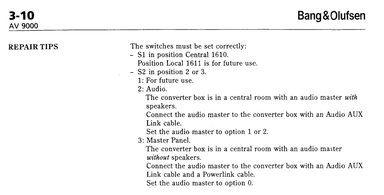

I found a MCL service manual on Archive.org that besides all the MCL2 stuff (also for the newer MCL2AV) also has the service documentation for the 1610 AV9000 Audio kit.
This reveals what both the internal and the external the switch do:
However a little disapointing for those settings where it is for future use.
With this knowlede I had to do a test to see if I could get it working. I have tried with my BC6-23 as Videomaster (V.opt 2) and my BC9300 as Audio system in A.Opt 0 and the 1610 with the external switch in position 3.
No result I could not get the TV to start the BC9300. Also tried to add more power from an external 12V power supply as the 1610 use som extra pins in the Masterlink connector for power, but still no result. I tried with 2 of the 1610 boxes I have with no luck.
And just to verifiy that the TV and the beocenter worked togheter I tested the connection between them with a Beolink Conveter 1614 in between and that worked flawlessly. I guess the 1610 boxes probably either only will work with the AV9000 ore are defective.
