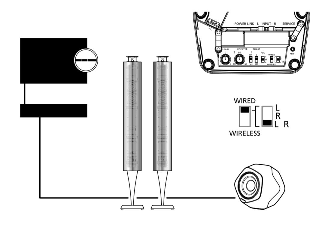

Could I connect 2x Beolab 18 and 1x Beolab 19 to Beosound Core without using Transmitter 1?12 March 2024 at 13:07 #53353 Millemis

BRONZE MemberI was lurking with interest, waiting for a reply to this…I find the diagram below ambiguous (as with many of B&Os user manual diagrams). It does appear to suggest that you can daisy chain PL connections from one BL18 to the next and on the BL19, but nowhere does it state that as far as I can see.

BRONZE MemberThank you all for the quick reply!
As far as I get it, I should connect Beosound Core > via PowerLink > BL18 [1] > via PowerLink > BL18 [2] > via PowerLink > BL19.

12 March 2024 at 23:44 #53356Curly

13 March 2024 at 04:21 #53357DT79
