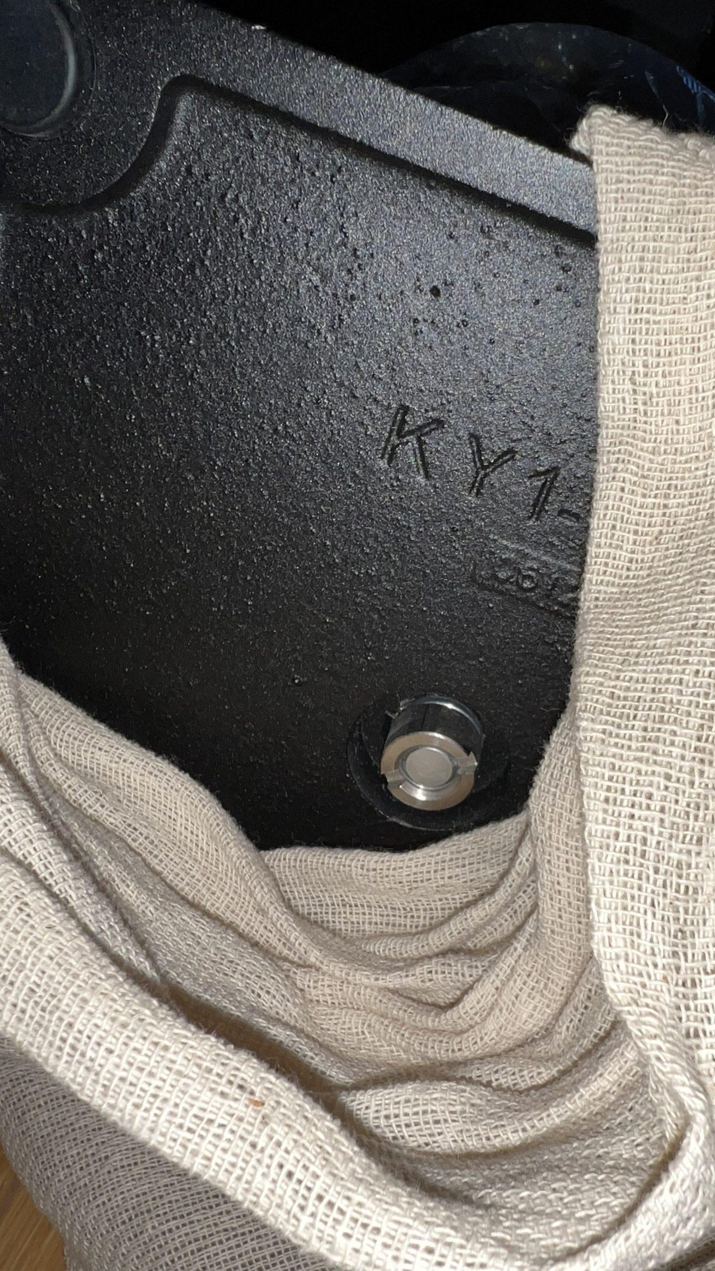

    terrenceromeo
    apparently the internet has no answer for this, so I turn to the forum experts. What do I use to tighten the base bolt on Beolab 18’s?
    It’s too wide for any screwdriver I’ve seen.
    IMG_4502-scaled
    #46521
    trackbeo
    The tool that the bases came with!  Or, any wide, flat, piece of steel.  The long middle part of a typical cheap “church key” can opener with both rounded (bottle) and pointy (can) ends would work OK.  The essential knowledge is that the nut will not be tightened beyond the point that a simple flat pry bar would run into the bolt and be bumped off.  Getting the nut off is harder(*), and would require using two smaller flat-head screwdrivers held in a “cross grip”, like a plumber would do. (That’s if you don’t have the double-tipped tool.  The mistake people often make, is trying using the double-tipped tool to tighten the nut — they bend the tool tips.  You tighten with the flat part of the tool, which gives you more torque and won’t set the nut beyond the end of the bolt.)
    [Edit: Such precision tightening requires the presence of the 2mm thick lock washer between the nut and the base plate.  Your photo shows one, but if future searchers are DIY with no tool, maybe washers were missing too?]
    * “That’s what she said.” (Sorry, been watching to much of the BeoTalk / BOTF bros.)

    #46524
    Mjoelnir
    Exactly that just happened to me while unscrewing the bolt from a brand new Beolab 18. The bolts were attached to the screw when I unpacked the speakers. I used to tool just as shown in the manual, turned it anti-clockwise. The nut didn’t come off, but the toop tips are bent now.
    What should I do?

    #46527
    Mjoelnir
    Thanks for your help.
    I brought my Beolabs to my B&O dealer today (he’s not far away). The first thing he did was getting his own B&O tool and some sturdy pliers and bent the tips of his tool into position. He said it’s usual that they keep bending, without acknowledging this fact. With one precise move, the first nut came off. He said that he has some experience doing this… The nut of the second speaker was way harder to loosen. In the end he wrapped a thick cloth around bolt and nut and unscrewed the nut by using a wrench. It didn’t work instantly and required quite a bit of force.
    Now both my Beolabs sit tightly in their baseplates and everything is fine.
