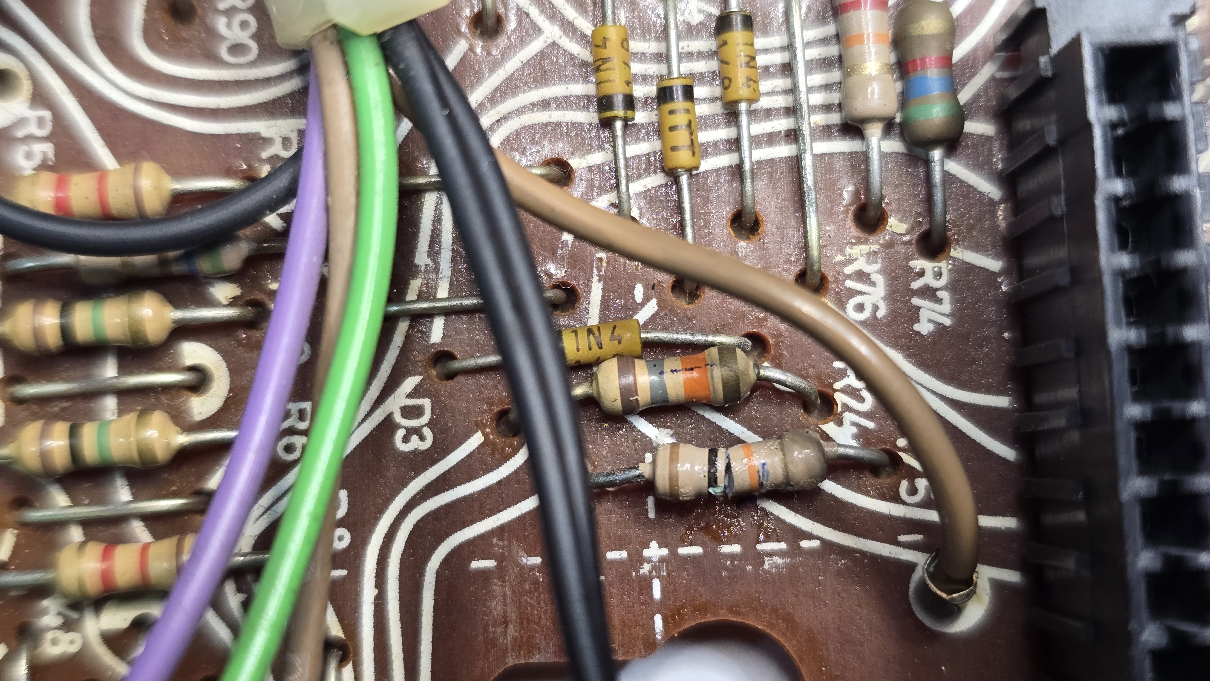

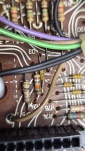

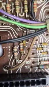

    Hi
    Upon recaping BG8000 PCB I spoted a broken resistor at R25, it is snap in half.
    I presume its better to replace it but I wonder what function does it have.
    As a side note the lamp at the tracking sensor is dead and the arm does nt move more than a few cm in the plater without returning to the starting point… is there any connection with this broken resistor ?
    Any information its very welcome

    Dillen
    The resistor works in the circuit providing a slower forward towards the lead-in groove.
    Martin

    Vasco Machado Vaz
    Thank you Dillen
