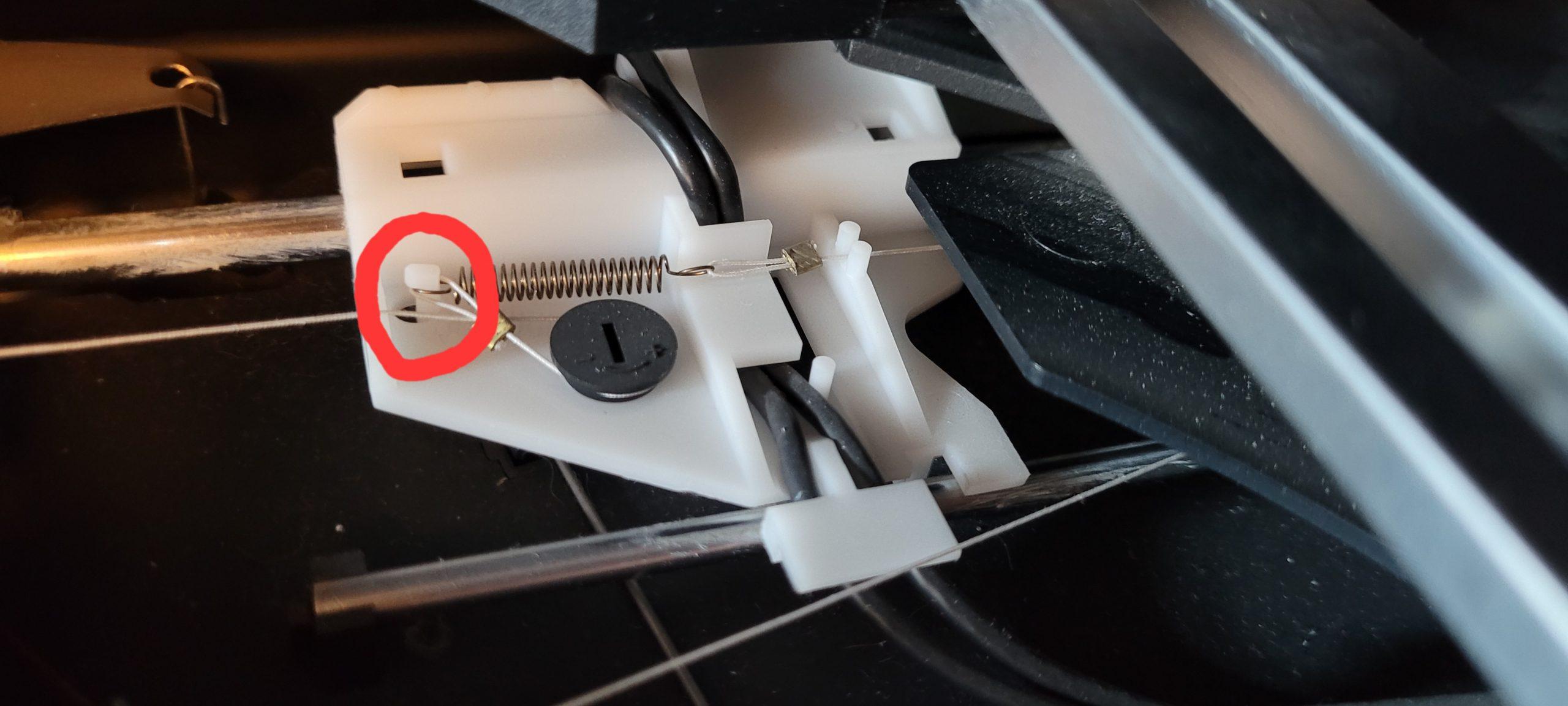

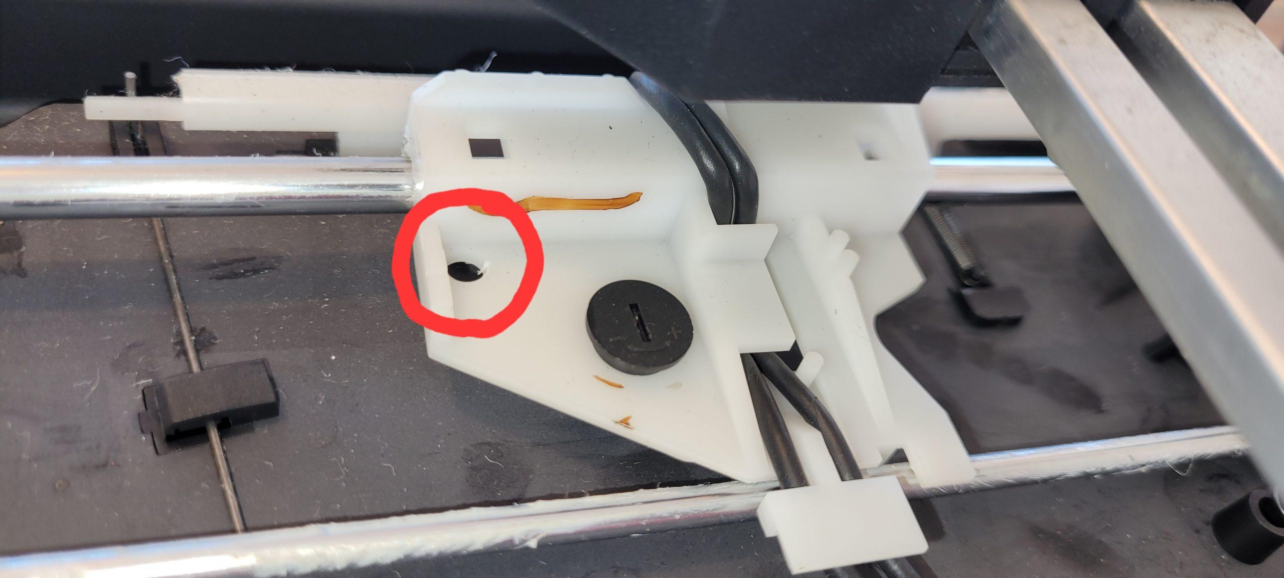

I recently got an actually very nice Beogram 4500.
Unfortunately it is defective. I have already replaced the belt for the sled and will re-route the cable.
However, the retaining lug for the cable is broken (or missing if it was plugged in).
Can you tell me if I can replace/repair this?
Maybe there are also spare parts or an object for 3D printing?
In the first picture you can see what it should look like, in the second how it is for me. 🙁
Thank you very much for your help!

ModeratorFit a screw M3x10 or so through the hole from below, put a washer and a
nut on top and fit the
string loop and the spring to the excess upward pointing screw thread.
Adjust the setdown points.Martin

BRONZE MemberPerfect and simple idea.
Thanks a lot!
