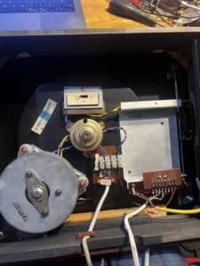

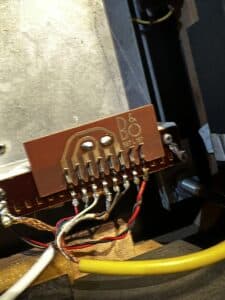

12 September 2025 at 12:17 #69569Tim McCormack
BRONZE Member12 September 2025 at 18:17 #69577 Mark-sfBRONZE MemberI’m not sure which wire you believe is totally missing. If you are referring to the Red/Black twisted pair in the first picture that appears unconnected, that is normal for 1000’s not equipped with a phono PC board. Yours simply has the jumper board that directly connects the tonearm cable to the output cables which then go into a preamp’s phono inputs. What is actually not working?

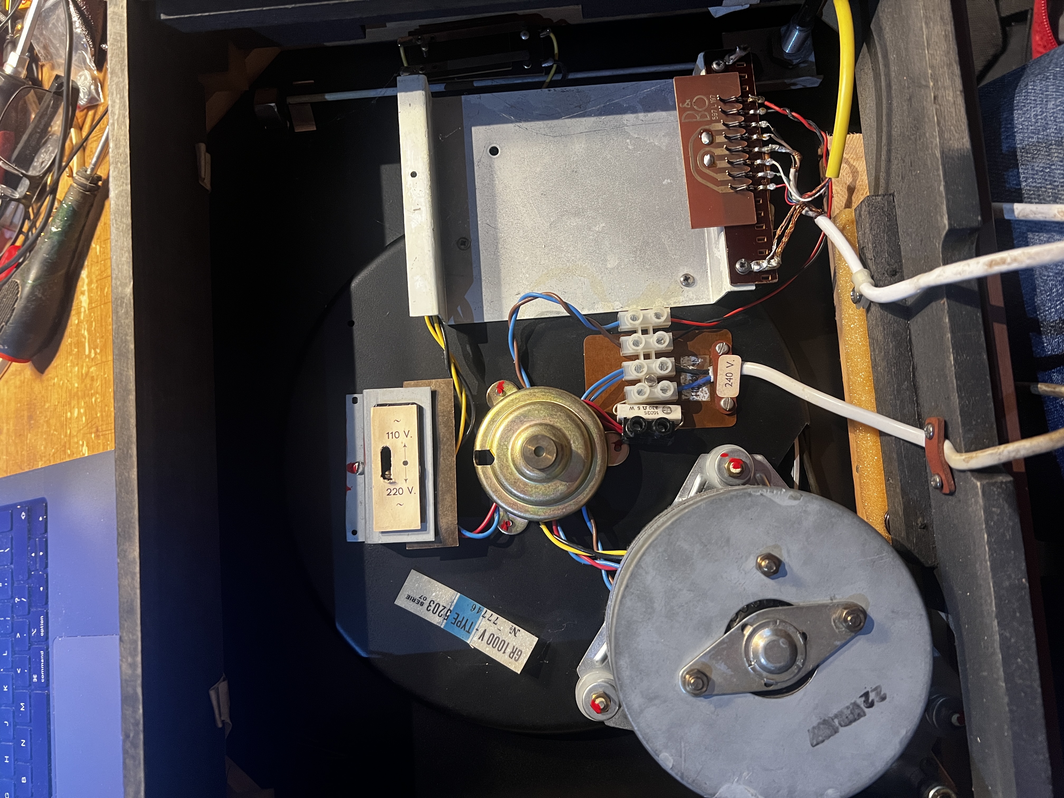

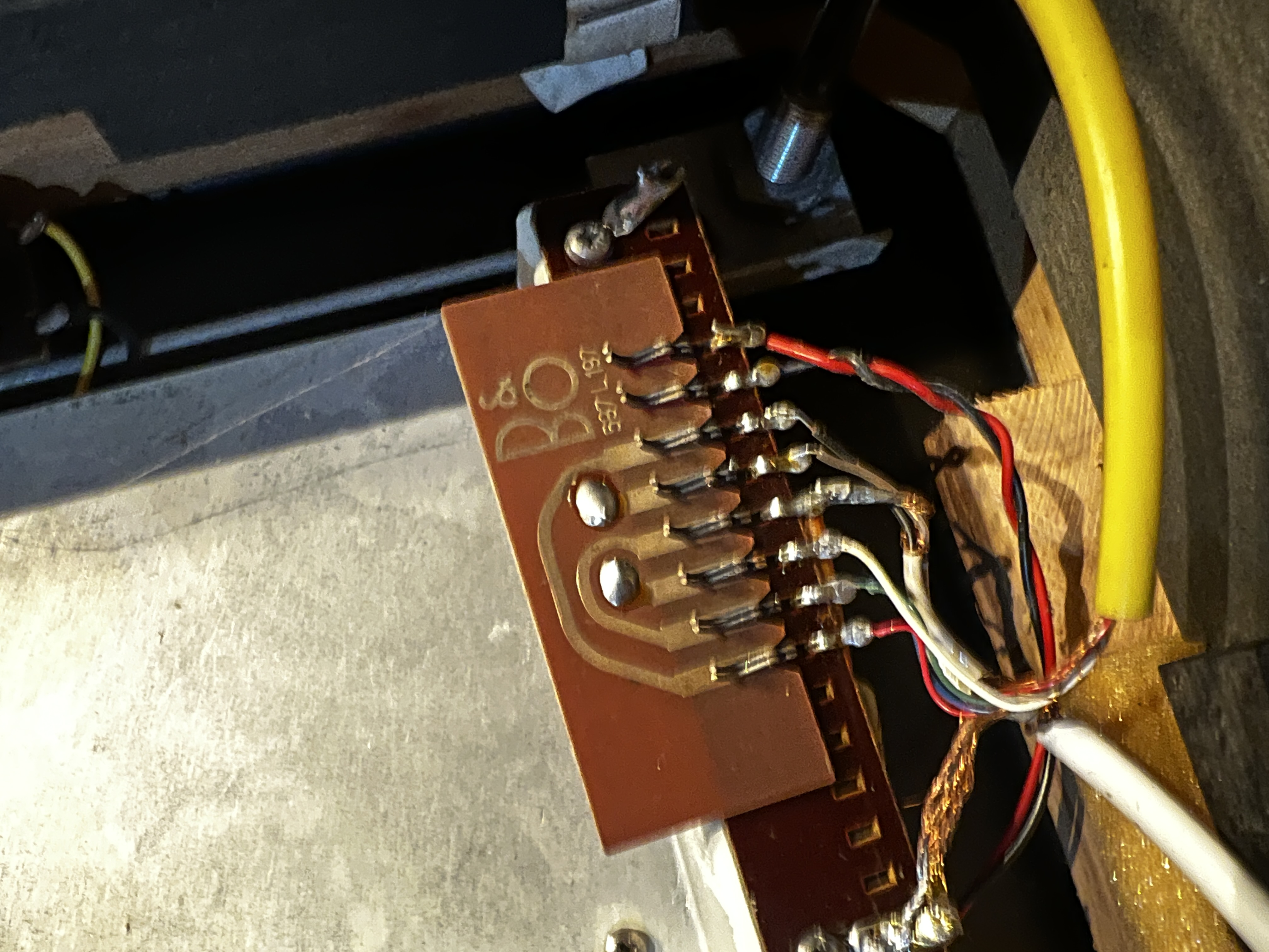

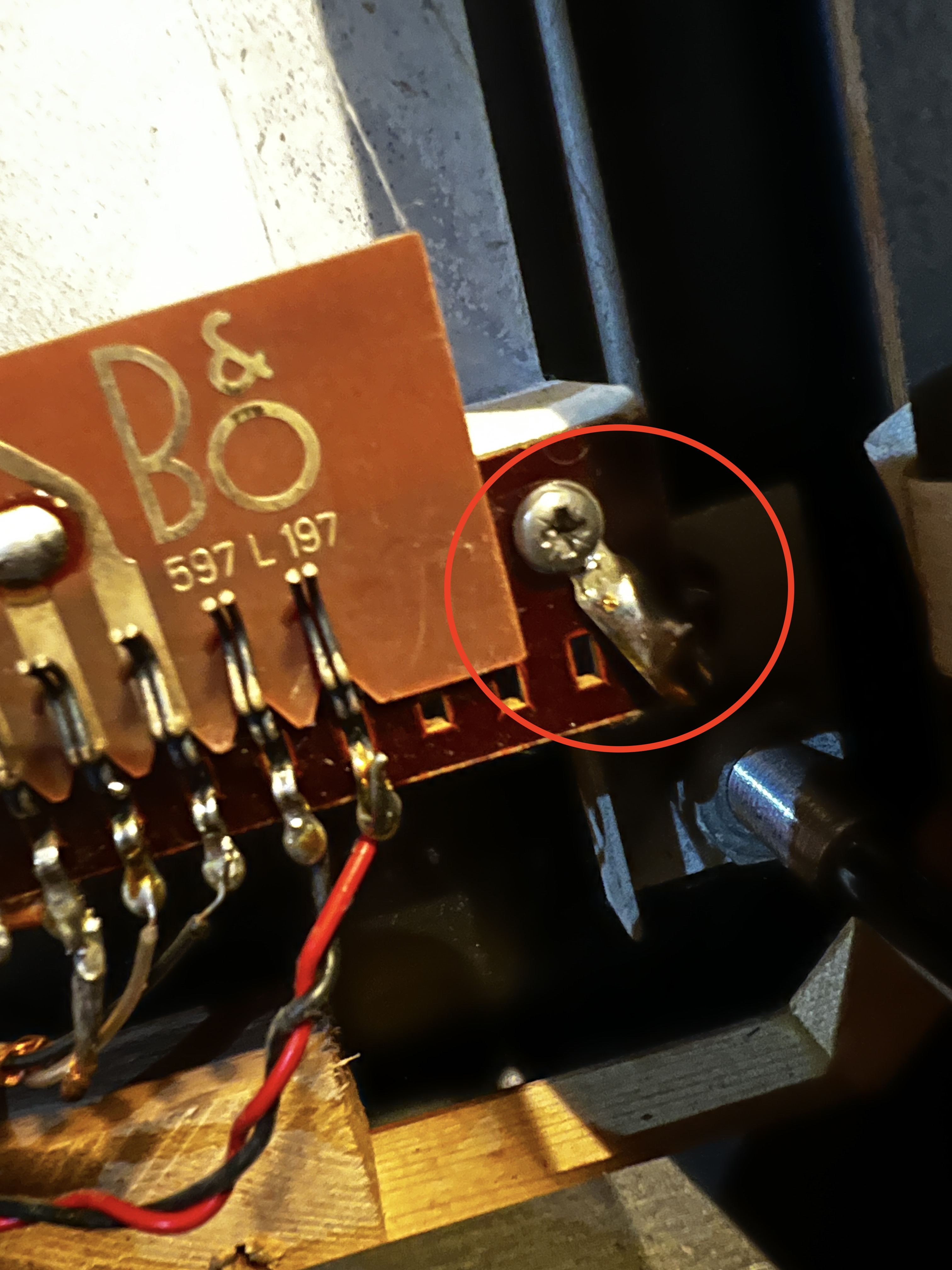

14 September 2025 at 18:08 #69664Tim McCormack
BRONZE Member14 September 2025 at 21:36 #69671 Mark-sfBRONZE MemberThat is simply a chassis ground.
15 September 2025 at 12:45 #69688Tim McCormack
BRONZE MemberThank you, I will have to dig a bit deeper and see if I can find someone locally to take a look
15 September 2025 at 18:14 #69696 Mark-sfBRONZE MemberOn a turntable that old, if its motor is not turning then the grease has hardened and bearings dried out. You never posted what is actually not working.
