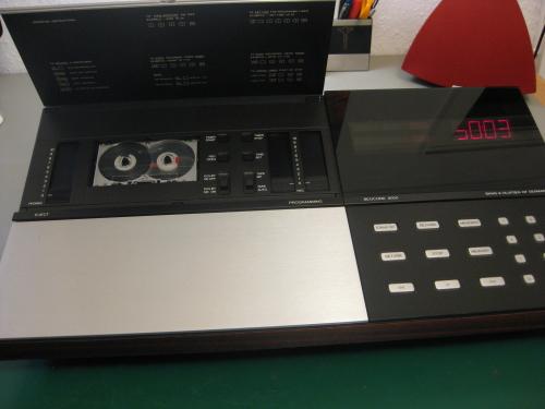

    And here’s the Beocord 8000, now with power on:
    så kører vi
    #45599
    redfox
    The extra fuse is inserted and the Beocord 8000 now fully works. Plays fine. Thanks for the help!
