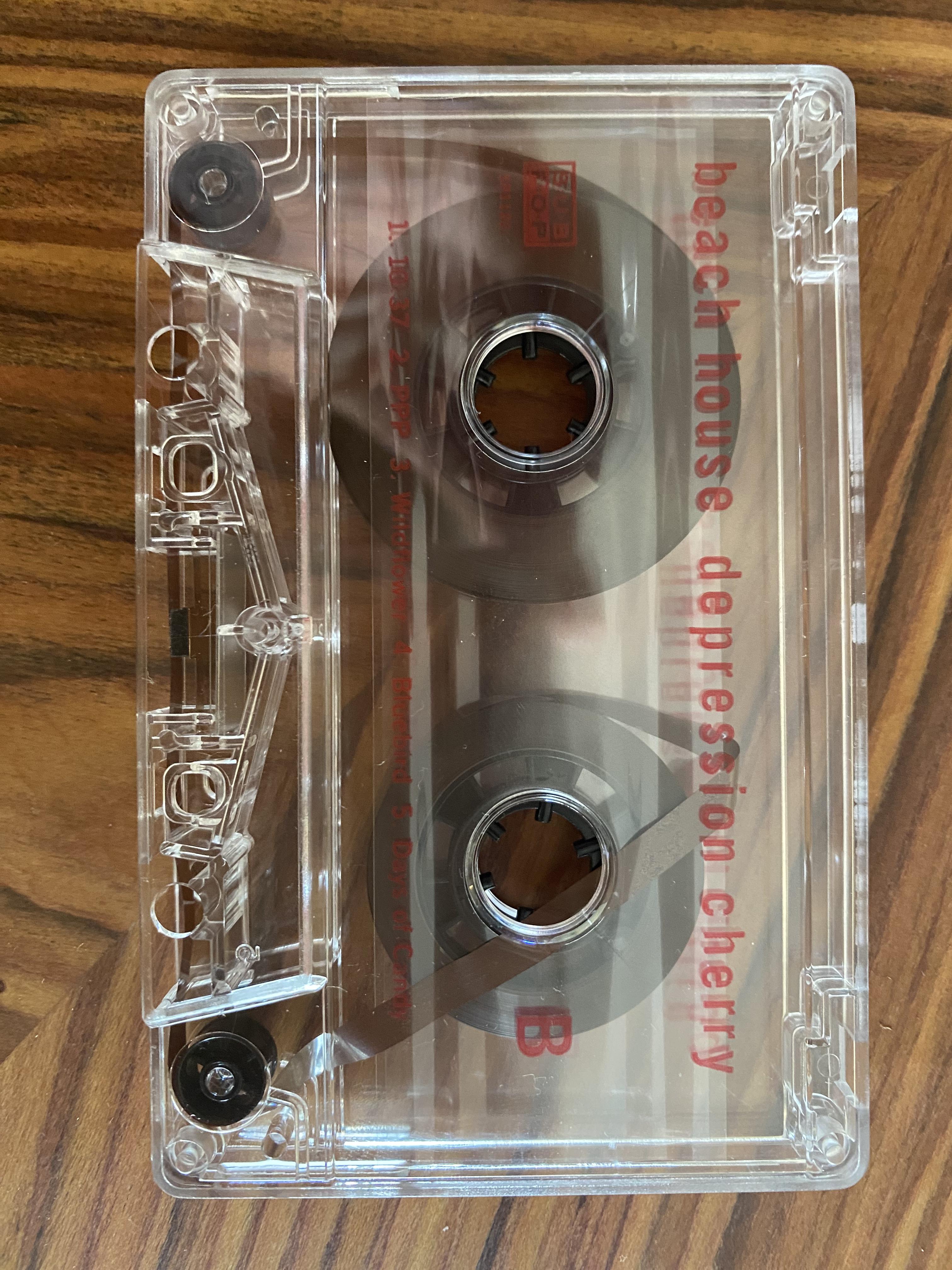

BRONZE MemberHi, breaking a cassette may be a strong word, but I don’t know how to fix this:
Also, do you know how it could have happened? This was a new tape with less than 3 plays. I am using a sacrificial tape now to see if it will be reproduced.
Is it the Beocord’s fault, the tape or mine?
21 November 2022 at 14:30 #40920 AdamSBRONZE MemberI’d say it’s a poor quality cassette shell that has allowed this to happen. You’ll probably have to break the shell apart to fix it, then glue it back together.
22 November 2022 at 05:37 #40921artig
BRONZE MemberBefore breaking the shell apart I would take a pen or pencil and turn the lower reel slightly clockwise to loosen the tape and try to pull it gently out of the cassette while doing so. It may get the tape back on the reel without any damage. At least with a clear plastic shell you can see what is happening and avoid making it worse. It’s also best done when the dry conditions don’t cause static cling or repulsion.
