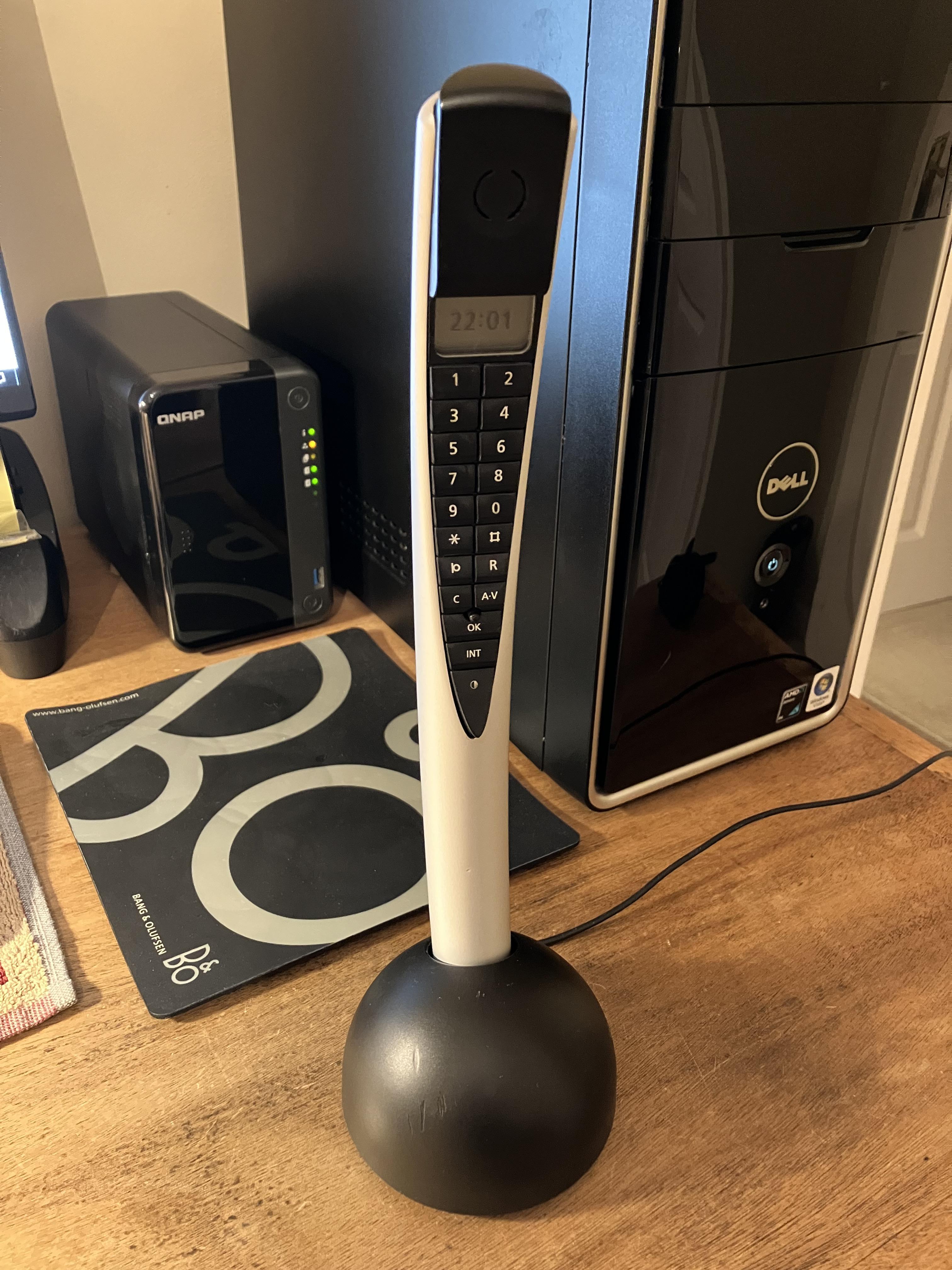

The ‘new to me’ Beocom 2 was a very scruffy, scratched white version with very faded buttons and scratches on the screen surround, but I was pleased to see that it is the newer Mk2 version (see here for differences). I changed the battery and it burst into life and worked perfectly, including full compatibility with my Beoline base! I therefore stripped it down and put the innards in the silver ‘better condition’ case. I also swapped over the keypad buttons and screen surround, and now have a quite presentable fully working BeoCom 2 Mk2: (it looks white in the picture but is the silver one)

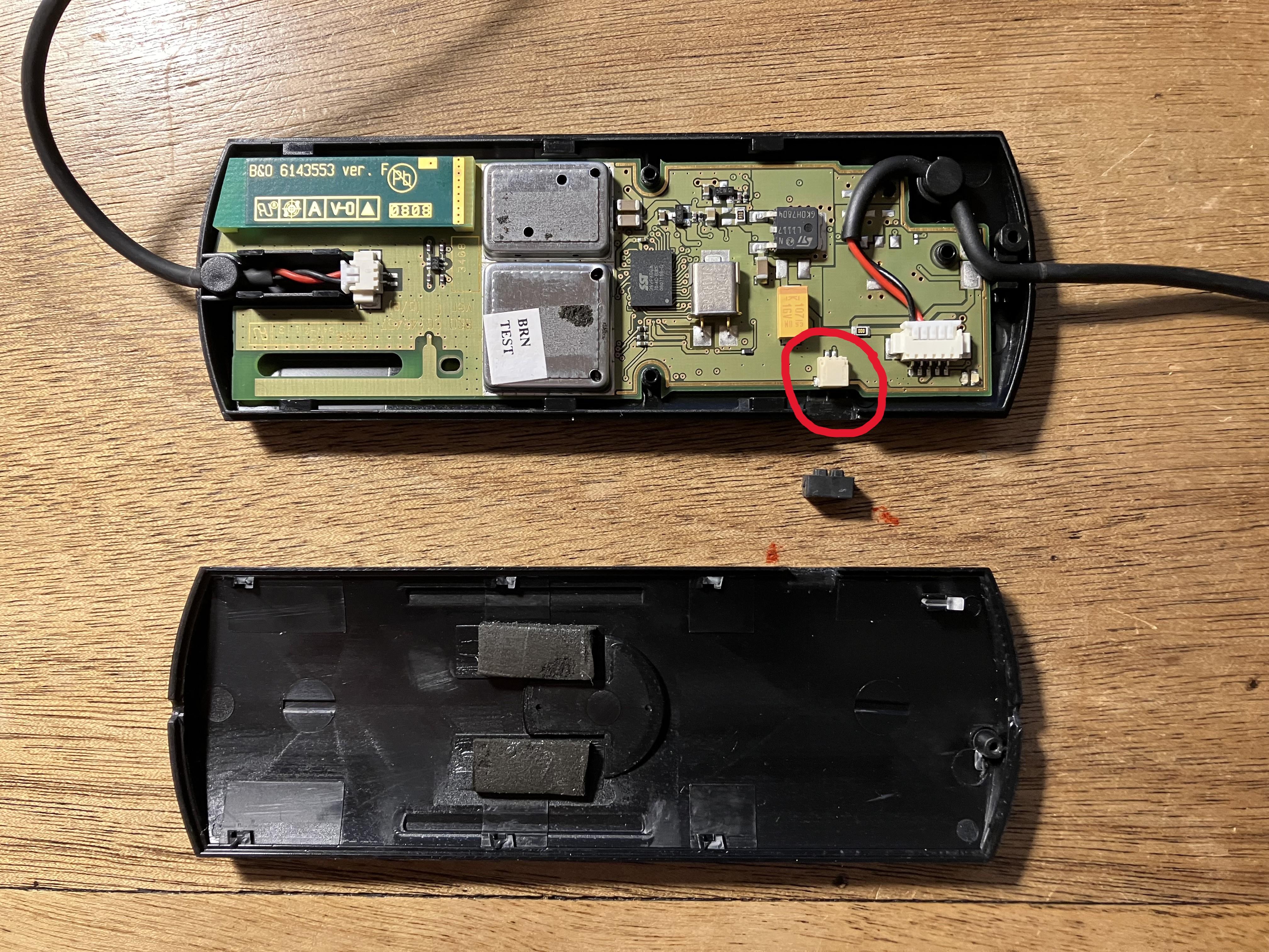

I then turned to the Beoline – when connected to the mains the light didn’t even come on so I suspected a power problem. The plug-in adaptor was a sealed unit so I took apart the Beoline itself to check for power at that end. There was one small screw to undo and then it prised apart – I managed to break every clip in the process so I will have to glue it back together but never mind! Here’s it disassembled, and for interest I have circled in red a little port that is usually covered by the little rubber blank that you can also see; I assume this hidden connection if for dealers to carry out SW updates etc.

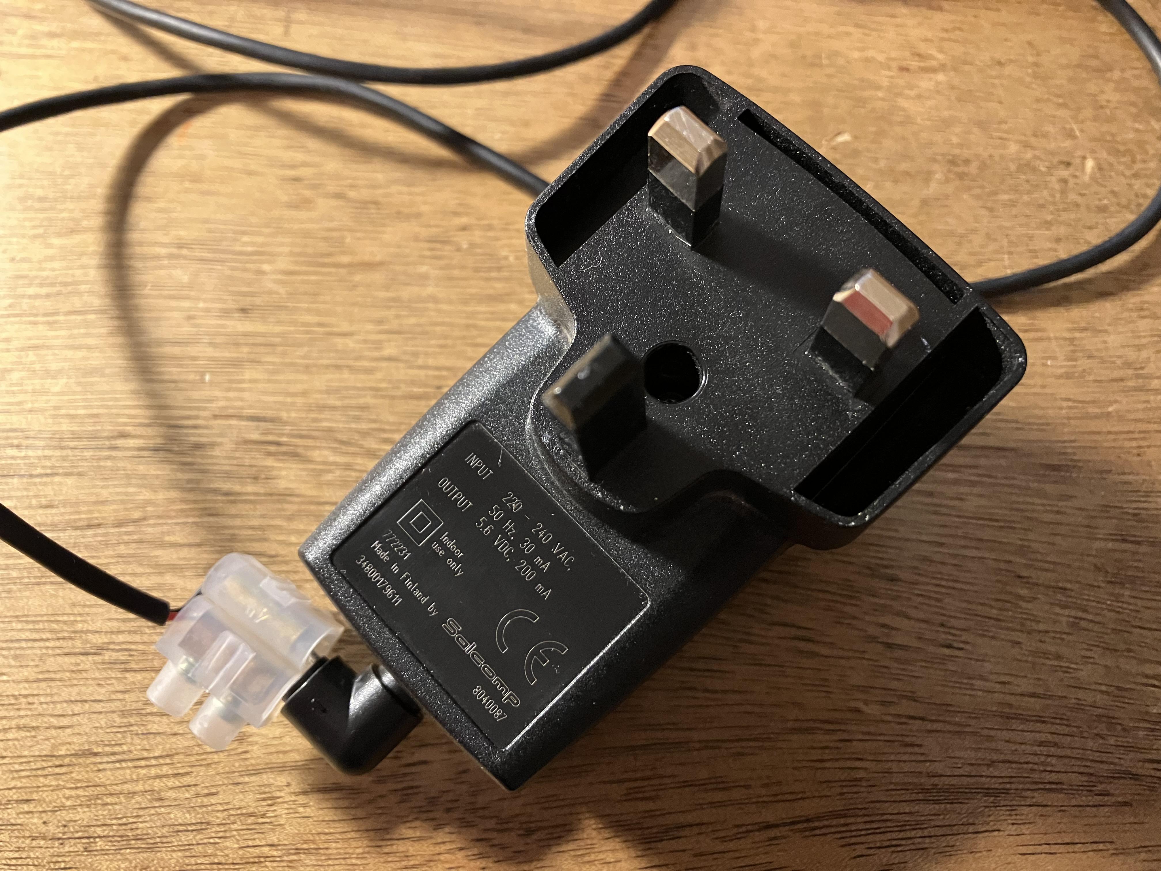

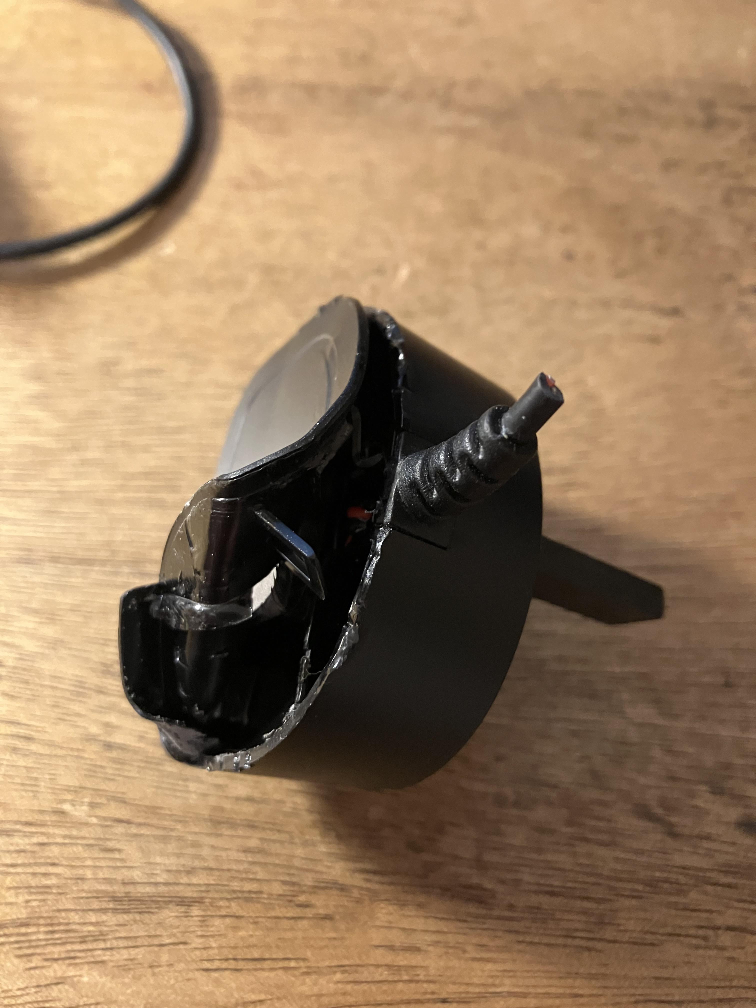

Anyway there was no power getting to the Beoline, so first I attempted to dismantle the PSU using a selection of destructive tools …
But as expected that was an impossible task, so I cut the cable, found a 5.5V BC6000 charger PSU and bodged a quick connection to test the Beoline:
I connected the Beoline to my phone line, powered it up, registered the Beocom 2 and it works perfectly!
