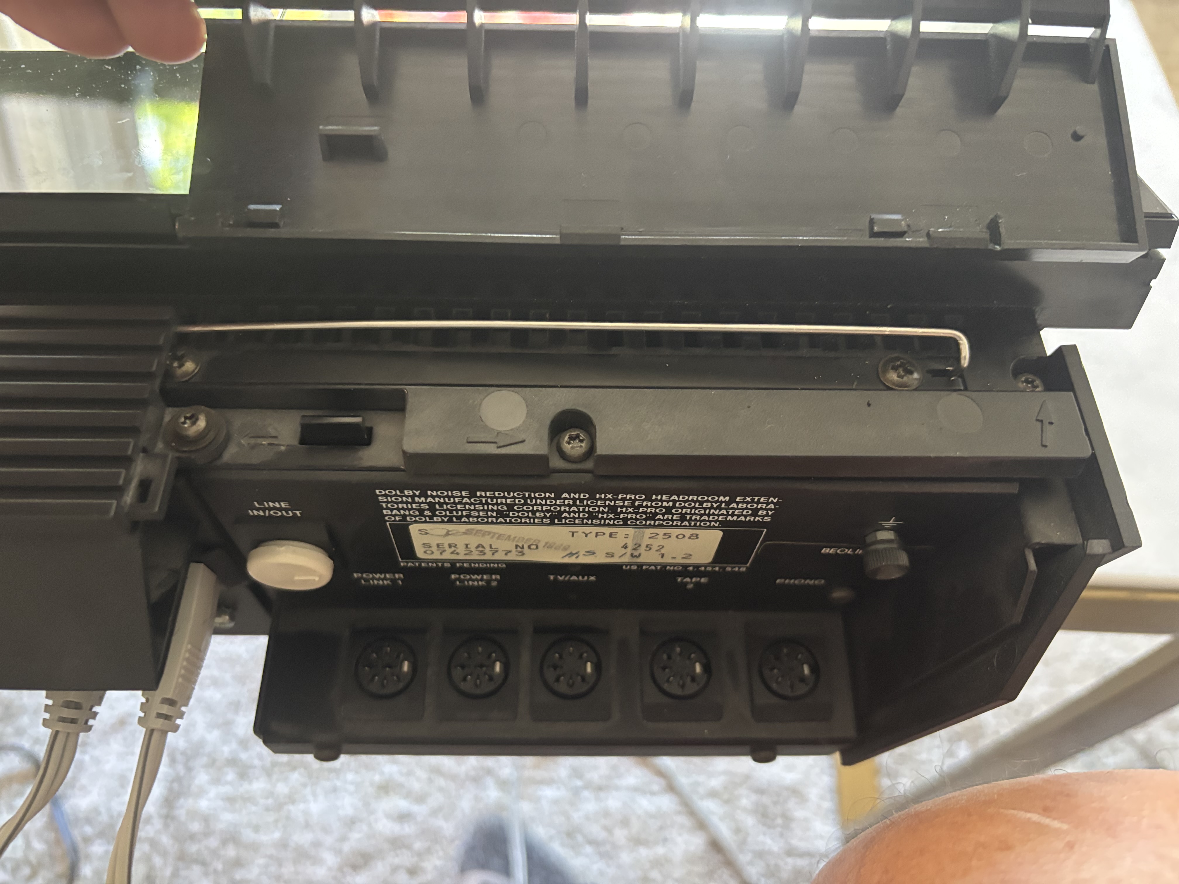

    I’m having a problem attaching this little flip up door on the wire. Is there a trick. I can’t seem to push the wire into the track on the door??

    Yes, this is indeed very tricky. The aging plastic also makes it a bit of a nail-biter as the piece is likely to shatter. I think I’ve tried using plastic spudgers (thin tools) to force the bar into place, but I’ve been curious if should be done at a more invovled stage of disassembly with the metal bar already attached to the door, and then the whole unit inserted into the back.

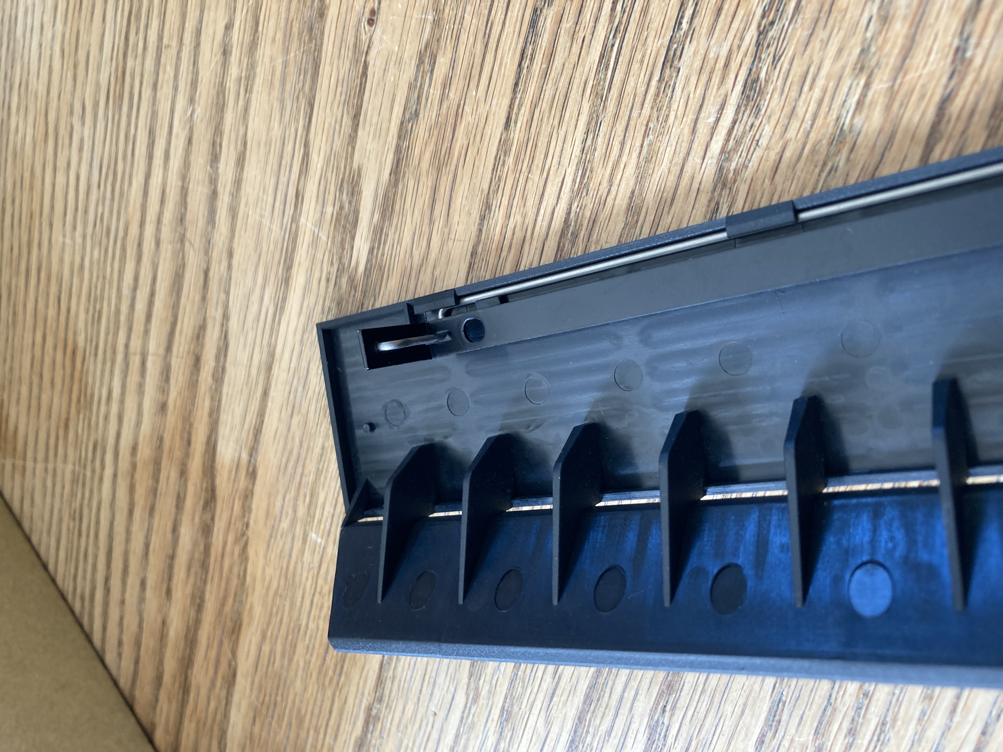

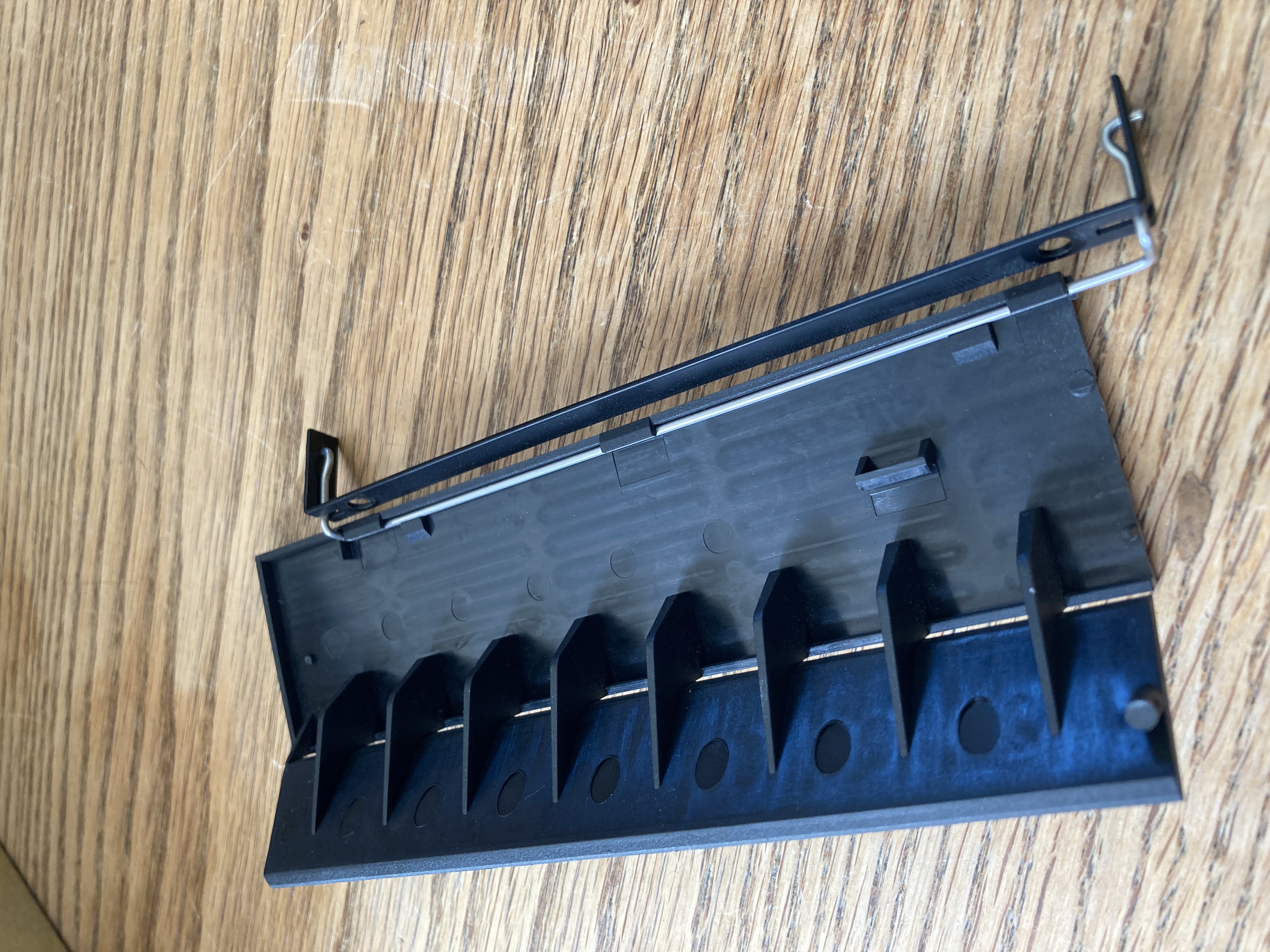

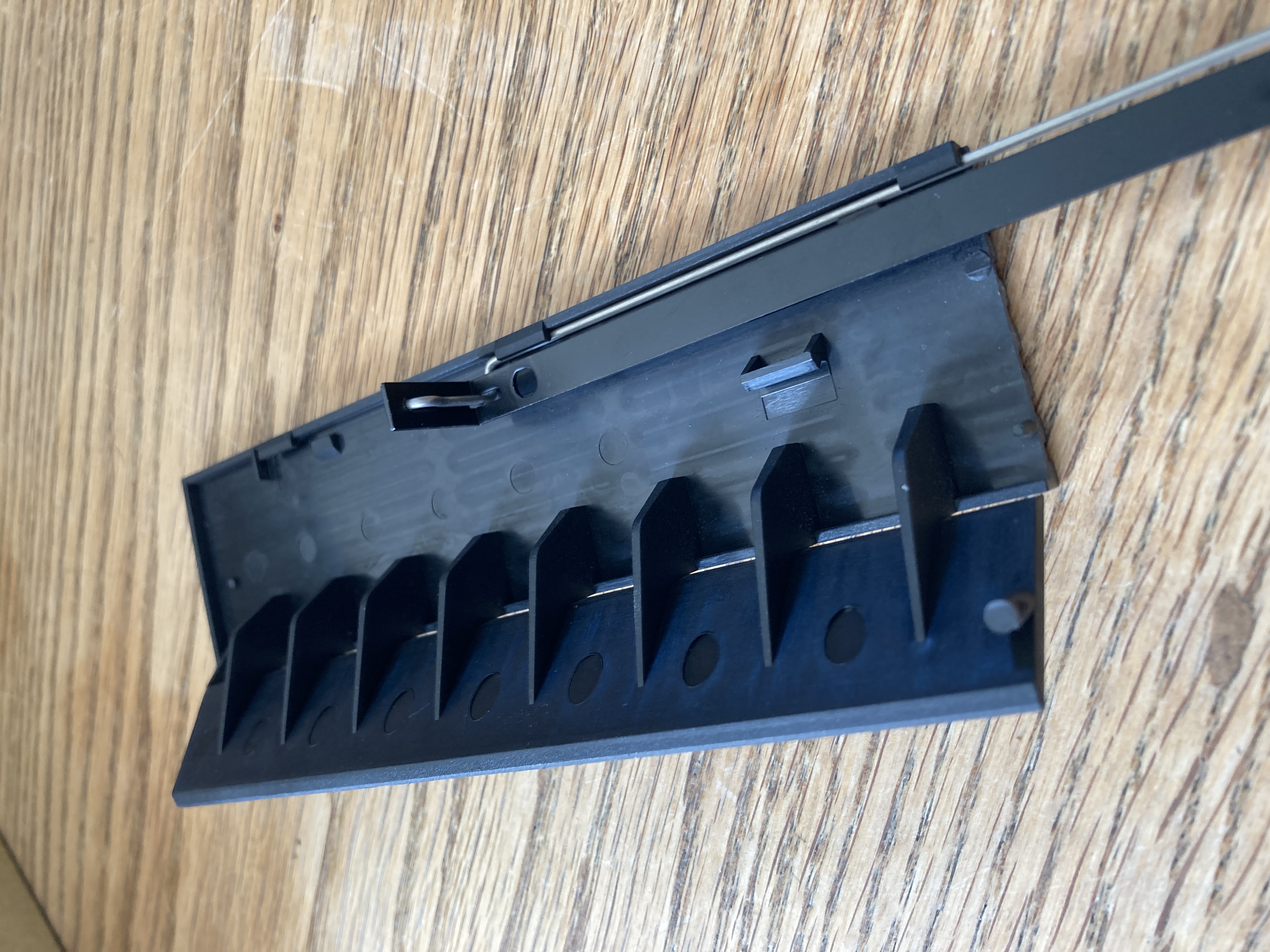

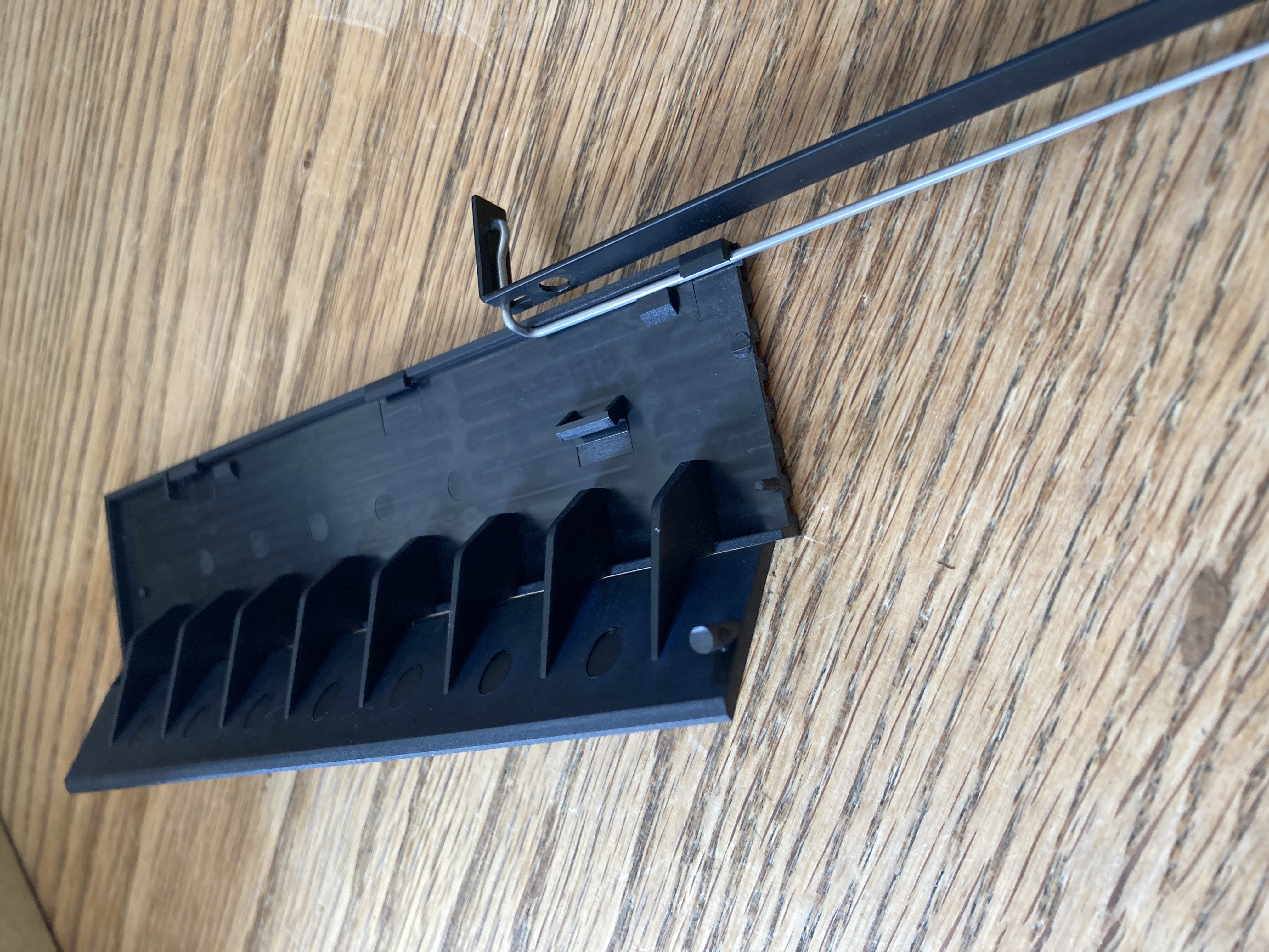

    Take out the metal bar (two screws).
    Insert from one end, rotate and slide further, rotate again and slide etc.
