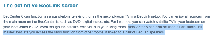

On the Beoworld product page https://www.beoworld.org/prod_details.asp?pid=740it is describes as the the BC6 can function as an audiomaster.
However that does not makes much sense to me if that should be the case as this would not allow for another audio master in the system.

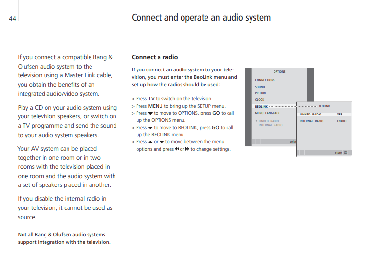

The reference book show that it is possible to enable or disable the built in radio, but also to choose something called linked radio whatever that means?

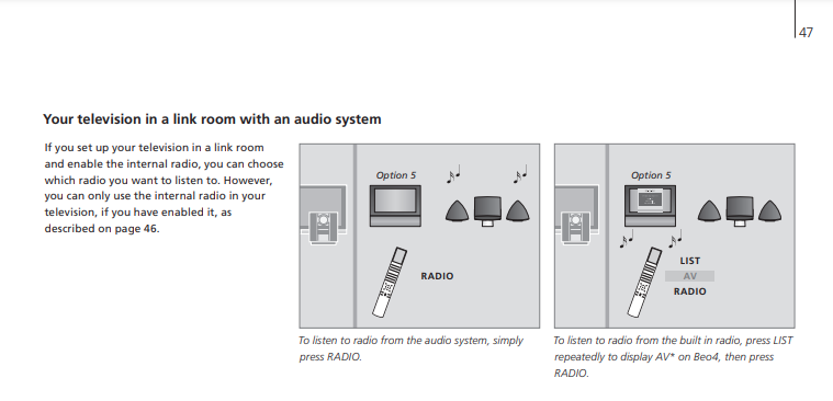

Also the reference book has this setup described where the BC6 is placed in a link room with a Audiosystem, and it is possible to select the radio on either the BC6 or the audiosystem.
However not that clear if that also applies if the BC6 is setup as a video master?

When an FM or DAB radio is fitted to a BC6-23 which it was if purchased in the UK, then if you press “Radio” on the remote it would play using the audio master via the masterlink. If you wanted to play the radio fitted in the BC6-23, then you use “LINK” found in the “LIST” followed by “Radio”
