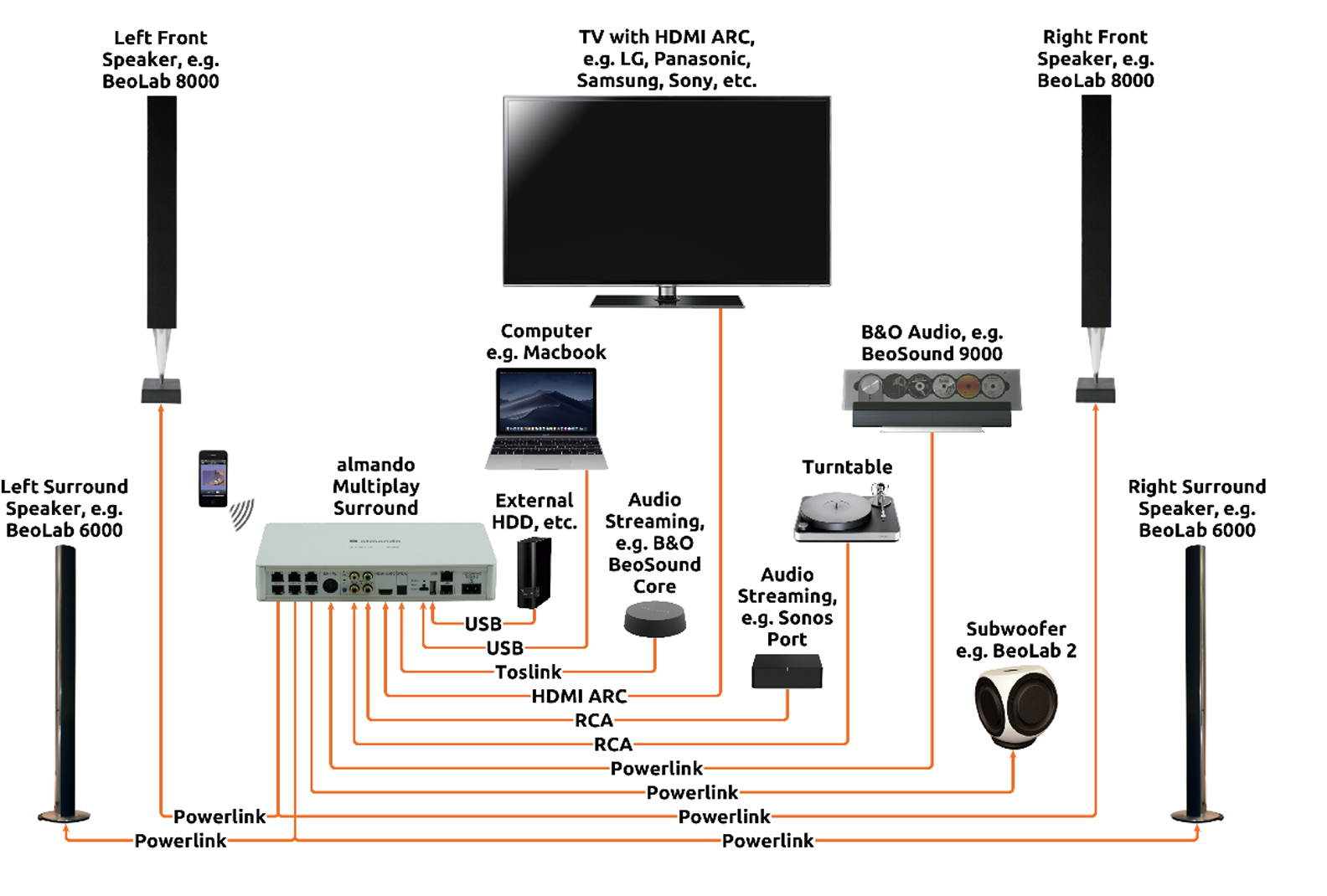

    Almando provide a solution to replace the Beosystem 3 and 4 if needed.
    https://www.google.com/url?sa=t&source=web&rct=j&opi=89978449&url=https://almando.com/%3Flang%3Deng&ved=2ahUKEwjMpOu574OLAxVT4zgGHYTtDTIQFnoECBEQAQ&usg=AOvVaw1zpmOQlQT6oHcKni_dV7qz
    There is a retailer in Melbourne that has already utilised an Almando Decoder (Version 1 without Wireless and Version 2 with). This multi-play decoder box is recognised in Europe for integrating B&O Audio and Video with non-B&O TVs etc. Their website (hopefully you are able to access the link) also provides the essential custom cables and converter adaptors.
    This would provide a significant part of the solution for most. In my use case I still need to be confident that there is local expertise for the final 20% which is for me, the Almando box providing the triggers to switch over to the Projector in its Lift that drops down and the Stewart Filmscreen screen. My search continues ….
    Almando Solution

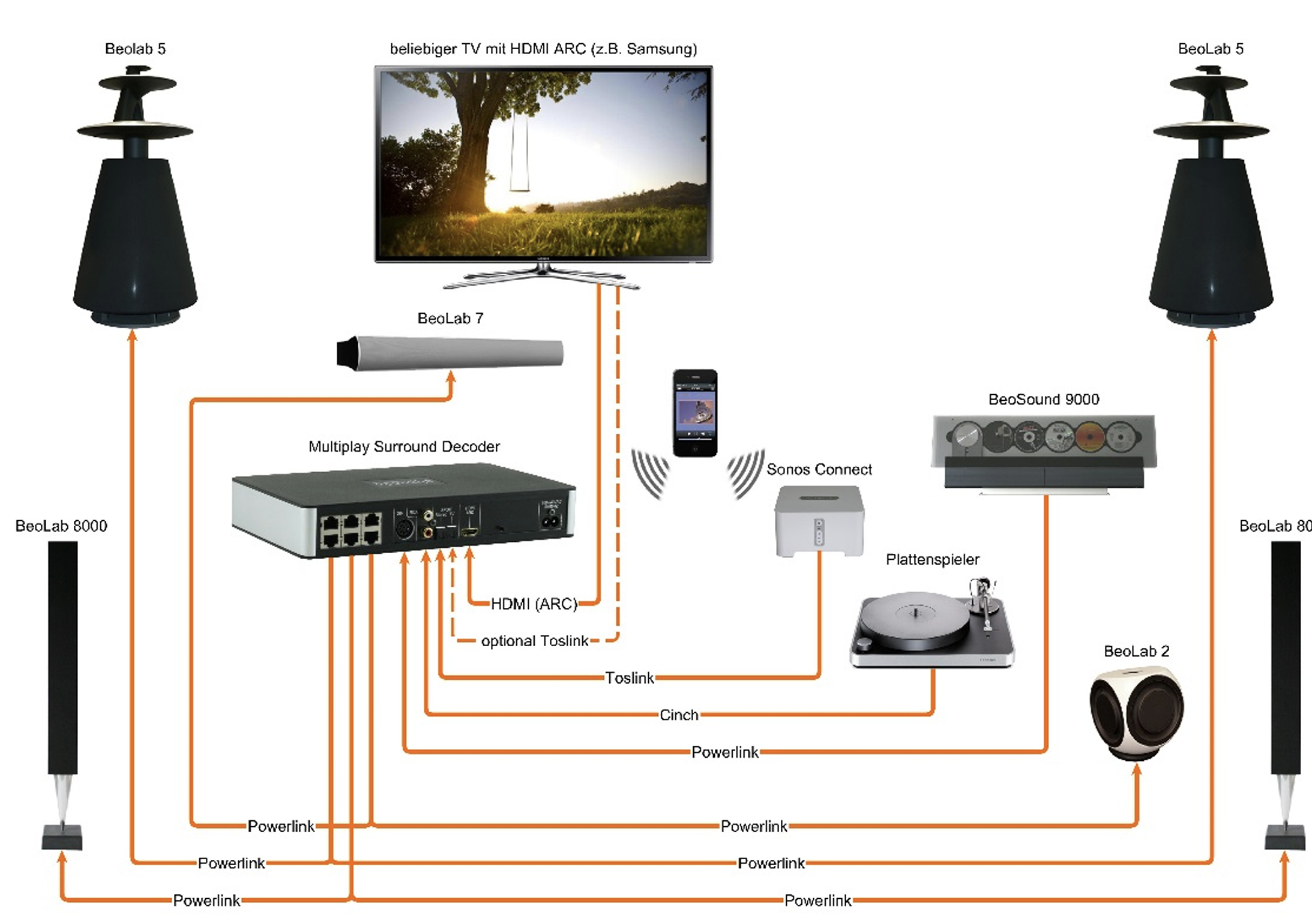

    #62908
    Jakes
    Hello Pepps and Noursbear,
    Thank you for reading my post and responding.
    Here is where I have got to.
    Almando Solution
    #62909
    Jakes
    Another visualisation of Almando decoders being the centre of the B&O and Non-B&O ecosystems integration.

    Jakes, great find with the Almando people. It certainly looks to cover off your main concerns. Mine too, I noticed there’s a setting to send data (for displays I assume) to Penta speakers which is cool.
    Also to be able to connect my BS6500 too is fantastic!

    Millemis
    The Almando products have been discussed here several times throughout the years.
    There are mixed reviews….often people returns to a B&O solution (the BS Theatre) after a while.
    I would advice to wait for posts with positive reviews for Almando, before purchasing – in the meantime you could search the forums including the old ones.
