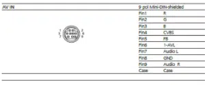

I do have one question – I like a bit or retro gaming and I would like to connect my old Nintendo GameCube to it.  I have a S-VHS cable for the GameCube but found that it does not fit into the little round AV socket on the BV11.  Could anyone tell me what kind of plug that AV socket takes?
It’s a mini DIN 9-pin connector.  Sounds Heavenly sell a cable but that may just be for audio input – worth checking with Steve.
EDIT:  From the service manual:
