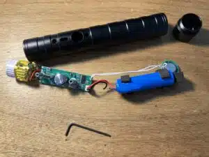

But first I had to have a quick look at my grandson’s Lightsabre – no prizes for guessing what was wrong with it …
