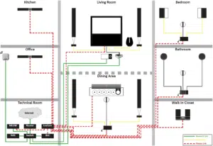

Hello Guy! Well, I do have both Audio/Video master on the ML side. As a refresh, you might remember this thread in the old forum which helped me out to get the Beosystem 6500 linked to my ML-network. While the BS6500 system isn’t on the below diagram, it’s the BL3500 in my office that I want to re-connect via a BLC to be able to play audio sources regardless what is being played on the ML-network.
Next what wanted to try out if it’s then possible to join the BL3500-BLC to an existing multi-room device such as Beosound Level. This is seconday, so for now first problem to solve if it’s possible to get the BL-3500 to play. But, I hope that the above diagram and previous thread gives a bit of insight of how the system is setup.
[Edit Update]
[EDIT Update#1] I currently have the following BLC active in the network were BLC-BV10 acts as A-Master:
  1. BLC-BV10: 1st BLC (ML Role: A-Master) device used to connect the Beosound Moment with BV10.
  2. BLC-Bs6: 2nd BLC added to get the Beosystem 6500 connected to the ML-network via Beolink 1611.
  3. BLC-BS9: 3rd BLC (ML Role: A-Slave) to connect the Beosound 9000 to avoid having two A-Masters.
  4. BLC-BL3: 4th BLC (ML Role: A-Slave) to be used for the BL3500.
