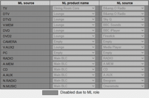

I don’t have any IR-eyes connected to the BLCs.
I tried ASLAVE and got this
and this for the IR mapping.
Nothing linked at all. I modified the TX mapping to what it should be from the other BLC and still nothing worked. So I reverted to VMASTER and all the NL sources could bplayed.
If I play a source  from the Core and then via the App change what the core is playing to a BM7000 source that then plays on the Overture, with the only drawback that it is then audible on the speaker attached to the Core. So I can achieve what I need via this workaround.
