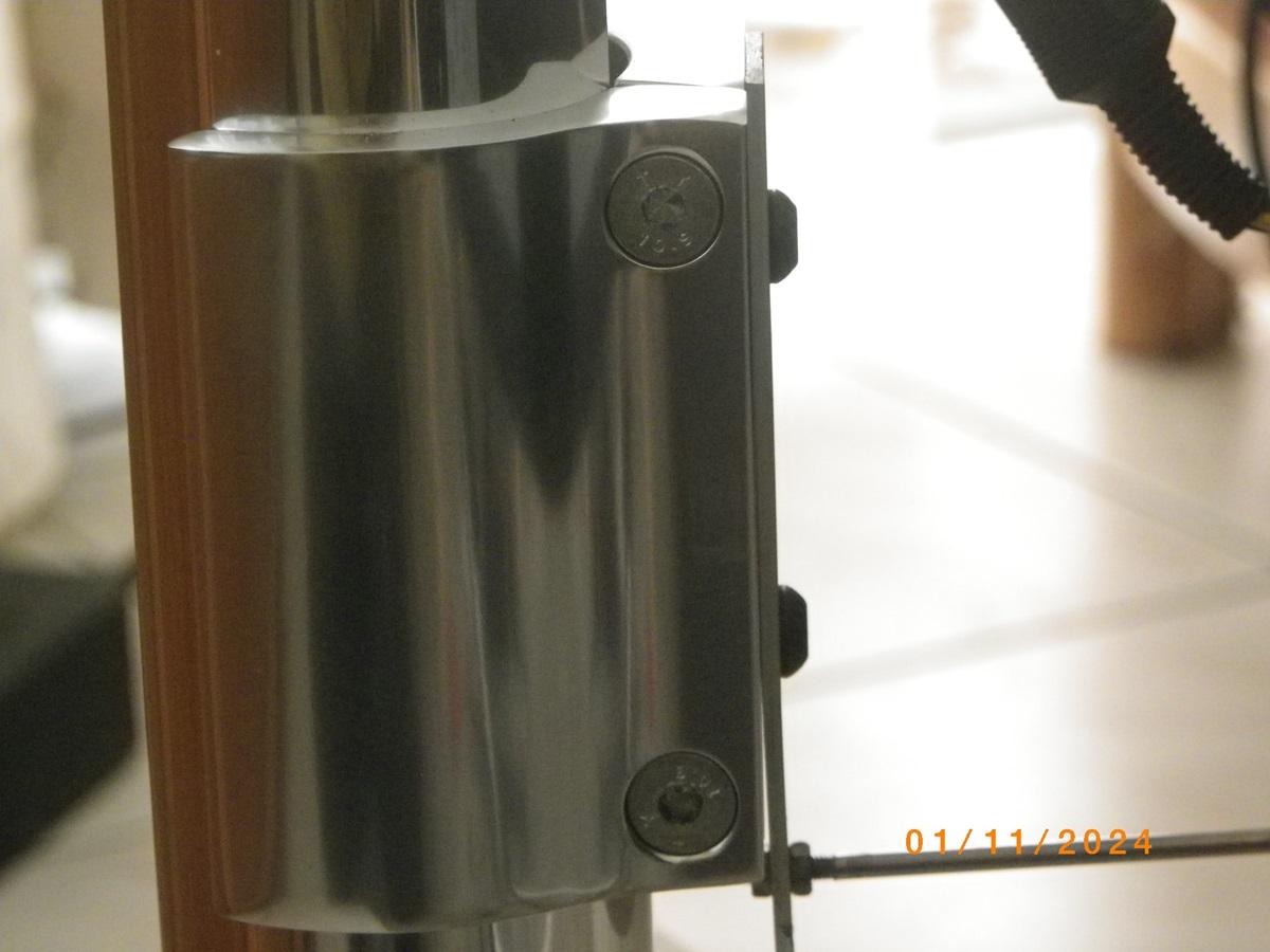

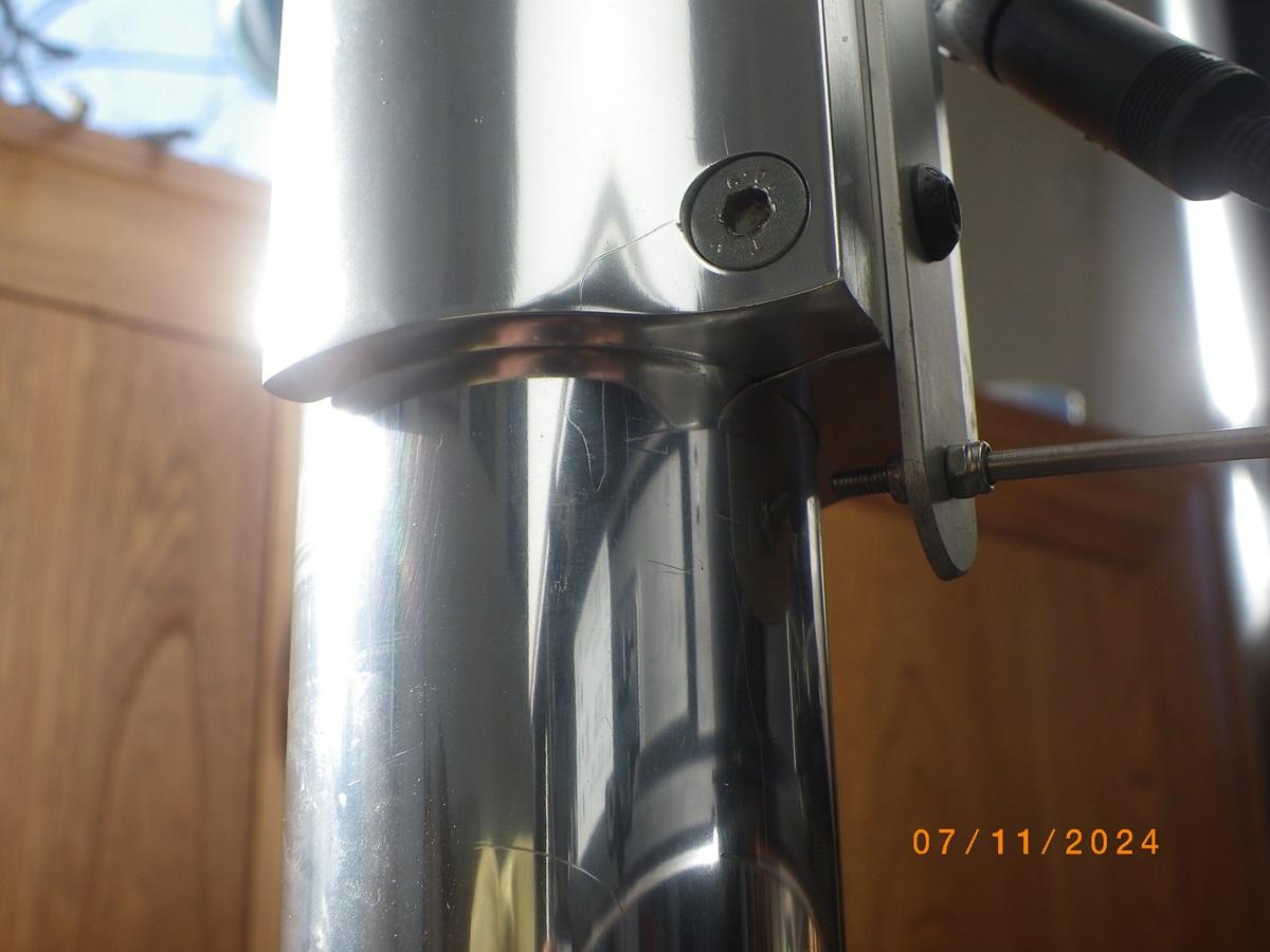

    Ok, got it, thanks, I’ll look at the manual later, currently working on a piece to hold a bv 10-32 at an angle when using a BV 6 / 7 wall mount! See elsewhere on the forum.
