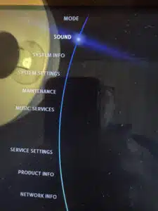

    Hi Guy, Hi Tignum,
    Voila 🙂
    It works with a resistor between pins 2 and 4 of the PowerLink cable as described in the thread above.
    The Sound menu now appears.
    Thank you very much for your time and effort in helping with my question.
    Best regards
    Peter
