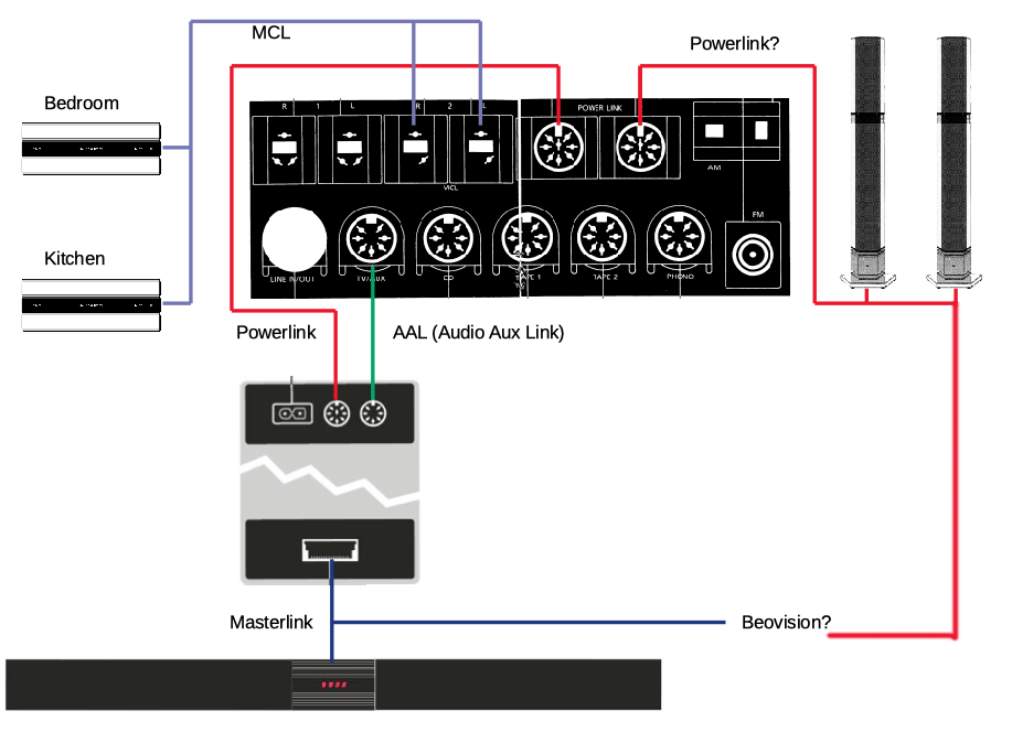

    Sound from the rooms downstairs (Penta, 4500, CX); all on or off, can only be controlled from the main rom, i.e. the Beomaster ‘s line of sight. The Pentas stay green after the Beomaster is turned off. The BV7 has sound. The 3500 stays silent; when I press RADIO – or anything else  – on the remote, its display says TV, then RADIO (or whatever I have tried to activate), but makes no sound. Struer has promised to look into their spare part supplies.

    It makes me a little worried if your Penta’s are connected to both the BM7000 and the BV7 with Powerlink. This could potentially make issues. Has it always been like that?
    If the BV and the BM7000 is in the same room best practice is to connect the Penta’s to the BV7 and let the music from the BM7000 be played though the TV.

    I took your advice and started over. I have now disconnected the power link from the converter. The AUX on that is connected to the BM. The other powerlink from the BM runs to one Penta, which is then connected to the other Penta. That works. To get sound from the BV in the Pentas, I connected it to the the first Penta, and that worked too! Does this sound all right to you?
    I even have sound in the 3500, and can turn that off and on and change the volume. But I can’t turn the system on from any of the three linkrooms. The light control has not worked for a long time, but I guess those wear out.
    Sometimes (!) I can turn the sound off once or twice on the two linkrooms downstairs, and change the volume on the passive speakers in the kitchen. For some reason that I do not understand, this works sometimes, but not always.
    Well, that is the situation today. Let’s see what tomorrow brings!
