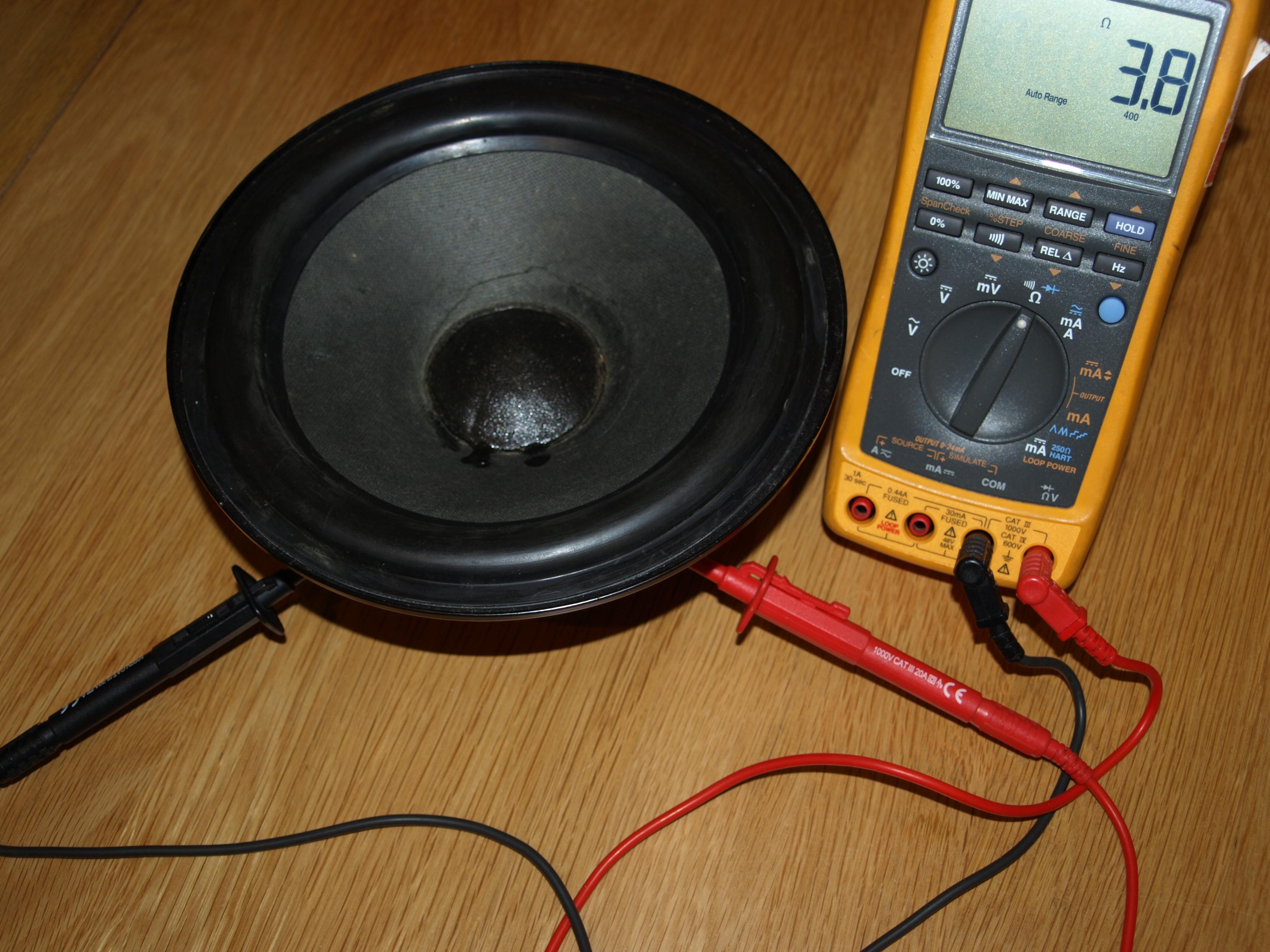

SILVER MemberJust needs to be left as the epoxy hardens, the dust cap glued back in place and posting back home…..I don’t know if there is a better way to do this……

BRONZE MemberYes the saucepan is simply a convenient diameter to rest the speaker on during removal of the dust cap and drying time of the epoxy, keeps any pressure off the cone and coil.
When I saw the cone in the pot, along with the comment about softening the glue, I was picturing heating the glue on the stove top. I have to say that I’m a bit disappointed that the real answer is less exotic. It seemed like it might have been a opportunity to learn a new technique. LOL.

SILVER MemberAhh…..nothing so adventurous Glitch, tried and tested hair dryer technique. So here is the finished article still giving 3.8 ohms and now moving freely….wont commit this to the postal service today as it will languish in the system all weekend, not good….will send it back Monday morning.
