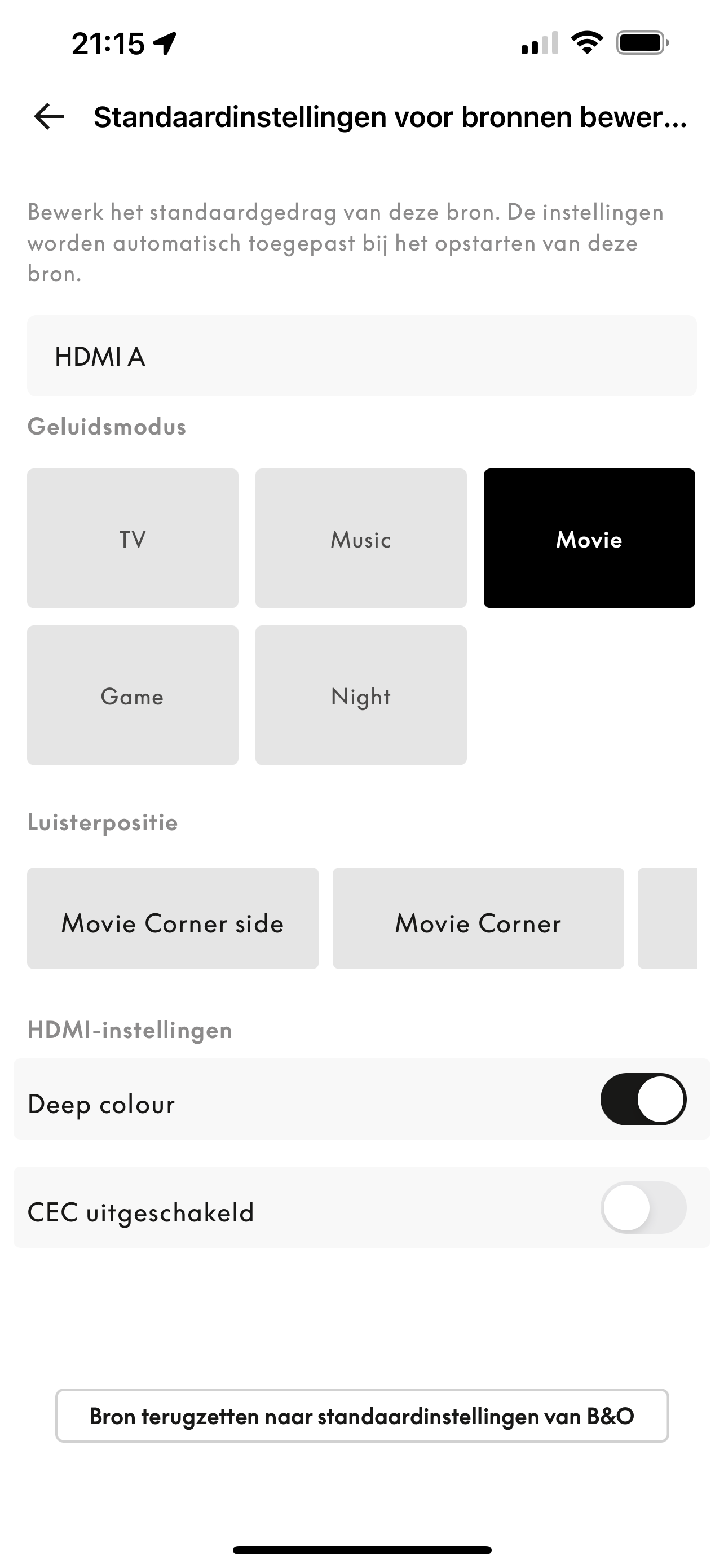

I’m on an older non-beta software.Just to confirm, when you say CEC is set to off in the Beo app do you mean “CEC Disabled” like in my screen grab? Just trying to trouble shoot here 🙂

syrianos82BRONZE MemberNo sorry I deleted that comment.
i find the app confusing. The way you switched it i understand it disables CEC.when you don’t toggle the switch right cec is enabled.
its a double negative sort of thing
19 April 2023 at 22:19 #38288
beomediaBRONZE MemberYes confusing I would agree.
but you have not turned the toggle on hence not disabled CEC?

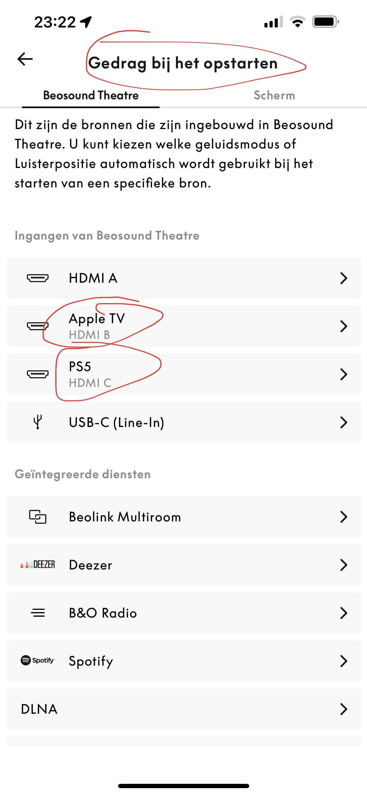

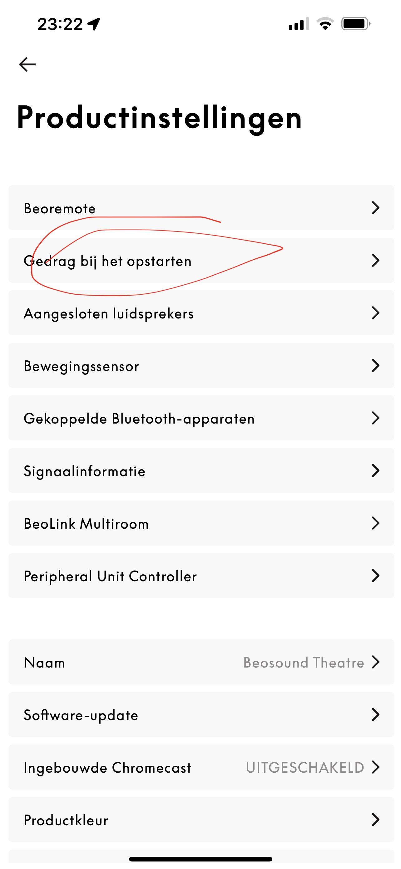

syrianos82BRONZE MemberAlso found the solution for modifying the HDMI name when selecting TV on Br1
The name needs to be changed in a different section of the app. follow the two screenshots since it’s in Dutch
“behavior at startup”
20 April 2023 at 06:14 #38291
beomediaBRONZE MemberI’ve already made these changes but the names I apply are not reflected on the BeoRemote One.
Are the names you have added shown on the BR1?20 April 2023 at 11:21 #38292

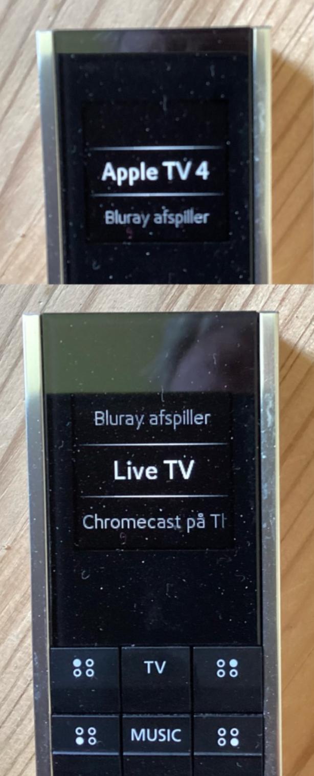

20 April 2023 at 12:44 #38294 Millemis
Please excuse the dust on the remote…..and the bad quality of the photos.
But it shows how my Theatre remote looks – I have only 4 entries there (all that I need).MM
21 April 2023 at 08:51 #38295
beomediaBRONZE MemberThanks millemissen,
are these sources internal LG tv sources or hdmi sources connected to the Theatre?
thanks
21 April 2023 at 12:36 #38296 Millemis
BRONZE MemberThanks millemissen, are these sources internal LG tv sources or hdmi sources connected to the Theatre? thanks
Oh, sorry – they are connected to the Theatre and PUC’ed (except for the Chromecast Ultra dongle, obviously).
The only component of the LG-tv I use is – occasionally – the tuner…..and then the screen, of course.MM
