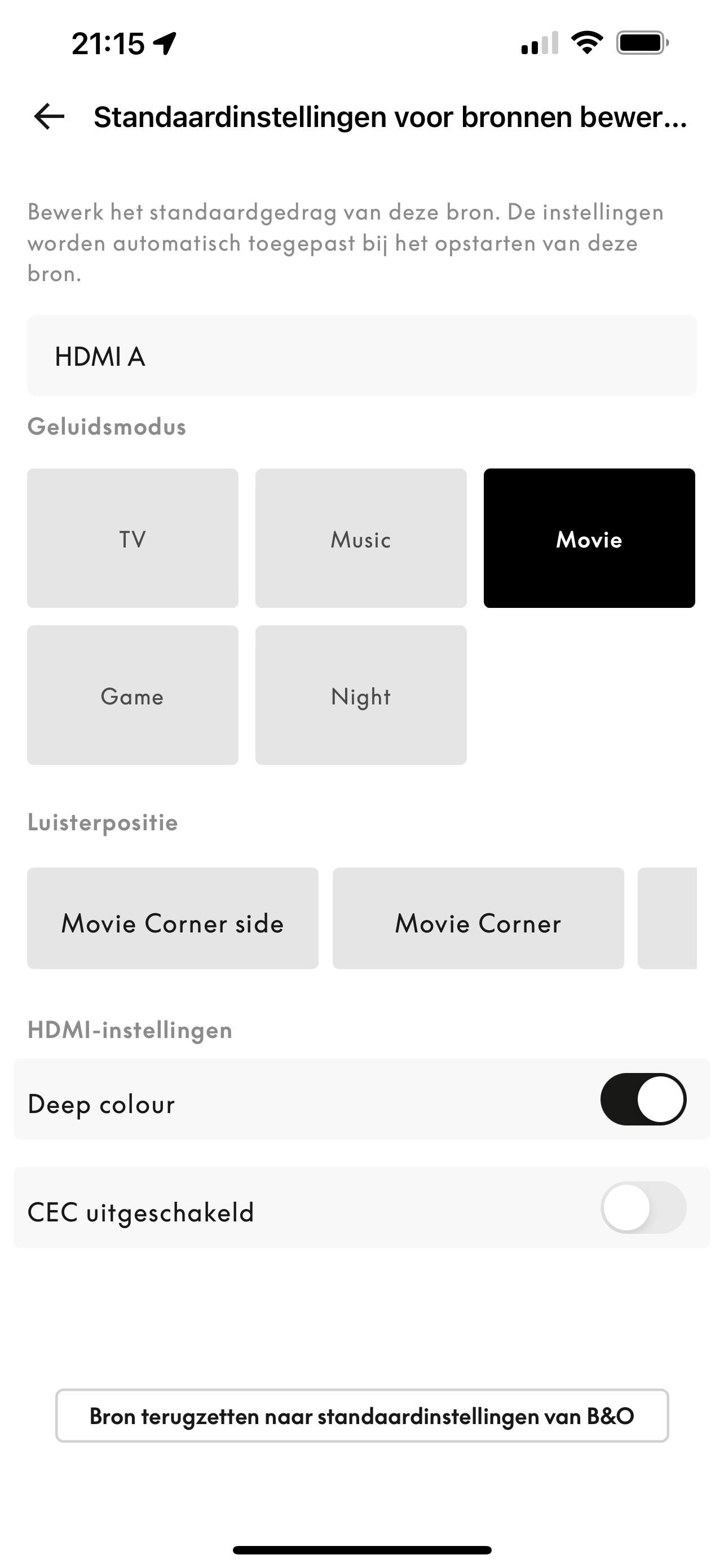

beomediaBRONZE MemberToday I connected my Blu-Ray player to HDMI A of the BeoSound Theatre. I would have assumed I could then control basic functions of the Blu Ray player via CEC but it doesn’t control anything at all.
I know I can connect IR PUC cable but would have thought basic functions via CEC would suffice.What am I missing please? I’ve left “disable CEC” to off in the “source startup behavior” menu.
19 April 2023 at 07:33 #38273
NQVHNWIBRONZE MemberCheck the settings inside your BR-player. The Oppo-105D for instance has a setting to disable and is disabled by default.
You will also see that CEC only covers basic functions and is rather slow/laggy. PUC is much better.

beomediaBRONZE MemberVery late last night I made it work with CEC with the Blu Ray player connected directly to the Theatre.
It wasn’t obvious to me but I connected the Blu Ray to HDMI A on the Theatre. Disabled CEC for this port on the Theatre. Then via the LG menus I set the Blu Ray player up to be controlled via CEC and then I could control it with my BeoRemote One (via the Theatre).
If you do not deactivate CEC in the Theatre it kept jumping out of the setup process on the LG. Incidentally after this process I could control the Blu-ray with my BeoRemote one even with CEC turned off in the Theatre. I have not turned it on again as when I turned off the system the Blu-ray player didn’t turn off.
Controlling the Blu-ray with BeoRemote one worked fine otherwise. Can report back later when I’ve had a chance to test it more but it definitely is possible to control a Blu-ray player connected to the Theatre with the BeoRemote one.19 April 2023 at 13:39 #38278

beomediaBRONZE MemberSo I’ve played with my setup a little more today and the CEC controlling of Blu-ray player connnected directly to the Theatre is absolutely rubbish. In fact it doesn’t work at all.
1) when CEC is not disabled in the Theatre I cannot switch away to other sources once the Blu-ray player is turned on. E.g. when I try to watch live tv while the Blu-ray player is still powered on the tv attempts but is quickly pulled back to the Blu-ray player as a source.
2) when I disable CEC in the theatre I can freely change source to for instance live television.
3) at either approach 1) or 2) I can only control with my BeoRemote after I have started to control the Blu-ray player using the LG remote that came with my CX television. But still after a while of not controlling the Blu-ray player I loose the ability to control it with my BeoRemote one until I again first initiate the controlling with my LG remote.Have any of you experienced this issue and if so is there a solution?
