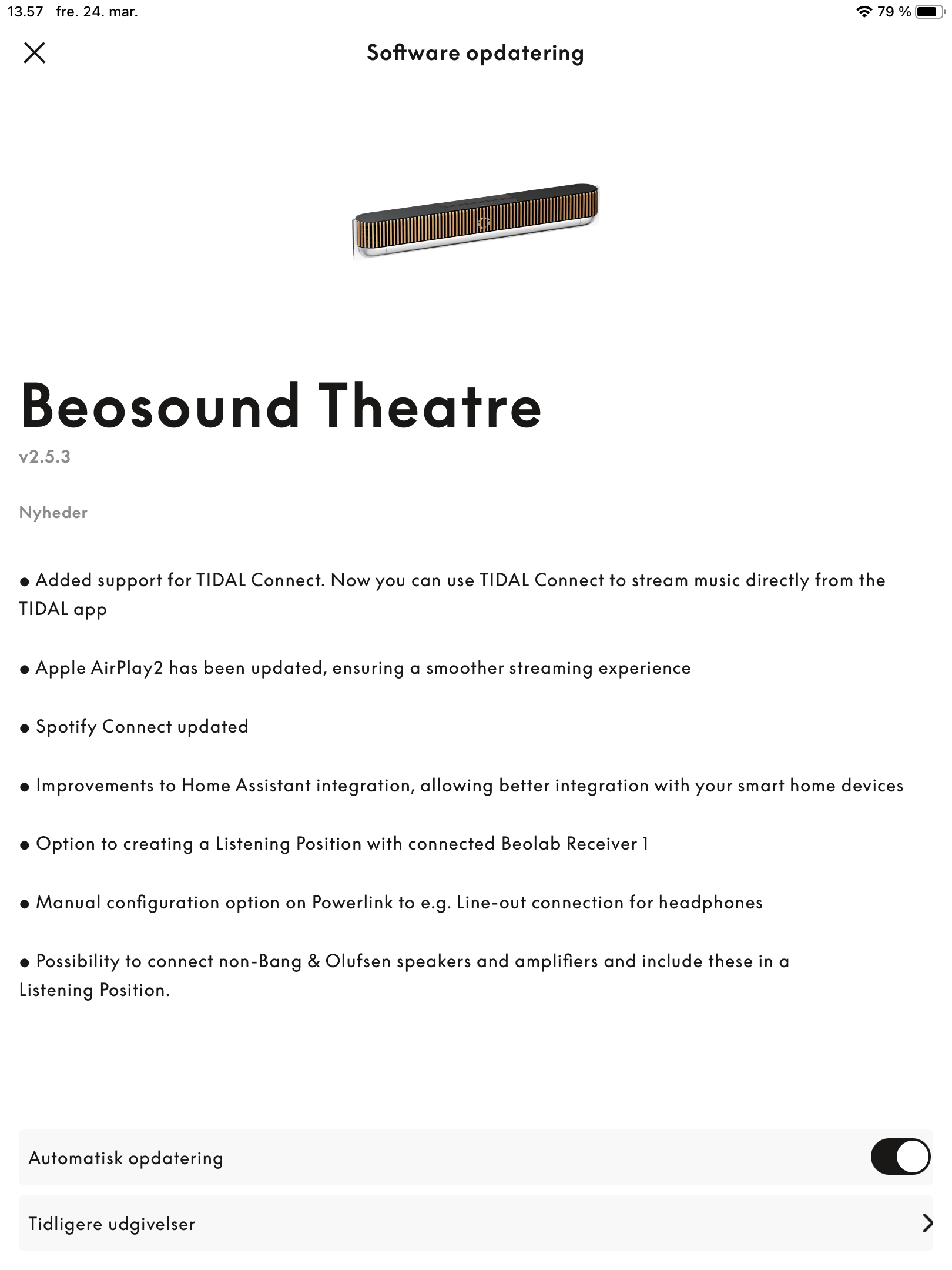

24 March 2023 at 14:57 #38237 Millemis
BRONZE MemberMy BST was updated a couple of days ago (the SW was pushed).
As of today – when opening the app – I was told the it had been regularly/automatic updated……to the same version ?
Anyway…..this time the new features/news were stated in the app (I made a screenshop just in case that could not be found again later on).
Only the new features are listed – no talk of bug fixes.

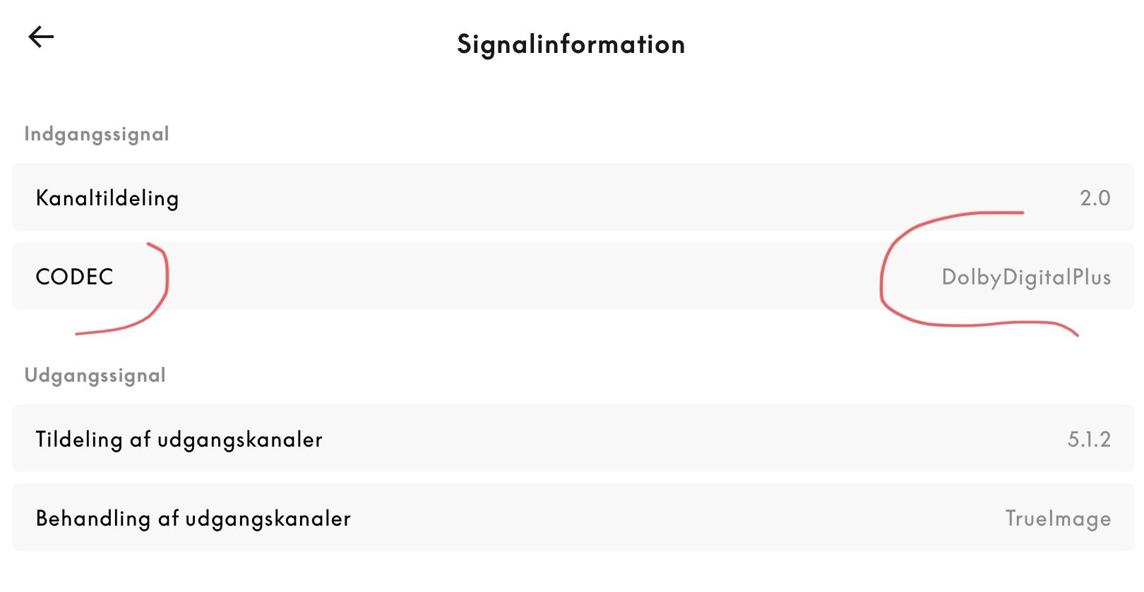

I can’t say whether the issue with the tiny sound from tv (tuner in LG) was fixed, since I generally do not use the BST on it’s own.
I made a test playing from tv with only BST – that sounded ok to me.
I guess testing on an only BST setup and with the new SW will be needed (@Sandyb).This is how it looks in my case, when playing from the LG tuner/DVB-T.
This might be different for other users.
By the way…….changing from eARC to ARC in the LG settings made a difference in the perceived sound on the Theatre alone.
Since I only use the tuner of the LG and no apps, I have mine in the ARC setting now.
